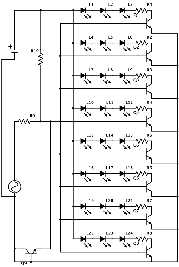

I understand that I will need a number of transistor/resistor/LED circuits in parallel; I had previously figured out that at least for the LEDs, I could have 3 in series before putting them in parallel.
If you excuse the lack of diagramming skill, does this setup look correct, and will the transistor being used as a diode be okay, or will I need to somehow use multiple there as well? newcircuit.png

You have the bases-emitters of all the transistors in parallel which is bad because the transistors probably will not have the same sensitivity unless you are very lucky. The sensitive transistors will light their LEDs but the less sensitive transistors will not. Each transistor needs its own series base resistor for them all to work. Then the transistor used as a diode will be messed up. Use a transistor as a diode for each driver transistor connected at its base.
I do not like your R10 because it might cause all the LEDs to light all the time or cause them to light when the transistors are warm. Try it to see.

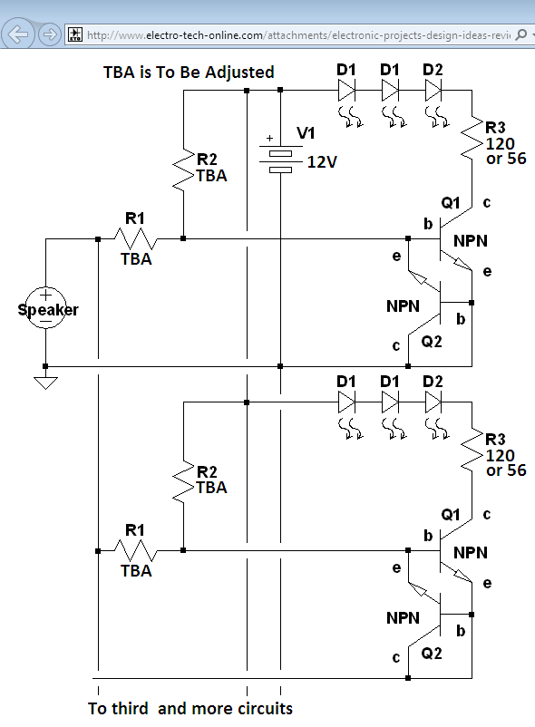

To be clear, I will have to experiment for the R2 value in your diagram, but will R1 be dependent on the music? How should I determine its value?
The value of R1 depends on the output level from your amplifier:
1) 10W into 8 ohms is 12.9V peak so R1 should be (12.9V - 0.7V)/5mA= 2.4k ohms.
2) 100W into 8 ohms is 40V peak so R1 should be (40V - 0.7V)/5mA= about 8.2k ohms.

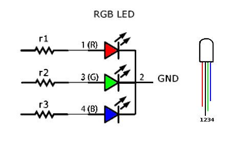

After doing various tests using white LEDs, and preparing the actual speakers, I realised that I forgot something. I started designing the actual layout of the circuits for soldering, however I am going to be using common cathode RGB LEDs31PvQvZBwCL.jpg. The circuit design currently has the resistor plus transistors on the ground, so if they changed, it would affect more than one color. Is there a way to properly move the series resistor to a place where it won't affect multiple colors on a single LED?

Common-cathode LEDs are driven with PNP transistors but your transistors are NPN.
The LEDs in your circuit are shown as series-connected, not common cathode ??
Sorry if I wasn't clear. My setup will have probably 24 RGB LEDs. They will be in sets of 3 because of the 12v power supply. My issue is attaching multiple colors to the power but giving them different current limiting resistors. So, originally I had thought I would use the setup (I copied it into my last post) where two of the circuits are basically in parallel, to use the same power and music source (so on that diagram, the two parallel circuits would be, say, red and blue on the same LED). I hadn't noticed at the time that I wouldn't be able to use a common ground for them.
AG, I understand that I hadn't adequately prepared for this project, however is there any way to modify the current setup without having to get PNP transistors?
Common-cathode LEDs cannot be connected in series and cannot be driven by NPN transistors unless all 3 colors are driven at the same time.
Each common-cathode RGB LED needs three current limiting resistors in series with each color and three PNP driver transistors if the colors are turned on separately. With a supply as high as 12V then the current limiting resistors will get hot and maybe level-shifting must be done so a 5V supply should be used.

You cannot connect common-cathode or common-anode LEDs in series. For your LEDs, each color needs its own series resistor. With a supply as high as 12V then the resistors will get hot and a level-shifting circuit is probably needed so use a 5V supply.
