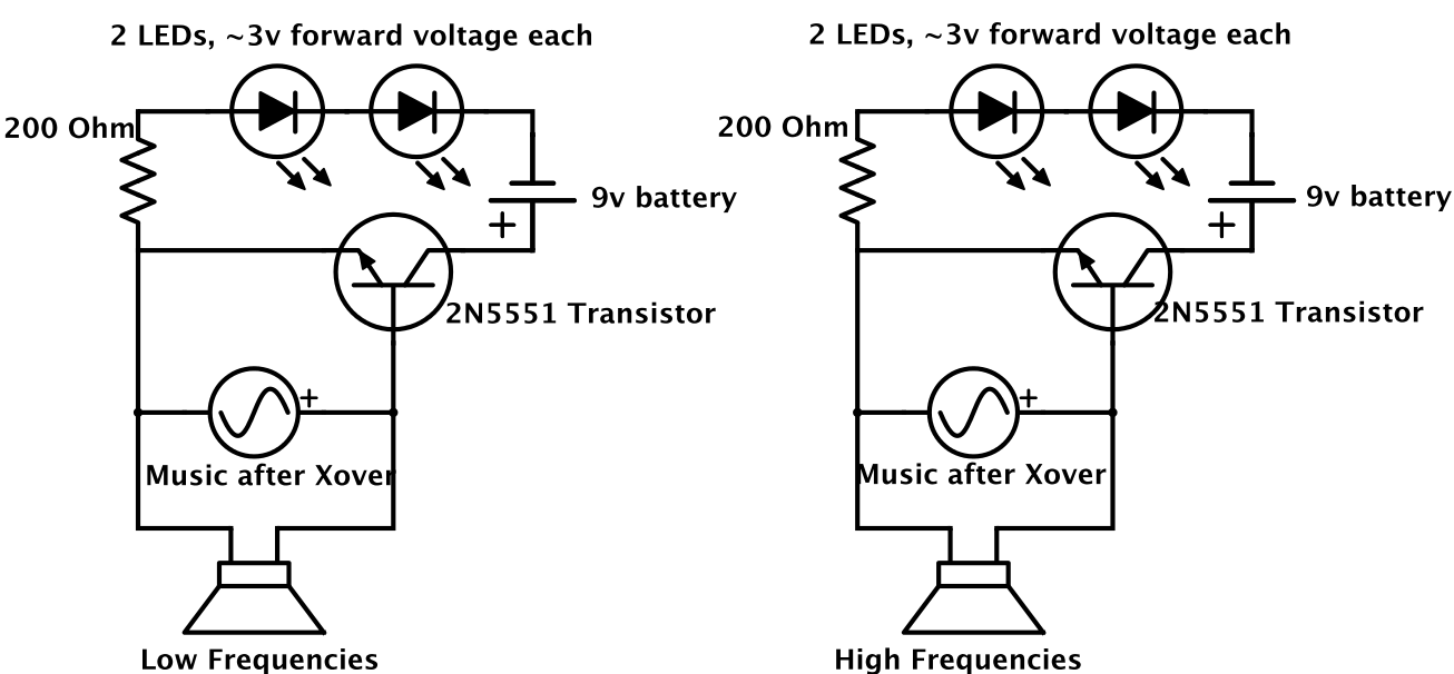

I am attempting to create a circuit using the audio from a receiver to pulse LEDs. Eventually, it will be using RGB LEDs, with red on high frequencies and blue on low, and an old spare computer PSU (which has 12v, 5v, and 3.3v outputs) to power it all. For now, my testing setup is 2 white LEDs plus a 200 ohm resistor attached to a 9v battery and a transistor to the music (see attached schematic).
This current test works (the LEDs pulse with the music), however I have to turn the volume up uncomfortably loud for the low frequency LEDs to start blinking, and even louder for the high frequency ones to do so. I understand why it needs more power before the HF ones work, however I would like them to light at more normal volumes, and equalise the low and highs in terms of LED light.
When I first planned this project, I assumed the transistor+extra power would be enough, and maybe just use larger resistors for the low end than high, however now it seems like I will need to do more. I have read a bunch about Darlington pairs, however I don't seem to grasp how to efficiently make them work (since they have a doubled initial voltage?) without wasting a lot of power or burning out my transistors.

The extremely simple circuit is missing some important details.
Your transistors are connected as "emitter-followers" that have no voltage gain, actually they have some voltage loss. Then they must be driven from the output of a power amp, not from a music source. The two 3V LEDs in series with 200 ohms will light brightly with an output from a transistor of +10V peak and the output from the amplifier must be +10.7V peak.
When the peak signal voltage +10.7V then the power into an 8 ohm speaker is 7.2W RMS.
When the amplifier signal reaches 7.2W then the LED will blink but the signal also swings to -10.7V peak which will damage the transistor that has a max allowed Veb of only 6V. The transistor will break down which might also destroy the power amplifier.
If the circuit is driven from the output of a power amplifier then the transistor and battery are not needed and can be replaced by a diode so that the max negative allowed voltage on the LEDs ((usually 5V each) is not exceeded. The value of the 200 ohm resistor must be calculated with the maximum output voltage from the amplifier.

You caught me :p, this was based on this www.instructables.com/id/Stereo-Speakers-with-Synched-LED-Lighting/?ALLSTEPS instructable. Obviously I have misunderstood what I did learn about electronics online.
Since it is apparent that I don't have much experience in voltage/amperage stuff, is there any way that I can make a working model, even if it is more complicated, with the materials I pointed out above? I don't have any diodes, unless the LEDs count. I definitely don't want to destroy my amplifier or any more transistors!

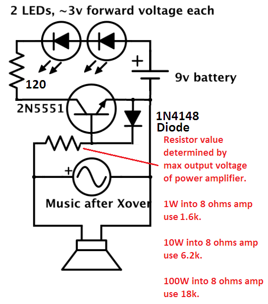

I fixed the horrible very simple circuit so that it has voltage gain and has a base resistor and diode to prevent the amplifier and transistor from blowing up.
The base resistor value must be calculated so that it turns on the transistor properly but that it does not get too hot and blow up the transistor at the max output voltage of the amplifier.
There is no control of the level that turns on the LEDs so the amp volume control is the only level control.
An LED level control can be added to feed the base resistor.

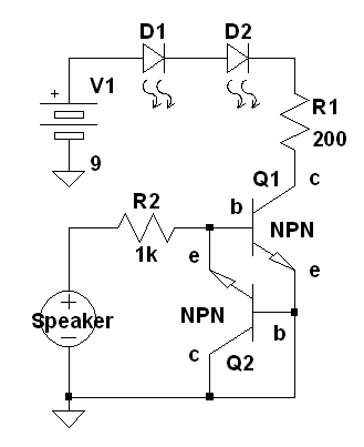

This is like AG's circuit, but uses Q2 configured as a diode (since you don't have any) :-
Thanks so much for the diagrams! Alec, could you possibly explain how your diagram works? I don't exactly understand what Q2 is doing when placed like that.
Q2 in Alec's schematic is used as a diode to conduct and protect the emitter-base of Q1 from exceeding its max allowed reverse voltage of 5V or 6V.

The new design works fine, however it still needs the volume cranked up pretty high before the LEDs light up. I don't need a fancy control deciding how loud I want it before they light up, but is there any way to increase the amplification in this circuit?
You could try reducing the 1k resistor to 330Ω (I wouldn't go lower or you risk passing excess current through the base of Q1).

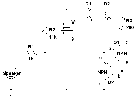

With the limited choice of components you have, here's another way of improving the sensitivity slightly (but as AG points out you really need an opamp to get more amplification):-
You may have to experiment with the value of R2. Something between 10k and 15k should do if R1 = 1k. R2,R1 help the transistor to turn partly on in the absence of audio. A smaller audio signal than 0.7V can then turn the transistor on fully.

That makes a lot of sense, alec! One question to make sure I don't ruin it: The crossing of wires in the middle of the diagram, not touching correct?
Not touching. (Wire joins are marked with a blob; cross-overs aren't).
