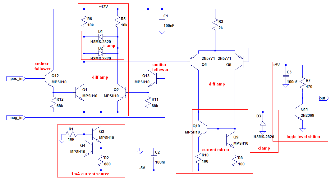

Hey Roff i got around to building the circuit and something isnt working right. Input transistor one gets very warm and regardless of the input state the output is 5 volts ?
Any ideas where i can look to fix the problem ?

What type of transistors did you use? Did you make any assumptions about the pinouts on them?
You wont believe the stupid mistake i made ....lol
I assumed that the transistors are the common EBC pin variety so when i connected it all together nothing worked. Yesterday night it hit me to check everything and look at the data sheets and then i realized they aren't the normal pinout but rather BEC. I will try that today..
Can u please explain the purpose of the diodes ? Also in brief the purpose of the different stages...I recognize the first stage as being a diff amp...

I believe it. That's why I asked the question. Don't feel like the Lone Ranger.

D1 and D2 keep Q1 and Q2 out of saturation (saturation takes time to recover from). They also limit the signal swing into the second diff amp, allow it to fully switch (with large-signal inputs), but minimizing the overdrive recovery time that would be required if they were absent. They add unwanted capacitance, so small-signal Schottkys (with low capacitance) were specified. D3 keeps Q10 out of saturation, and also limits the overdrive recovery time at the base of Q11, by clamping the swing to +0.7/-0.4V.
Overdrive recovery time is a function of the current available to charge and discharge the capacitance of a node, and the voltage over which that node must move before switching occurs.
EDIT: Below is an annotated schematic.
