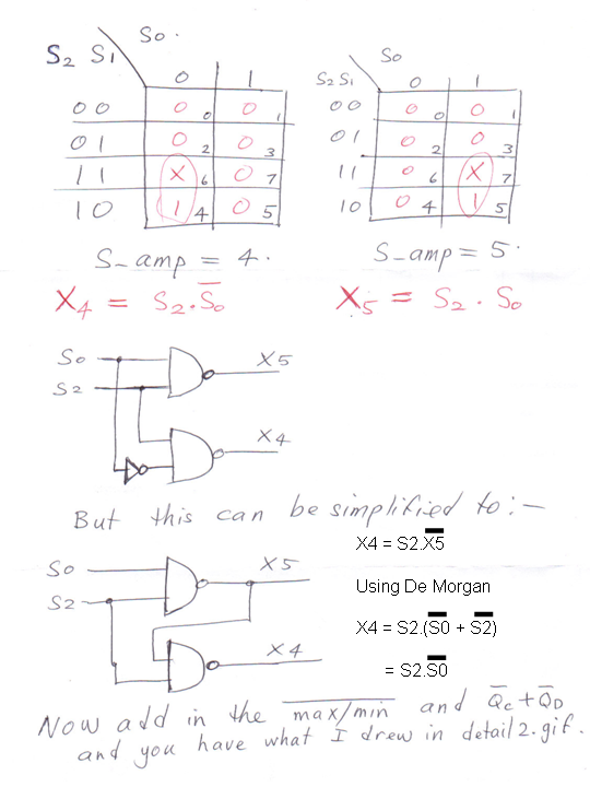

Here are the Karnaugh maps requested by PM

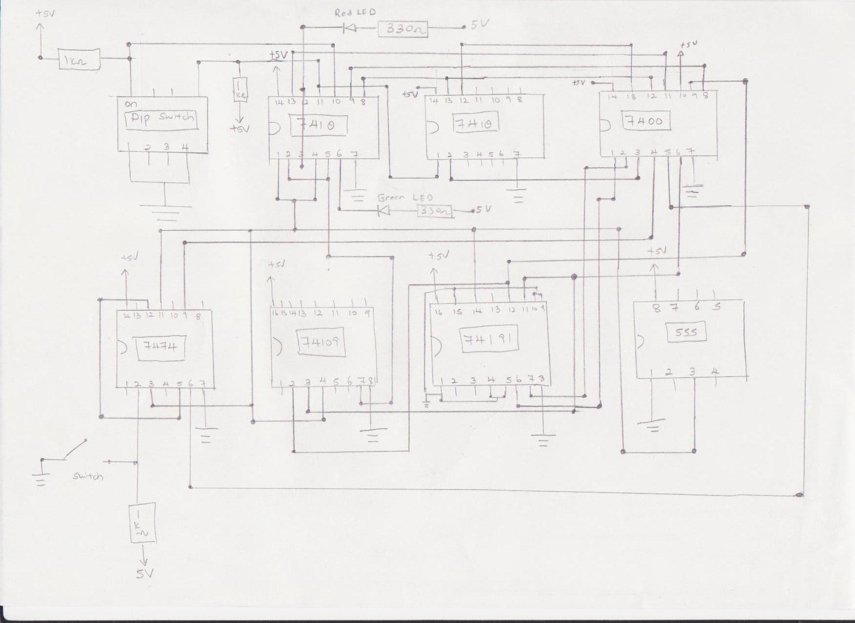

I have redrawn the diagram with the pins layout. Can you advise if there is anythings left out? Please advise. Thanks.

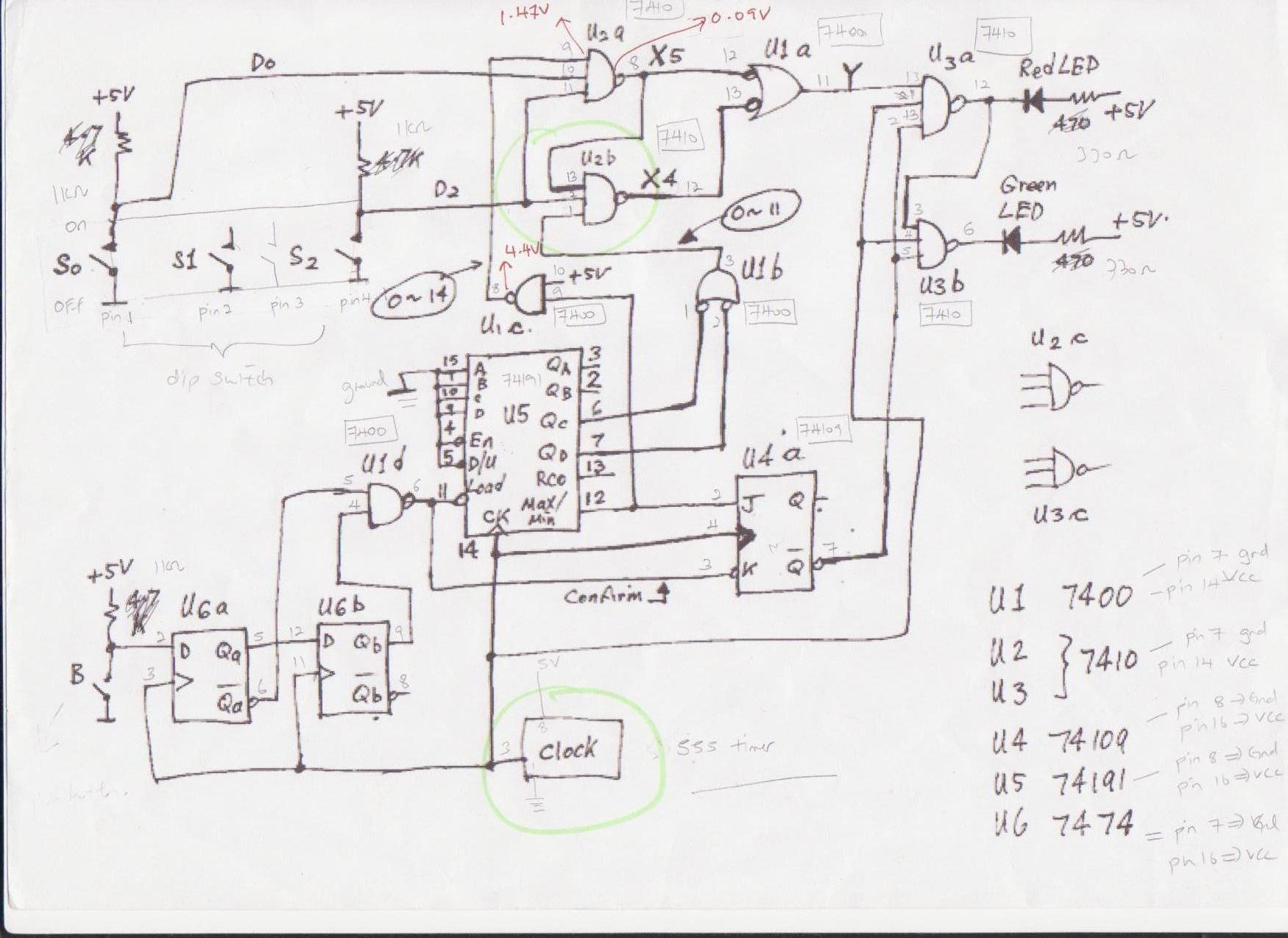

Pin 8 of 7400 is 4.4V and pin 8 of 7410 is 0.09V and pin 9 of 7410 is 1.47V.
Seem like U2a is damage, right?
I have managed to change 74191, but the output still the same. did u see my redrawn ic pin layout, is there any connection wrong with the dip switch. And one thing about your kanaugh map, i was wondering how come you are using nad gate and not and gate?
You did not post your circuit diagram, so I don't know which pin is which.
I assume the output of U1c is pin 8. But I don't know where pin 8 and pin 9 of the 7410 are connected.
Ignore this, I've just noticed your circuit above.
here's the attached
And one thing about your kanaugh map, i was wondering how come you are using nand gate and not and gate?
NAND and NOR gates have advantages over AND and OR gates.
1. Spare ones can be used as inverters.
2. I did the X4 and X5 gating without an inverter because the output of U2a is active low. If I had used AND gates, I would have had to use an inverter to invert D0 as in the Karnaugh map drawing.
shermaine said:
Hi there,
If so, put a gnd on pin 12 of the U5 socket and the red LED should blink.
[Green Led light up] Have you changed ICs U2 and U3, they may have been damaged by the 9 Volt? This is strange given the answers below. Do this again and measure the voltgae on the output of U1c, it should be high since U5/12 is low. If so, measure the other inputs to U2a and the output of U2a.
No! Pin 8 of U1c is connected to pin 9 of U2a, so they should both be at 4.4 Volt. So you may have a bad connection.
Noticed same voltage difference.
hi guys,
i make a mistake. The voltage is same for pin 9 of u2a and pin 8 of u1c. they are 4.4v. As for pin 8 of u2a , it is 0.1v. Guys, is there any thing wrong with the dip switch connection? Please advise. Thanks.i'm making use of pin and pin4 only. is that correct?
