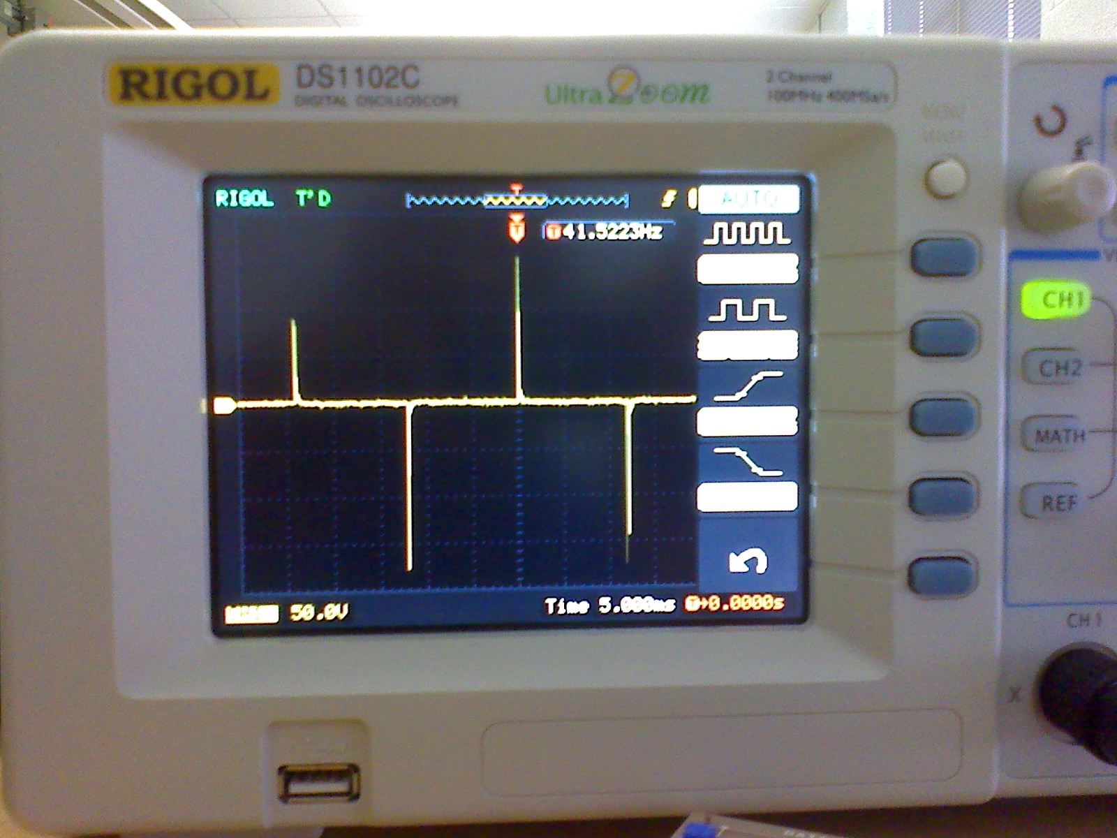

guys i was able to make a little progress. i couldnt get a battery with a rating of 10 amp so i pulled out a power supply from a computer with a current rating of 12V and 8.5 amps which is a little less than required. the output on the transformer now is a pulse at the 100 volt mark there about. is it because the currrent is not sufficient. or what do you guys think the problem is?

1) The circuit is cheap, simple and old-fashioned.
2) A 12V lead-acid battery is 12.0V when it is dead. It is 12.6V to 13.8V when fully charged.
3) Maybe the transformer is cheap with poor voltage regulation so they made it 14V to 120V without a load.
4) The 2N3055 output transistors have a max saturation voltage loss of 3.0V.
Use a 10V-0-10V transformer instead.

If you are getting the proper waveform, then converting to properly rated MOSFETS could give you about 20% increased voltage (assuming your source current is adequate and your transformer can handle it).
well my guess is the transformer i am using is right. i got a power supply that will deliver the expected current. actually it deliver 13amps. i will try it tmor and see what it gives. hopefully it will work if that doesn't i might just have to switch the transformer like audio guru suggested.
