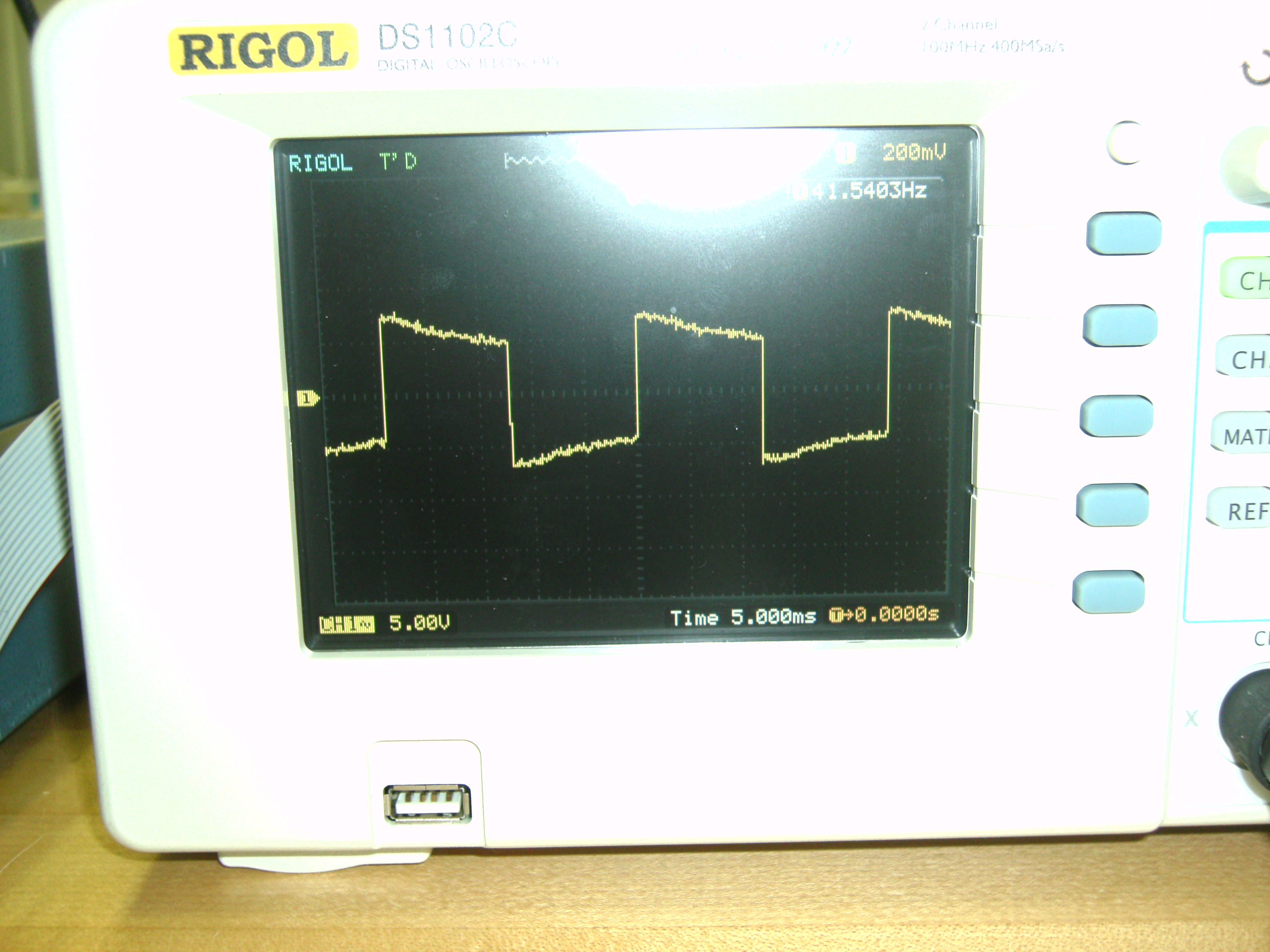

ok/...... i started over circuit construction and this so far is the output from the lm358 op amp at both outputs 1 and 7. it give a square wave but the peak to peak voltage is about 13V. attached is a photo..........
do you have any suggestion for a light load? i just want to show that it works. also what do you think about the output on the op amp and astable vibrator.
the circuit once again is complete but the desired output still cannot be obtained. for some reason, i i basically get the same output 12v approx. across the transformer output. which means in the end there is not boosting on the transformers behalf.
