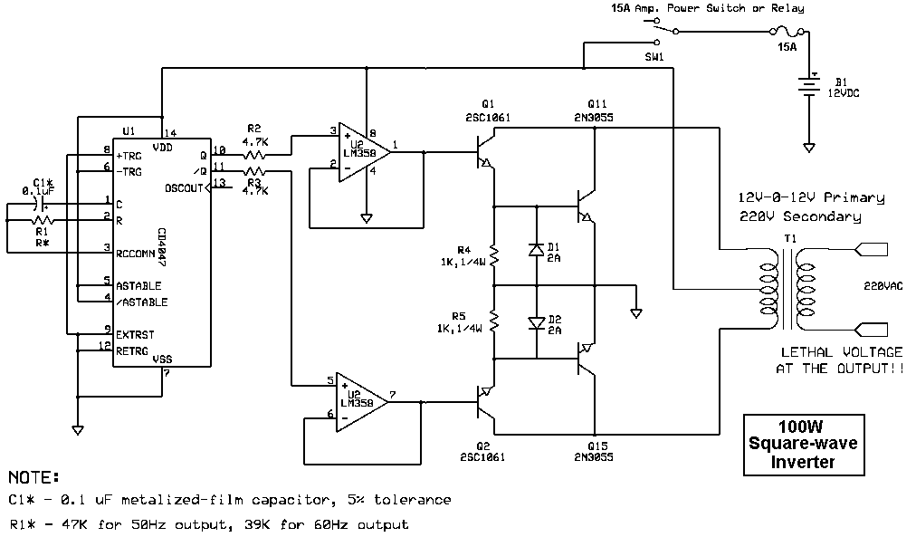

without cutting you short prabhueng but let me ask you a question. i got the circuit that you designed online with the monostable vibrator the cd4047. what is it used for the the circuit, is it just the switch the voltages on and off at a desired frequency?
We don't see the circuit.
The CD4047 is usually used as the oscillator in a square-wave inverter since it has two opposing perfect square-wave outputs. Its mono-stable function is not used. The opposing outputs drive push-pull power transistors or Mosfets that drive a center-tapped transformer.

i have a question once more..... for the astable vibrator in the attached diagram, what formula is used to calculate the frequency with which it switches the signals.
You simply look at the datasheet for the CD4047 and it tells you everything about it.
The datasheet from Texas Instruments has more details than from other manufacturers. It has the formula and many graphs showing accuracy when the temperature, supply voltage, frequency, capacitor value and resistance is changed.
Note that the oscillator runs at double the output frequency because it hase a frequency divider so that its outputs have exactly 50:50 duty-cycle.

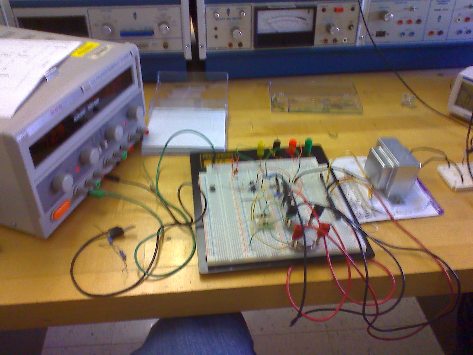

a quick qestion guys, i built the inverter circuit in its entirety i think. but when i powered it on i realise that the power supply 12 dropped to 0 which i think is more or less a failsafe if there is a problem. i rechecked the wiring and everything seems fine. i my say that i used a 24 volt secondary center tapped and i noticed that the a stable vibrators oscout is not connected to anything. is it supposed to be that was? any suggestions as to why the circuit does not give any output on the oscilloscope?
There is no power supply. The 12V comes from a powerful lead-acid battery. If the 12V drops to 0V then your battery is not charged or the 15A fuse is blown.
I noticed that the astable vibrator's oscout is not connected to anything. Is it supposed to be that was?
The OSCOUT is not used. The Q and Q-not outputs are at the mains frequency.
The Q and Q-not outputs of the CD4047 should show a square-wave at the mains frequency with an amplitude of 13V.
The outputs of the opamps should show a square-wave at the mains frequency with an amplitude of about 1.2V to 2.2V.
The collectors of the output transistors should show a square-wave at the mains frequency with an amplitude of about 22V.
I am actually not using a battery. i am actually testing it using a power supply. let me post you a setup in a minute
this is the setup as you can see there is not battery connected just a power supply.

You cannot make an inverter on a breadboard!
The contacts are ruined where you forced the huge pins on the 2N3055 transistors into them.
Them and the other connections cannot conduct 15A and neither can your thin wires.
I doubt that your power supply can supply 15A.
There is no heatsink on the power transistors and driver transistors!
ok now i am setting it up piece by piece. i get vp of 13 volts on the q and qnot outputs. i think the problem might be in the amplifier circuit.
There is no amplifier. Just a pair of driver transistors and a pair of output transistors.
They simply switch on and off, they do not amplify.
