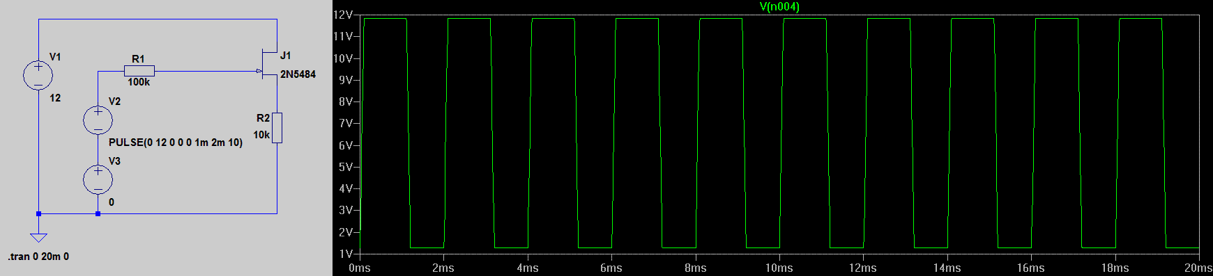

I don't know why you can't get depletion power MOSFETs.
I can accept that if you need a small signal amplifier then JFETs make more sense but depletion power MOSFETs would come in handy for high side switches. Yes I know that we normally either use a higer voltage supply to drive the gate or a p-channel (which have crap charicteristics) but why we can't just use depletaion p-MOSFETS is a mystery to me.
Do you mean "depletion n-MOSFETs"?
If so- with a grounded load connected to the source, you would have to have a negative supply to turn the transistor off. Not always inconvenient, but often.
Yes, I meant depletion n-MOSFETs and for the situation you've described I would use an enhancement n-MOSFET. I was only advocating depletion n-MOSFETs for high side drivers as opposed to p-channel enhancement MOSFETs which are crap.
But, as I said, it would necessitate that you also have a (low current) negative supply.
No it wouldn't.
The N-MOSFET would be wired as a source follower, when the gate is at +V it would conduct and when it's at 0V it would cut off.
Hero999 said:
No it wouldn't.
Depletion mode FETs are not off when Vgs=0. Think of any Jfet, and what the quiescent conditions would be if you used it as a source follower, with the load returned to zero volts, and the gate at zero volts.
You're right I've just simulated it in LTSpice.
The voltage across R2 never goes to 0V unless V3 is about -2V.
