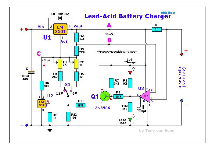

About the charging circuit, I found this circuit in => **broken link removed**
But it seems like this circuit is no longer posted there when I checked today. Anyway, the following is the attached file:
Any comments about the charging current as well as the charging circuit? I hope genius like you guys could help me out in analyzing the circuit. Err, sorry if I'm not suppose to ask in this manner :oops:

You don't need any kind of charging circuit, as the panel won't supply enough power to overcharge the battery - and the circuit you posted wasn't intended for use with a solar panel anyway.

3.) Err...I still need help in studying the charging circuit posted earlier. Would like to ask regarding the implementation of the 301 IC in the circuit. :oops: sorry but do... :oops: ...you mind..... :oops: ....giving me a hint..... :oops: about it? Is the 301 IC there for a simple compensation? :oops: so sorry.... (I guess someone is definitely going to "slap" me for asking this) :(
The 301 is a 'comparator', among other things it's monitoring the current to the battery - by measuring the voltage drop across the 0.1 ohm.

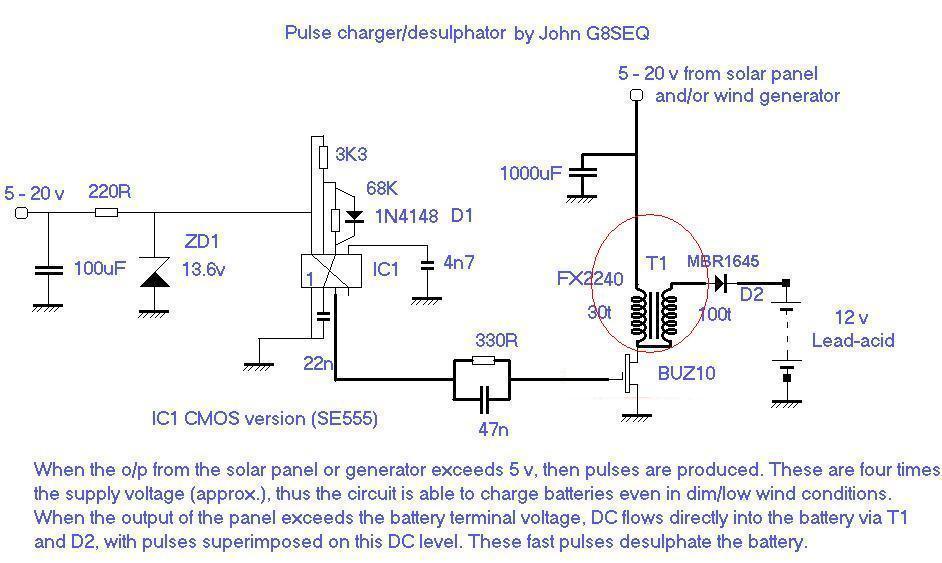

My progress: At this moment, I'll come out with a circuit to convert an AC source of 240V AC to a DC level for the application of the charging circutry posted earlier on. I guess I'll be using nothing more than a full-wave rectifier as well as a centre-tapped transformer. Maybe with a capacitor as well. Any advice? I'll post the circuit as soon as possible to get advice from you guys. Thanks!
Hi there!
I found this circuit but not quite understand the portion circled.
:oops: Sorry for my nonsense again.
If my output voltage is sufficient (20V) can i ignore the transformer?

If your output voltage is sufficient you can ignore the whole circuit!, there's no point to it without the transformer. It's a very simple method of increasing the voltage from a solar panel, and it only provides current pulses to the battery, rather than a continuous current.
As you have hardly any power to start with, there doesn't seem much point wasting some of it in the extra electronics.

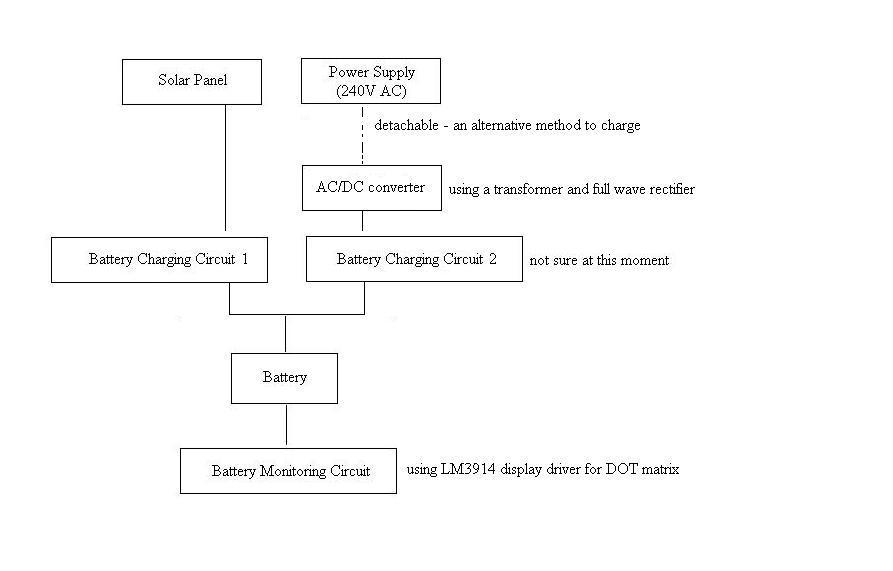

Would like to list out what am I doing again...hope you dont mind. As shown in the following block diagram.
I was thinking to come out with the proper application of the solar panel as well even though I couldnt implement the solar panel I have now to run this circuit. As I was thinking that I might be able to present the whole idea on how the entire battery charging system works using an appropriate solar panel.
Block diagram 2:
Two different charging circuits to charge the battery.
For the Battery Charging Circuit 2, issit suitable for me to apply the "untitled - Lead Acid Battery Charger"?

OK, here's stuff to know:
1. Sealed lead acid batteries do not like overcharge. Your solar panel's current is so low you will not be able to generate substantial overcharging currents, but your mains charger WILL. Overcharging in sealed lead acids can be prevented by limiting the charging voltage. However, it's not likely to fry your battery before you're done with the project.
2. As you may have noticed from your study of the solar cells, when you graph the voltage vs current, loading it heavier won't get you more current, it just makes the voltage go lower, and the power (voltage times current) is reduced. Basically you can just look at it as a mostly constant voltage device. Changes in sunlight level will change the current you can pull from it without making the voltage drop, but the optimum voltage remains mostly fixed.
3. As noted, you do not have enough current to effectively run a dc/dc converter, the converter takes a few mA to run the 555. Plus there are significant losses in the diode and magnetic core. Plus... well, your converter appears to be a type that doesn't work. Not that I've tried it myself, and I don't totally understand the problem they describe, but these guys detail why the circuit will fail:
So the project will be better off with just hooking up the solar cell through a blocking diode straight to the battery. Bottom line.

thats three people ( including myself)who agree Charging circuit 1 is a diode.. as for charging circuit 2 i suppose that you want to use individual components and do it the hard way..my advice is keep it simple..
And start working on the battery monitor circuit.!!
actually you should design and test the battery monitoring circuit FIRST !!
because once you have that done you can decide how you are going to turn off the charger, when your battery is done...
