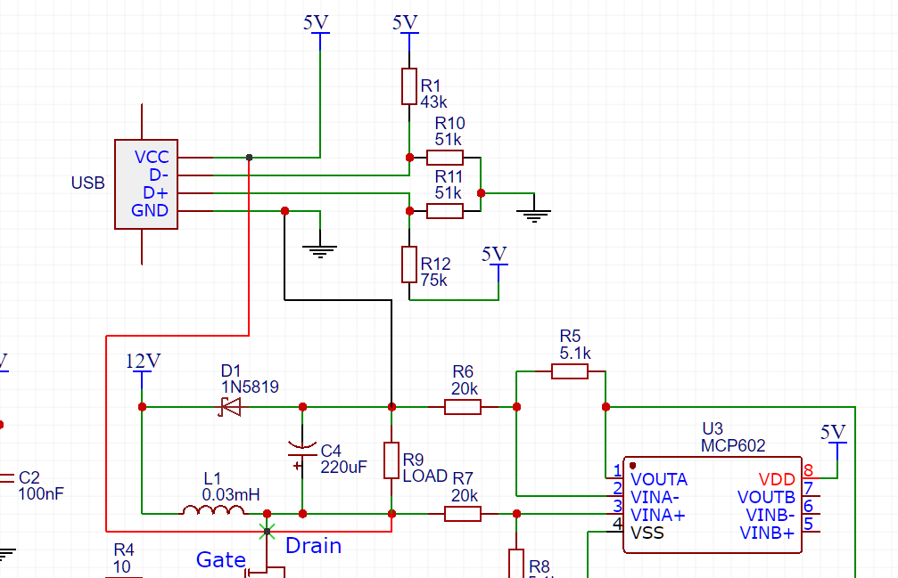

Hi all,
I have been building a dc-dc buck converter for my project for months. The aim was to be able to produce a 5V, and a minimum output of 1A. (To charge smartphones)
I have been following closely to this build: /https://www.instructables.com/id/DIY-BuckBoost-Converter-Flyback/
I was able to build out a prototype from the link above and using a simple resistive loads ranging from 330 to 43000 ohms I was able to tune the voltage to about 5volts.
Through this output I connect a usb connector for which I tried to charge an android phone (LG V10). There was indeed charging ongoing, however with the help of a usb doctor which shows the output current, I was only able to get 0.07-0.09 amperes of current.
I have consulted many of my friends and google as well.
The first solution was that the usb connectors has D- and D+ pins which also provides the exact current for to properly charge a smartphone.
https://electronics.stackexchange.c...ata-pins-d-and-d-on-a-usb-power-adapter-to-be
I followed the design of the apple charger (Previously charging an iphone directly doesn't work), and integrate the design to the buck boost converter at the output side as shown below, however I wasn't getting any charge notification at all from the iphone....
The second solution which that the comments suggested a voltage regulator with a higher output current. I tried hooking up with a output of 3A regulator but it didn't work as well.
Is there any solutions for me to make use of the 5V output to charge the smartphone at a current of 1A?

i might be an idiot but i do not see anything that resembles to a buck-boost circuit at that link . . . besides it never specifies it's input nor the output port ???
the inductor value of 330µH is a weird selection for 1A 5W
← is that correct
Erm this is the main circuit of the whole buck boost converter. https://easyeda.com/GreatScott/ATtiny_Buck_Boost_Converter-RXig0YIif

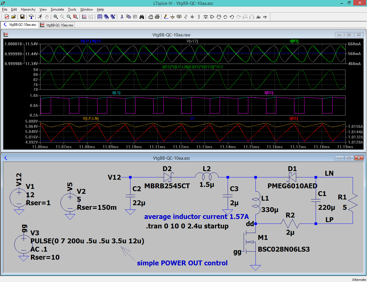

thanks for quick reply - i missed the R9 being the "LOAD" -- decoding the schematic . . . ////
VtgBB-QC-10aa.png quick apx. "in operation" -- there seem to be no low power operation limiting figures -- that would show out here ???
it would work
depending on other operational parameters . . . if you consider the ramp up speed at such inductance - it sets the frequency low or the inductor operating near saturation e.g. it requires an inductor that can operate near saturation (having permanent DC component)

View attachment 109010 quick apx. "in operation" -- there seem to be no low power operation limiting figures -- that would show out here ???
if the previous quote is what i think it means then the 1A is the minimum load the R9 should have for the thing to work

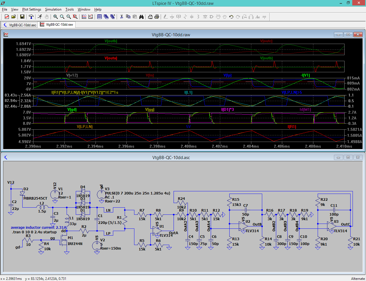

Thank you so much for simulating the project of mine! However, that was just part of the schematics.
This is the full schematic. Apologies for not showing all.

I had to investigate because the connection to your D+ and D- lines looks wrong.
Try removing R1, R10, R11 and R12 and just connecting D+ and D- together (the spec says a short circuit up to a maximum of 200Ω - I suppose it is to allow for different kinds of configuration arrangements). Don't connect them anywhere else. This should give you up to 1.5A charging current - or possibly the maximum the supply can, err, supply.
I believe the standard arrangement with chargers which only supply 500mA (the 1.1 standard) is to connect them together but have a pull up or pull down resistor.

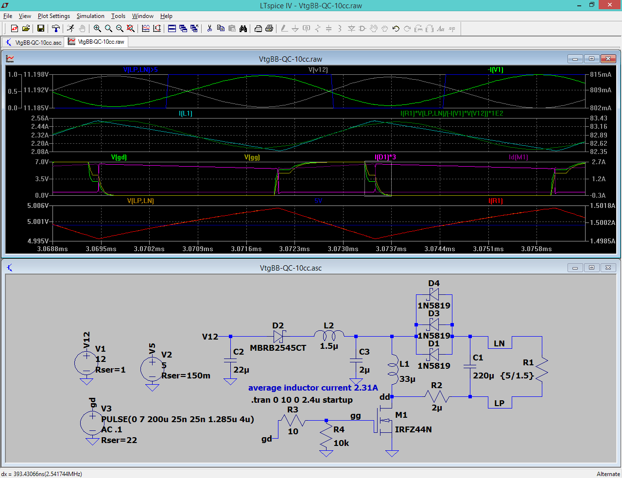

basics - the larger the inductance - the slower the current ramps up on it at MOS-FET switch ON = the inductor's LOAD/UNLOAD SPEED e.g. the speed of the inductor's capability to deliver power -- https://www.schukat.com/schukat/sch...16&refDoc=CMS8C7517EAFA458FEDC1257421002FBF84
your case is not easy to debug as it requires precisely knowing the 'tiny code especially at load step e.g. if you connect the battery - the MCU may interpret it as an overload condition and instead of fast attempting to drive up the output voltage it may go - say - to a power limiting mode . . . from the other hand the lower the inductance the higher the instant power it deliver and the faster switching times (more expensive equipment) are required (here the designer trades in between) . . .
t shows 0.03mH on the schematic, so 30uH - makes more sense, yes?
indeed - i assumed a different type of marking at quick glance of photos at instructables - i do have both types the exponent ending and unit ending ones around my place . . .
your correction + schematic + attiny d/s (shows max 20mA sink/source) suggest there might be energy loss at mosfet turn-off or inefficient operating pattern for inductor due "bad" timing control - perhaps ((((i hate to chk it with corrected simulation coz the ±20mA are not the actual port capabilities but ??? allowed max. illustrative values #"¤!!¤&)))) . . . 8ns ?? DS.OFF maybe -- leaves us inductor (not 2+ amp capable) or MPU code (tested for all weather)
Hi there! Thanks for the response and help throbscottle :)
Sure I will connect the D- and D+ together to see if there is any changes!
It shows 0.03mH on the schematic, so 30uH - makes more sense, yes?
Yes my inductance is about that value, do I need to change the value or something?

Here is the full schematic, something it should *not* have taken 15 posts to achieve:
It is not clear where the circuit "output" is. In a non-isolated buck or boost converter, one end of the load usually is tied directly to either Vcc or GND. Also, there is no buck here; this circuit can only boost.

The output is at R9 which is the load section.
I was able to buck and boost in terms of the voltages. However I was not able to get a decent output current.
I have several questions that I was wondering if anyone could answer:
1)The attiny85 he used, is that to produce a square wave to control the mosfet?
2)Why is there a need for the op amp in the circuit?

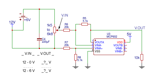

?? what is the voltage range at V(D1,C4) and V(L1,C4) and vhat is the voltage range U3.Pin-1 or U2.Pin-2
Design of a DC/DC buck converter for ultra-low power applications in 65nm CMOS Process -- with component selection and misc. feedback filters' examples e.g. what to do with your c-mos op-amp
img. -- a dummy filter test -- since your specific setup has "highly variable" input (relative to c-mos supply) ↑the above↑ much likely can't be adapted without compensating against this
____ while the example just illustrates a difference of RAW and smoothed output (PS! the simulation is illustrative and uses a different component values than those in your circuit -- among other causes is i've not yet bothered to explore the attiny operation !!!)

     feedbackinputval = analogRead(feedbackinput);
   else{
   analogWrite(pwm, pwmval);
   pwmval = pwmval - 1;
   potinputval = analogRead(potinput);

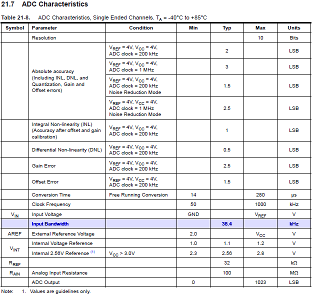

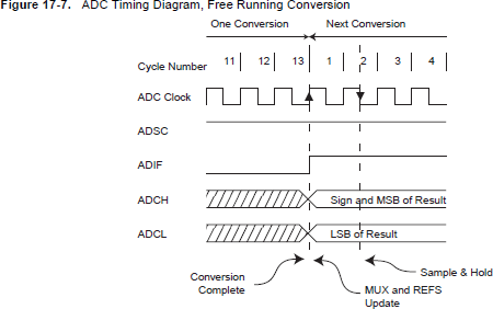

all it takes now is to find some virtual tiny or many weeks of reading the spec.-s
it seems the 1MHz input rate can be configured but is not recommended (related)
which means that you might need to use an inductor with multiples of higher inductance to achieve 1.5A output current
it seems the 38.4kHz comes from Max. recommended 1MHz ADC Clk / 13 e.g. a 76.9ksps input rate resulting in incoming signal bandwith of 38.5kHz
