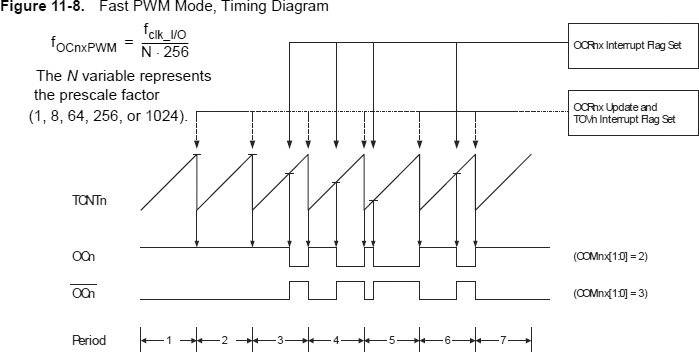

there's an article explaining the I/O speeds on a different mcu basis -- but we can predict the input rate being apx 1 x sys clk from Figues 10-3 & 10-4 -- that incase there is some ideal sync. between sys-clk and incoming digital signal otherwise it's variable 1 to 2 sys-clk.-s e.g. at 20MHz you can read in at predicted average 14Msps or at least 10Msps - - - - that if you use external comparator to compare V.out V.set or incase of external ADC // assuming 4-bit parallel input (is supported by port masked input instruction ????????) // the 12 bit DAC can be fetched at 3MHz - versus - 1 bit comparator at 10MHz . . . . . . . . . rserving some time to do internal lookup we assume 300k / 1MHz MOS-Fet control rate - - - 3 or 1 µs "sys don't care" free wheeling - - - whatever the timing - the current limit for inductor+mosfet should be another external device sending it's "triggered" status to mcu
shortly -- without looking the code yet - but only the schematic - we can speculate the system being robust and not very flexy . . . unless the pwm modules have their own controllers and setting the pwm index does some miracles here ??? -- at max. clk/2⁸ (78.1 kHz) or clk/2⁹ (39.1 kHz) PWM cycle ??? -- related https://microchipdeveloper.com/8bit:10bitpwm

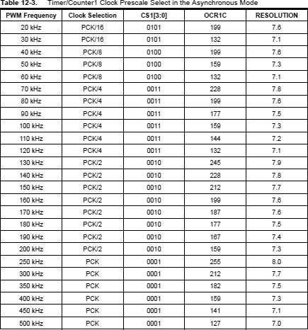

// it seems that the PWM setup is highly ??? flexible (Tbl-12-03) but there is only one poor app example(was not searched ↓1-st **↓)/spec(was not found) ??? they must had a target design or a set of when developing the '13'25'45'85 chips - can't find any ???

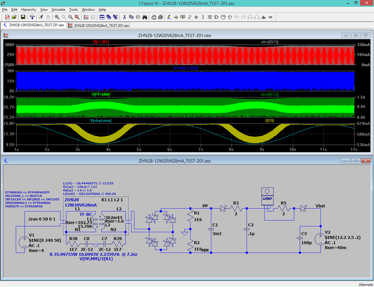

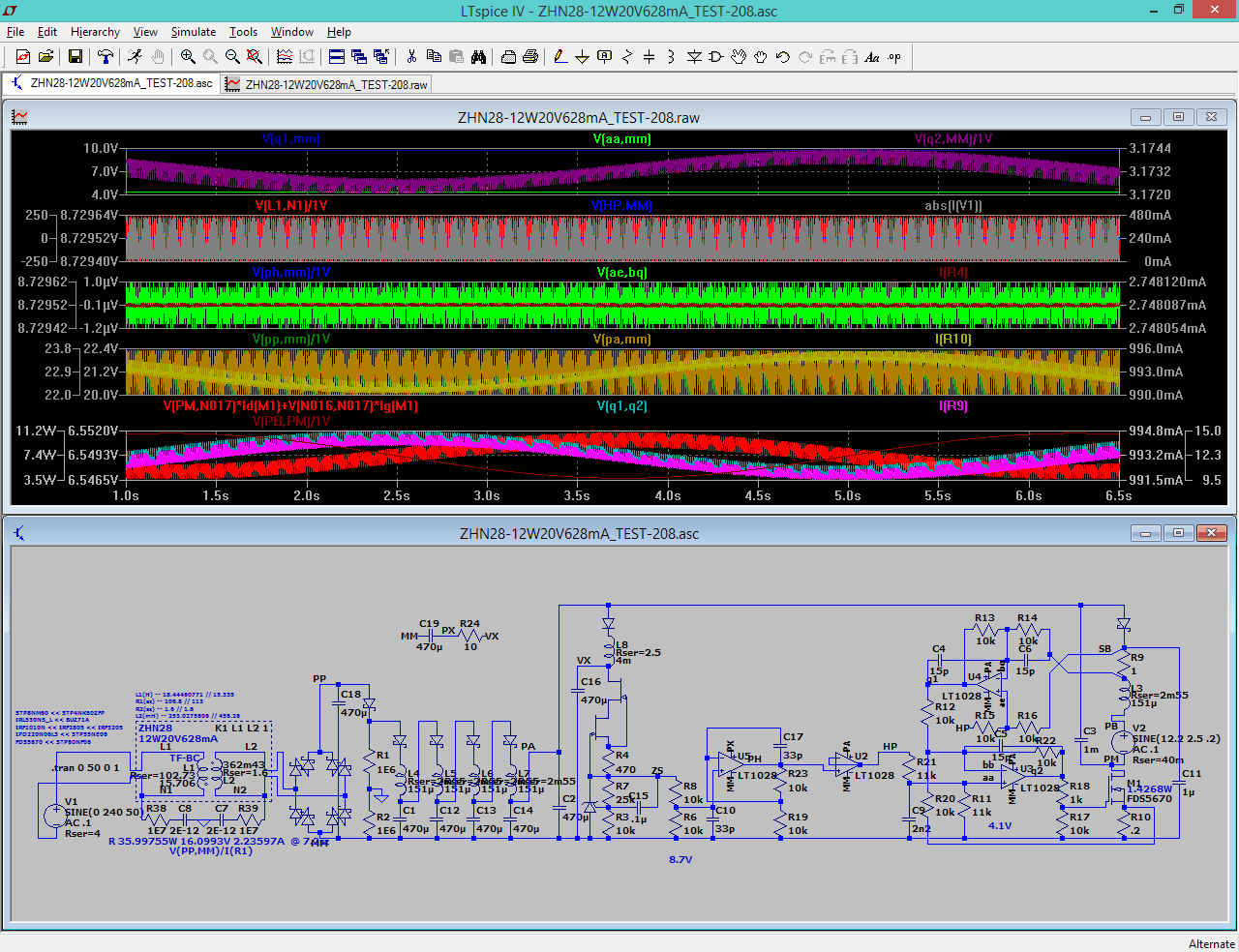

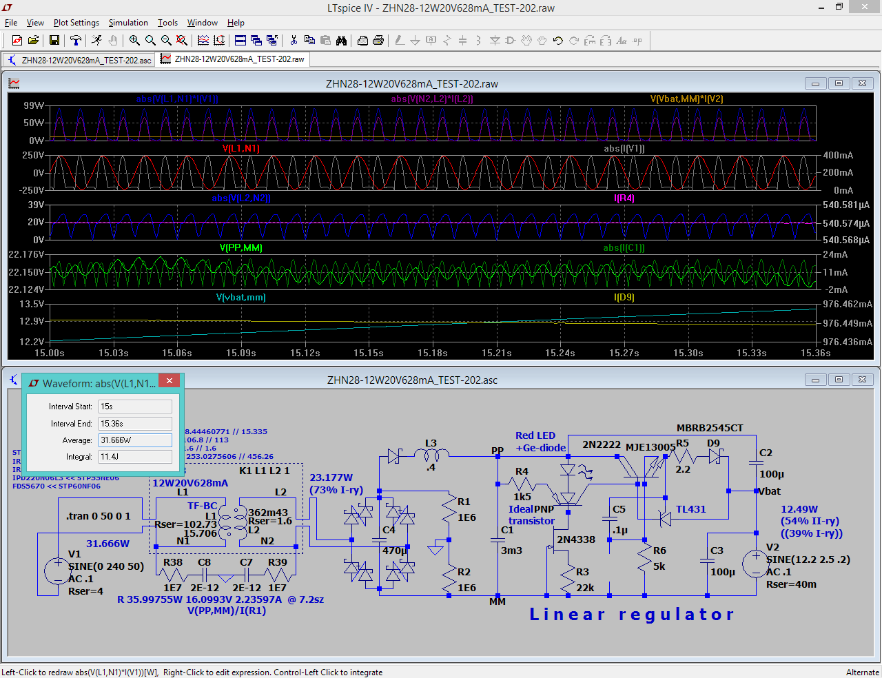

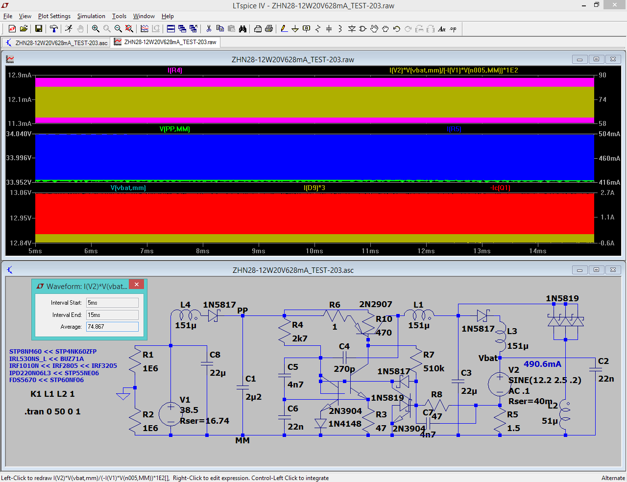

i just ran through options to convert an old X-mas lights' transformer to sub-Ampere 7A·h Lead-Acid Charger
uploaded just incase you can read/find out anything useful from this experiment

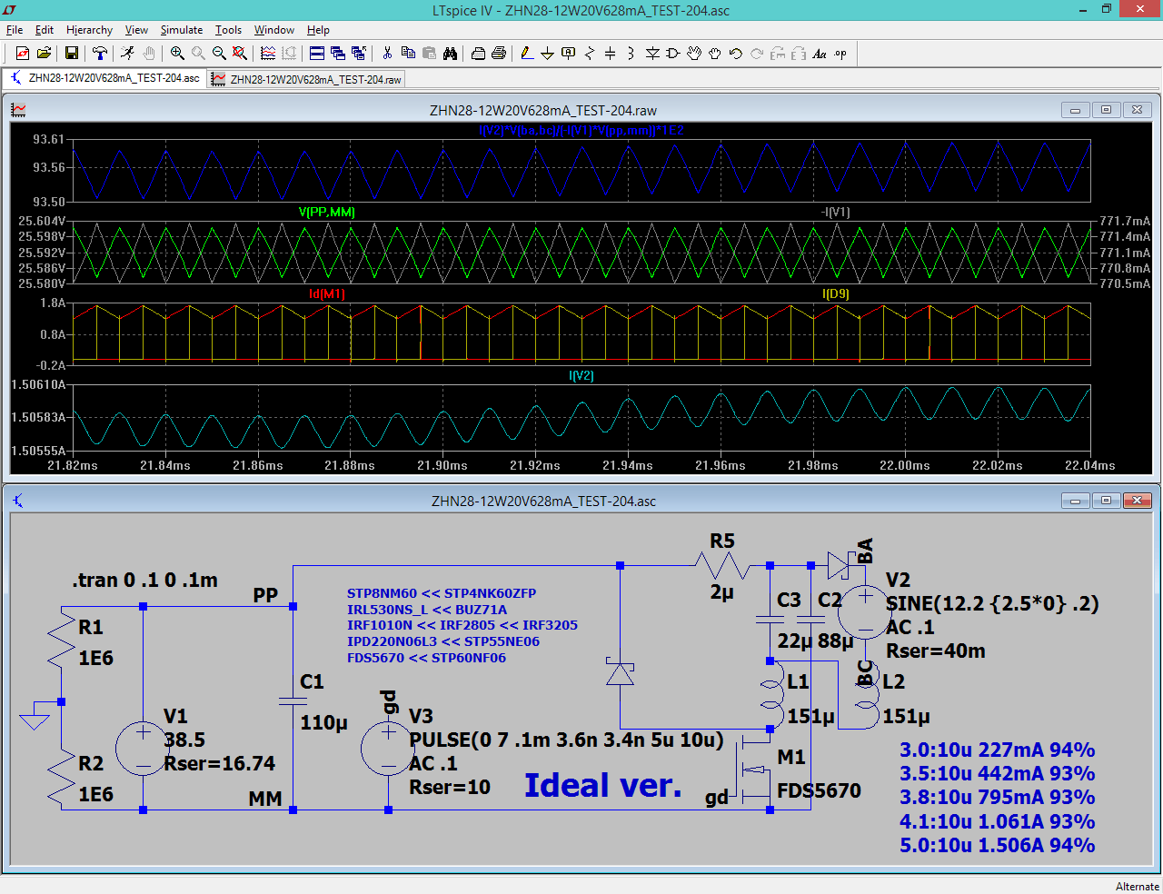

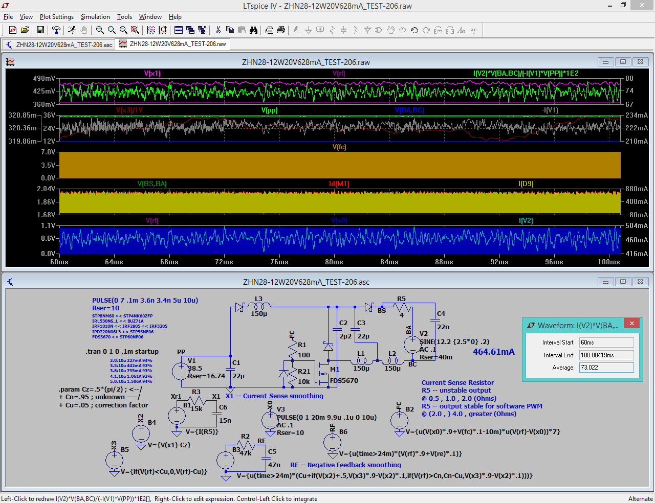

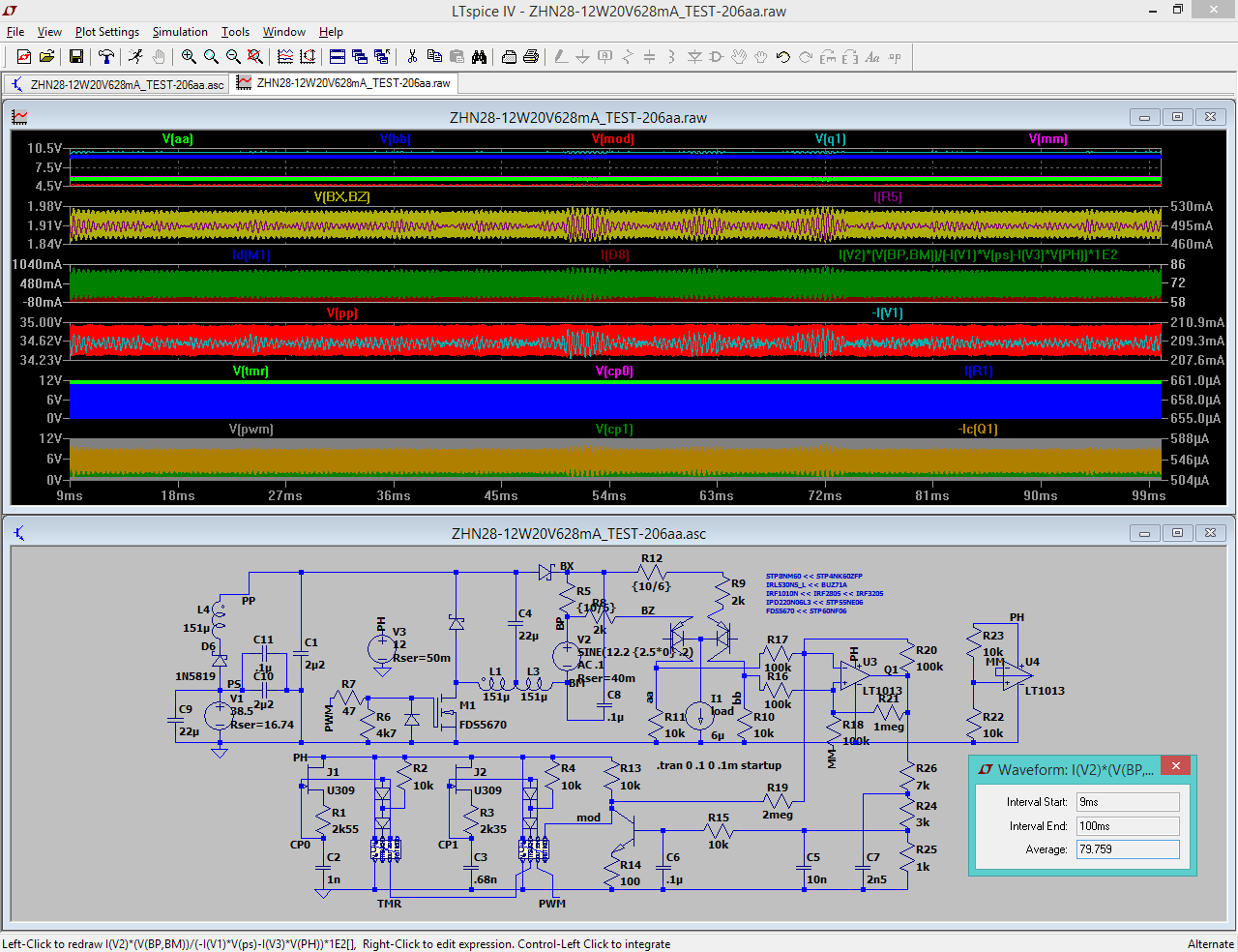

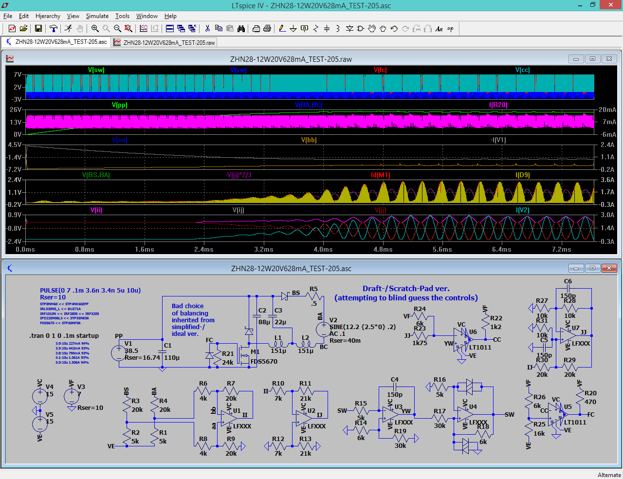

-- it seems the PWM "control delay" is critical and must be matched well for the circuit to become+stay stable
(the TEST-208 was actually completed after TEST-202 and prior to 203 to 206aa . . . included coz it's a "full circuit" and it does ?something?)
muhahaa
PS! however all the PWM tests are basic/simple/principal
  1. the ramp speed of the current on inductor depends from
    1. supply voltage
    2. battery (state of charge) terminal voltage // or load variations
    3. chosen charging current
  2. all of the above must be properly scaled and included in the PWM control signals
    -- to avoid over shooting with the feedback . . .
  3. . . . that leads likely to instability in addition to mentioned set of control delays in the basic PWM circuit

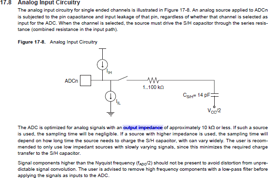

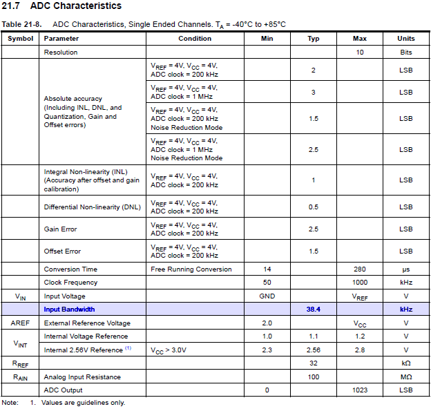

it seems the 1MHz input rate can be configured but is not recommended (related)
which means that you might need to use an inductor with multiples of higher inductance to achieve 1.5A output current
it seems the 38.4kHz comes from Max. recommended 1MHz ADC Clk / 13 e.g. a 76.9ksps input rate resulting in incoming signal bandwith of 38.5kHz

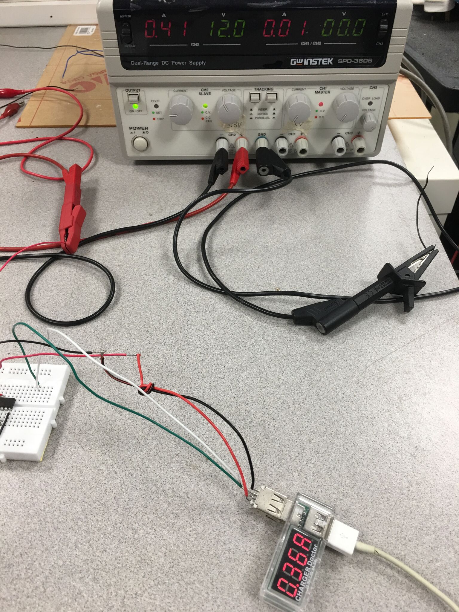

Update on today's findings at my lab:
As shown from the photo I was able to get a decent charge from my iphone at about 0.36-0.41A.
Though I still wish to obtain a 1A minimum charge....
