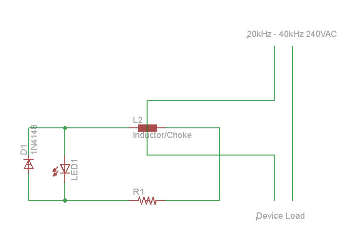

ronsimpson, thanks for that! yes I probably should clarify. The range is from 20kHz to 40kHz. So as I am VERY new to inductors/chokes and current sensing. I'm assuming that the ratio on say the link I provided earlier would be something along the lines of 40:1 and a very low current capacity? but should be enough to run a led? Something like the attached diagram? I guess I just need to know which choke would work.

Go back and look at coilcraft. A current transformer has the resistor across the coil. It is not a voltage transformer.
If you have a 100:1 transformer then:
Secondary current is 1/100 of primary current.
Secondary resistance is (100*100=10,000) times. A 100 ohm sense resistor on the secondary makes the primary (high current side) look like a 0.01 ohm resistor.
It is more common to put the LEDs across the secondary with out any resistor. I use two LEDs one for + and one for -. Pick a turn ratio that works for the LEDs. Example. 1mA of LED current through a 100:1 transformer requires 100mA on the primary. 10mA from 1A.

Here is what I did, I have a 100uH choke that is ~47 turns connected to two leds.
I tested it with a 100Ohm resistor accross the choke and it worked, it is a bit brighter without the 100 ohm resistor. The Transducer is operating at 20W and the leds have been flickering for the last 5 hours. What would be the calculations to ensure I don't overpower the leds in the peak current sensing, as these will be an indication of a failed transducer I wouldn't want to start replacing working transducers because the leds where pushed too hard and failed :(
What would be the formula to figure out the resistor accross the choke and the current resistor for the LED on a 47 turn current transformer. I need to do two one for 50W transducers at 240V and one for 20W transducers at 240V.

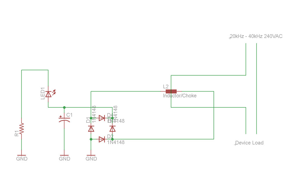

Ok, well guys I managed to test the voltages and whatnot today and was peeking at 11.9v AC so it was a good low voltage to work with. for those who are interested here is the final schematic to basically power the led while there is current through the choke(current transformer) the values of the components would change based on the current you'd be wanting to flow through the choke. This is for ~50W at 240VAC and the resistor here used I think was to be 200-300ohms with a little led, after the AC to DC conversion and whatnot it worked pretty good at that. C1 is just a 1uF electrolytic to filter residual frequencies out and smooth it all over, mind you it could probably be a lower value... just what I had handy.
Any comments or ideas are welcomed.
Cheers
PS this is a 47:1 ratio, obviously for those wanting to sense lower current flow and still get the led to light up you can just wrap the load to be sensed through an extra time or two to increase the sensitivity. here is a link to the choke I used too.
