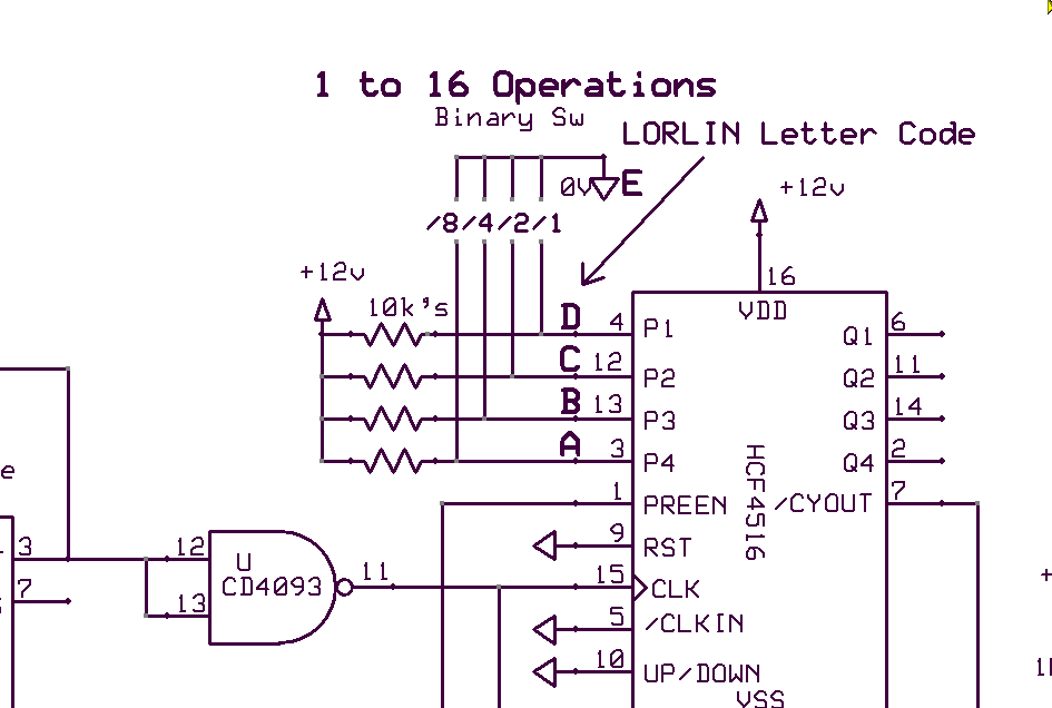

Am i correct in saying that the bcks 1002 will still work but the setting 0-16 will be backwards?
Regards
Mark
hi Mark
It could be connected 'backwards' if thats acceptable.?
Do you want a diagram showing how best to do that.??
EDIT: A point to watch out for is their switch markings are reversed
Yes that would be good eric if possible?
Mark,
Look at that image in my last post.
The offer to assemble and debug your 1st unit is still on the table if you get stuck... free gratis
Eric
Eric,
Thanks for that so will that work 0-16 clockwise or 0-16 anticlockwise?
Also depending on which way round it is do you know where i can get a switch legend plate from i.e. Some form of sticker that shows the switch positions
Regards
Mark
Eric,
Regards
Mark
Mark,
For a clockwise rotation of the knob, it will go 15, 14,......1,0
A local engraver could make a switch plate from 'traffolite' [ white letters on a black background] with a central fixing hole, that could be secured, using the switch shaft/nut.

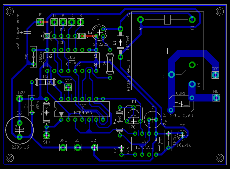

Hi Mark,
here are the changes to be applied when using a complementary switch:
1. cut the trace leading to terminal "E" at about the position as drawn
2. solder a piece of wire from "E" to VSS trace
3. drill a hole of 0.8mm (0.03") dia at a distance of 0.1" in line with RN1 right of pin 5 of RN1 as shown in the screenshot
4. insert RN1 with pin1 in the new drill hole (pin5 should now be due South of terminal "D")
5. solder a straight piece of wire from the emitter of T1 to pin1 of RN1.
6. finished :)

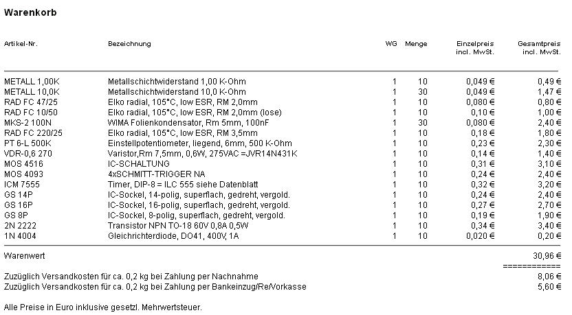

hi Mark,
Chat with Boncuk before ordering, he can get pricing for you via Germany.
E
Hi Mark,
here is your shoppint cart.
The relay is omitted since my supplier kicked it off the stock. However there are plenty of relays matching the FINDER S40.11 concerning performance and footprint/
Also omitted are the heavy duty push buttons (vandalism proof) which cost €5.84 per piece and the binary code switch which is available at "Reichelt elektronik" only for PCB-mounting with very small encapsulation.
Eric has a lot of them but he would use 4 single switches to create any value from 0 to 15. (1 to 16).
Attached is a copy of the shopping cart. I used 10 pieces per part for easier calculation. Just divide the total amount by 10 to get the price to populate one single board.
All electrolytic caps are low ESR types with a temperature range up to 105C for a long life with little drift of the rated capacitance value.
Prices include 19% sales tax which will be deducted for delivery outside Germany.
So the total invoice should be €26.02 less shipping cost.
If you want to order it won't be a problem doing that using the already stored shopping list. I'll use your postal address for delivery and upon receiving a "proforma invoice" I'll provide the bank data of Reichelt elektronik. Upon receipt of the money Reichelt will initiate quick delivery (within 24 hours).
Kind regards
Boncuk
