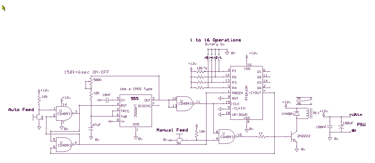

After I posted last night I did make a few changes and managed to get it going but only counting up or down to 15 - I'm at work at the moment so will try again tonight - could you just look at the attachment I'm ut trying to work out the pin config, as everywhere I look they seem to be different - I've put a table together comparing Yenka apbbreviations to your circuit and also the internet ref.
Thanks for your help, I know this is a fault on my part, and I will let you know tonight how I get on.

Your pin conversion chart looks OK.
I will try to do a circuit diagram using ExpressSch drawing program and post it this eve. [UK]
Download the free ExpressPCB circuit and pcb drafting program from the web, then you can open and edit my posted diagram...
This is the expresssch program drawing of the circuit.
If you have downloaded expresspcb, you should be able to open the .sch file OK.
Note:
I have added a Manual feed button, while pressed the Relay will energise.

Presumably the left end of the 10nF cap is grounded and pin 8 of 555 goes to +12V ? The triangle symbols at those points in the schematic are somewhat ambivalent.
I missed that one, should be marked as 12V, the rest of the 0V and +V I took the trouble to notate.
There is a difference if you know expesssch, the 0V is a 'triangle' and the +V a 'spike', do you use express.??

I've made the changes to the switch arrangement on the Yenka version I've got running, again the notation on the express software appears to be a little different but seems to work out as follows
Pin 1 - express = PREEN, Yenka = LD, First circuit you provided = PE
With the link from the output of the lower gate to yenka LD the circuit does not work - this may be something to do with yenka possibly??
With it removed the circuit does a count of 15 and then resets - you also seem to have to press the momentary push button twice to get it oscillating - again this may be something to do with Yenka??
Thank you for the manual feed - thats a very good, welcome addition, sometimes you do need to do that!!

hi Mark,
I think it must be something to do with Yenka sim.
Did you download the expresspcb from that link I posted, you can then use it to see the sch file I posted.
The circuit as drawn is still feeding the cows on the test bread board at my end.:D
