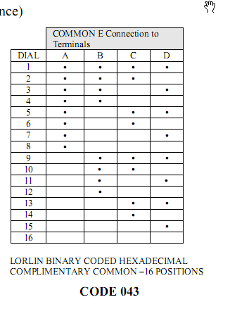

hi Mark,
Which Binary selector switch did you final buy.??
Its important, the circuit is drawn to suit a /1,/2,/4,/8 output with the common on the switch to 0V.
So when say position '1' is selected on the switch, only the pin#4 on the CD4516 is High [+v] and the other 3 pins, 12, 13, 3, are Low [0v]
Example 2: switch position #7, CD4516 pins 4,12,13 should be High [+v] and pin 3 Low [0v]
Use a voltmeter, select position #1 on the Binary switch and measure the voltages on the parallel input pins of the CD4516, lets know what you have.

Hi Mark,
I cut off the email address at the bottom. Beware of SPAM!
A BCD coding switch can in fact code 16 values which are zero to 15, where 15 equals 1111 (or 0000 if it encodes to ground). There is no error in your simulation.
If a higher value is desired you might compensate it by longer time cycles.
The suggested BCD switch is very large - not to say huge. There are smaller switches on the market which are labeled 0 through F (0-15) with a turn button already built in. I'll use one of those for the PCB design to keep the board small.

Eric,
I bought the one posted on here but its not arrived yet so I've just been selecting the count number by shorting a particular switch input to ground, I'll do some more testing on the circuit tomorrow.

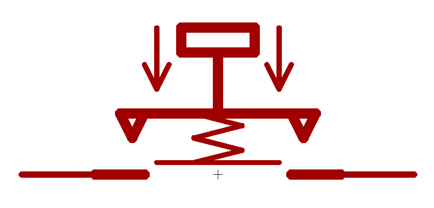

The Manual switch is not a push button as per schematic. It is a latching switch like the Auto-feed switch. If it were a momentary switch the feed would only last as long as the switch is being activated.
hi Hans,
This was my intention, food is dispensed only for the duration the Manual switch is pressed, not latching.
The 1 to 16 portions, Auto switch is also not latching.
To both
both switches should be non latching when the auto button is pressed it just stsrts the auto cycle as for the manual button it should only provide one pulse duration of which is determined by how long you hold the button in for, however owing to how these feeders work it will only ever allow one portion of feed to be delivered
Regards
Mark
hi Hans,
Hi Eric,
sorry, my bad. :eek:
To avoid misinterpretation my momentary switches look like that.
Cheers
Hans

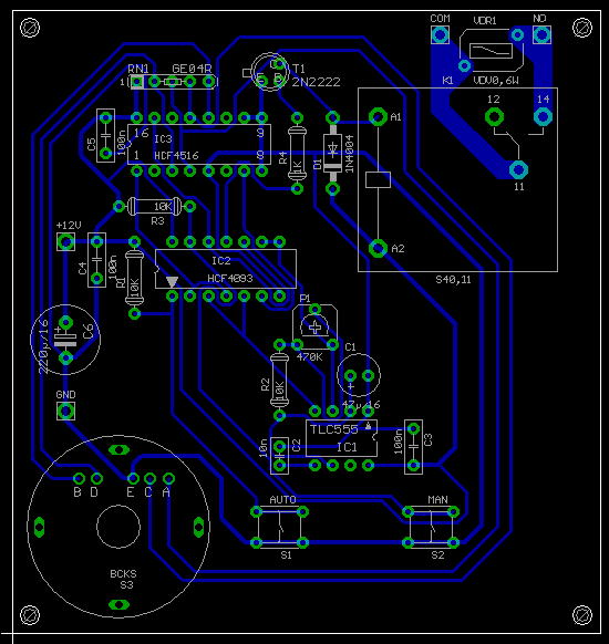

Hi Mark,
I have designed the BCKS (Lorlin) according to the data sheet.
Please print the pdf-image to scale and try out the footprint as soon as you have received the switch.
The outer diameter of the switch housing should be 26.2mm for proper pin distances.
Regards
Boncuk

Hi Mark, hi Eric,
it's a bit late to tell me that.
The first PCB design is finished except for some cosmetic corrections.
Take a look please
Boncuk
That looks brilliant, i cant see the variable resistor or the 47 micro farad capacitor though? Also is that something connected across the relay output?
What physical size is the pcb ?
Regards
Mark
