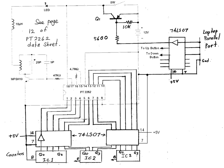

hi Len, Sean
If Eric confirms the above, you will need three 74LS07 ICs.
Two for the counter output interface and one for the computer interface

Here are the interface arrangements.
I suggest you draw up the whole circuit and post it so we have common drawing to refer to instead of my scribbles.
Do you have a data sheet for the 74LS07 and the other ICs?
If not, go to a site such as alldatasheets or just do a Google search.
The 74LS07 contains 6 non inverting buffers with open collector outputs.
So when an input is low, the corresponding output is low.
When an input is high, its output is open.
So the PT 2262 address lines will be either open (floating) or low.
Thus you will have 1000 combinations - 000 ~ 999 as determined by the counters.
If you want to monitor the counter settings - connect LEDs in series with suitable resistors (about 470 Ohm) to each of the Q outputs. Led on = floating, LED off = Low.
eg. If the counters were set to say 3 4 9 (0011 0100 1001 in BCD), the Tx code would be LLff LfLL fLLf

hi Sean,Len
For reference have added the paraport connections to Len's latest drawing.
Len,
Overdrawn some of the faint lines on your drawing.

Pin 1 is the "fire button". A low on pin 1 turns Q1 on and thus turns the Tx on.

Sean,
I don't believe that you need to do it that way.
You have 12 bits (4 bits per counter) that are BCD coded - as you said.
Connect them to the PT 2262 as shown in the attachment (this was attached previously but I've attached it again for convenience).
Connect the display drivers to the counters as you have done.
Now, I know that the BCD sequence is not a pure binary sequence, but does that matter?
If you have LEDs connected to the 12 inputs to the PT 2262 (we can discuss how to do this later) then they will display the bits that are being input to the Tx and so you can set the Rx accordingly.
So the procedure would be:-
disable the Tx,
reset the counters,
advance the counters with the up button and set each Rx in turn.
For example, the first Rx would be set to 0000 0000 0001, the second to 0000 0000 0010, etc. The 12th would be set to 0000 0001 0010.
Since you have plenty of binary combinations to play with, then as far as I can see, a few gaps in the sequence does not matter since you only want a max of 999 combinations.

Sean,
You're misunderstanding the Tri State.
You're assuming that any output can be L, H or TS. Not true. When the outputs are set in TS, all outputs are in TS.
TS is used for "bus" connections. For example, several RAM memory chips could be connected to the same data bus. All are normally in TS, but when the CPU wants to address a particular chip, it disables the TS of that chip only so its outputs are connected to the bus so that data can be transferred to the CPU from that chip. I suggest you do an internet search for TS.

Sean,
You could have 2 counters (ie. one BCD and the other binary) counting in unison, but there is a possibility that they may loose sync (due to a noise pulse or some other reason).
Given that you're setting off fireworks, it seems to me that this could be a safety issue, ie. you would fire the wrong one if the counters loose sync.
It would be better if you had a BCD counter with a BCD to binary converter.
Let me know if you want to persue this option and I'll post a suggestion.

Sean,
I thought about your project while we were away (not much else to do at mother-in-law's).
After considering various options, I concluded that the configuration I suggested previously is the best, ie. 3 decade counters and decimal displays.
The advantages of this are:-
1. hexadecimal displays are not required.
2. you can have up to 1000 Rx (or 999 if you choose to exclude zero)
3. The Tx circuitry is simple - no BCD/Binary code conversion, etc.
4. It is easier to set the BCD codes (rather than binary codes) in the Rx.
Now I know your objection to this is that you want to use 8 bit switches in the Rx since you want to use all 256 combinations.
I accepted this point originally, but now I'm not so sure.
I assume that the Rx have 12 code setting inputs the same as the Tx. Is this correct?
If so, then to go beyond 256 combinations, you will have to add extra switches. So why not add them at the outset?
Thus the first 4 switches would set the Hundreds digit (in BCD), the next 4 the Tens digit and the last 4 the Units digit.
It is very easy to remember the BCD codes, but not as easy to remember the hex codes.
The DIL switches come in various sizes - 2 way, 4 way, & 8 way, so you could install either an 8 way and a 4 way, or three 4 ways. See https://www.altronics.com.au/index.asp?area=item&id=S3050 {This is an Australian supplier, but you should be able to buy then in the US also}
You can also buy DIL switches that mount vertically and they have 1/10 th inch spacing between pins. See https://www.altronics.com.au/index.asp?area=item&id=S3094
Let me know what you think and - assuming I have not missed something - I'll draw a circuit and post it.
