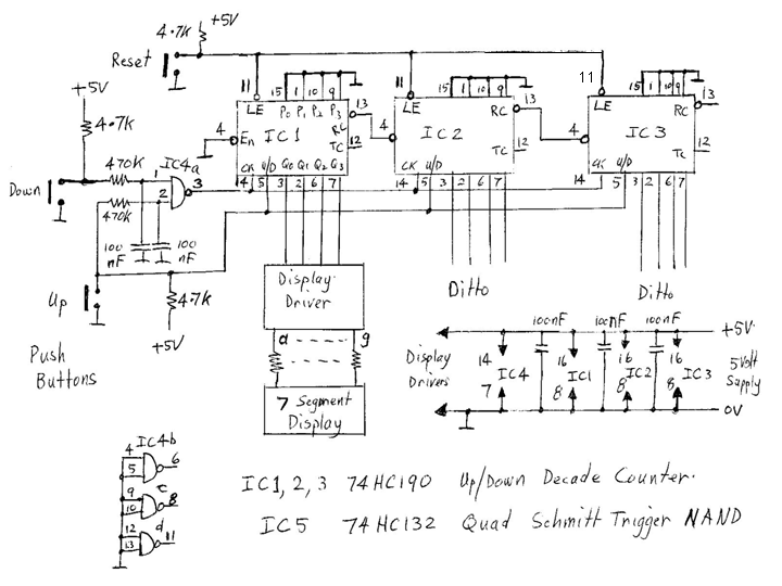

Counter circuit used to switch an encoder chip
EDIT.
Good work, I've recorded the voltages and currents for future reference.
I replaced the attachment as forgot to include the Reset button in the circuit.
Circuit description.
Turn on Power, press Reset button, all counters are preset to Zero. Display shows 000.
Press Up button, U/D is pulled Low, the 100 nF cap starts charging towards +5 Volt.
When the cap voltage reaches the upper threshold of IC4a (after about 50 milliseconds, IC4/3 goes High and IC1 increments fro 0 tp 1. The display shows 001.
At the tenth press of the Up buitton, IC1 goes from 9 to 0 and IC2 goes from 0 to 1. Display shows 010.
If the Down button is pressed, the U/D input remains High and, after the delay, the counter decrements by 1.
The 50 ms delays have 2 functions.
1. to allow time for the contacts to settle in order to avoid contact bounce problems.
2. to ensure that, when the Up button is pressed, U/D is pulled low before the clock goes high.
I have not included the interface to the Tx. You will need two 74HC05 hex inverters for this.
I suggest you build the counter first to gain experience. Note my previous comments about the display and display driver.
I suggest that you build it on a prototyping PCB.
I don't know what is available in the US, but in Australia the electronics shops sell various types of prototyping PCBs.
The one I prefer is sold by JayCar, see the "IC Experimenter's board" www.jaycar.com.au. Catalogue number HP-9558.
They have an internet shopping site in the US www.jaycar.com.

I think I can follow the schematic. But I am a little confused about the switches. I know that they are creating a break between the circuit positive and the ground but I have never seen them drawn this way. I will try to get the components and set this up next week. I have some plans this weekend that will keep me out of the house most of the time.
EDIT: Couple more questions, It looks like the transistors are called out as IC4a-d. the bottom calls out IC5 as a NAND but I can't find an IC5 in the circuit. I also can't figure out where IC4b-d go in the circuit. What is the purpose of connecting both inputs of these transistors to ground?
0RESET0 said:
I think I can follow the schematic. But I am a little confused about the switches. I know that they are creating a break between the circuit positive and the ground No they do not break the +Ve. The +5V is applied via the 4.7k resistors. When a button is pressed, it connects 0V to the line (perhaps that is what you meant by "break the positive"). For example, look at the Reset button. It is normally open so the reset line (pin 11 on the IC1 ~ 3) is held high via the resistor (this is called a "pullup resistor"). When the Reset button is pressed, it applies 0V to the reset line (a Low) so the counters are reset. but I have never seen them drawn this way. The symbol I used for the push buttons represents how the button is constructed, ie. 2 contacts that are bridged when the button is pressed. I will try to get the components and set this up next week. I have some plans this weekend that will keep me out of the house most of the time.
EDIT: Couple more questions, It looks like the transistors (No, they are integrated circuits ICs) are called out as (labelled) IC4a-d. the bottom calls out IC5 (this was a mistake, it should be IC4) as a NAND but I can't find an IC5 in the circuit. I also can't figure out where IC4b-d go in the circuit. The 74HC132 contains 4 Schmitt Trigger NAND gates but you only need one, so IC4b -d are not used. What is the purpose of connecting both inputs of these transistors to ground?
The ICs I specified are CMOS devices. Unused CMOS inputs must be connected high or low, not left floating.
I suggest that you do a search of this forum for keywords such as "counter", "gate", "schmitt trigger" & "bounce suppressor".
It may help if you search for posts in which I have been involved, ie. do an advanced search with ljcox in the User Name field. This will reduce the number of hits.
See if you can understand how the circuits in some of these threads work. This will increase your knowledge of digital electronics.
If there is anything you don't understand, post a link to it and ask questions.

The SN7447 ICs are TTL which is (in general) not compatible with CMOS.
However, in this case, it should not be a problem since you are driving the 7447s from 74HC devices. It would not work if you tried to do the opposite, ie. drive a 74HC from a TTL device.

These are called "bypass" capacitors.
They are essential. If not included, the counters will not count correctly due to coupling via the supply line.
When a counter changes state, eg. say the counters are set to 001 and you apply a clock pulse to advance the count from 001 to 002, a pulse of current is drawn from the supply line. If there are no bypass caps, this causes the supply voltage to dip briefly. This can affect other flip flops inside the counter or in the other counters. So the result may be that the count changes actually from 001 to 048
OK, I get it. They work like the stiffening capacitors in a high output car stereo system.
IT WORKS!!!

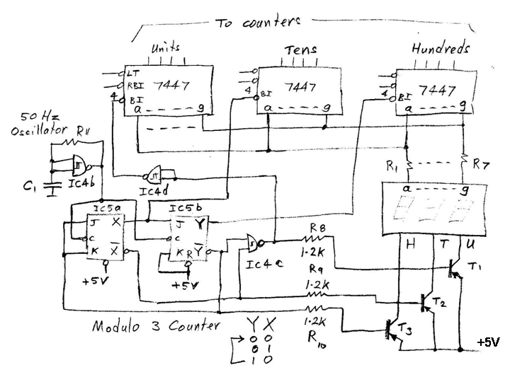

Now I understand. I had downloaded the display data sheet but did not study it in detail.
The display is meant for multiplexing.
In order to do this, you will need another IC (a flip flop) configured as a Modulo 3 counter, 3 transistors and 3 (possibly 6) resistors.
You will be able to employ the currently unused gates in IC4 as a part of the system.
I'll design it for you later and post tonight.
EDIT
Here is a multiplexer to drive your display.
You're lucky that the 7447 has open collector outputs. This allows you to connect the outputs in parallel. Some 7 seg drivers don't have o/c outputs.
IC4b operates as an oscillator. If R11 = 100k and C1 = 100 nF, then it will oscillate at about 50 Hz. The frequency is not critical, it just has to be high enough so that the display does not flicker.
50 Hz implies a cycle time of 20 milliseconds (ms).
So each display is turned on for 20 ms in sequence, ie. only one display is "energised" at any time, but it is so fast that they appear to be all on simultaneously.
IC5 is configured as a Modulo 3 counter. The count sequence is 00, 01, 10, 00, etc.
When YX = 00, the output of IC4c is low so T1 is turned on and the output of IC4d is high therefore the units driver is enabled (high on BI) so the units digit is "energised".
When YX = 01, the Tens driver is enabled and T2 is on so the tens digit is "energised".
When YX = 10, the Hundreds driver is enabled and T3 is on so the hundreds digit is "energised".
The transistors T1 ~ T3 can be any PNP transistor such as the BC327, BC328, BC556, BC557, etc.
Resistors R1 ~ R7 need to be lower in value to compensate for the multiplexing. I suggest you test it first with whatever resistors you have installed, but the brightness will be low.
Once you have it working, install resistors of about one third value, eg. if you currently have 470 Ohm ones (and if the brightness was OK before building the multiplexer), replace them with 150 Ohm.
IC5 is a 74HC73. Let me know if you can't buy one of these and I'll suggest alternatives.

Sweet, I will try to get my hands on the new parts. Would it be easier to just get three new displays, single digit type? I can probably get them at the local Radio Shack. This would mean I have to use 21 resistors but I bought that many any way.

Yes, it would, but it is your choice.

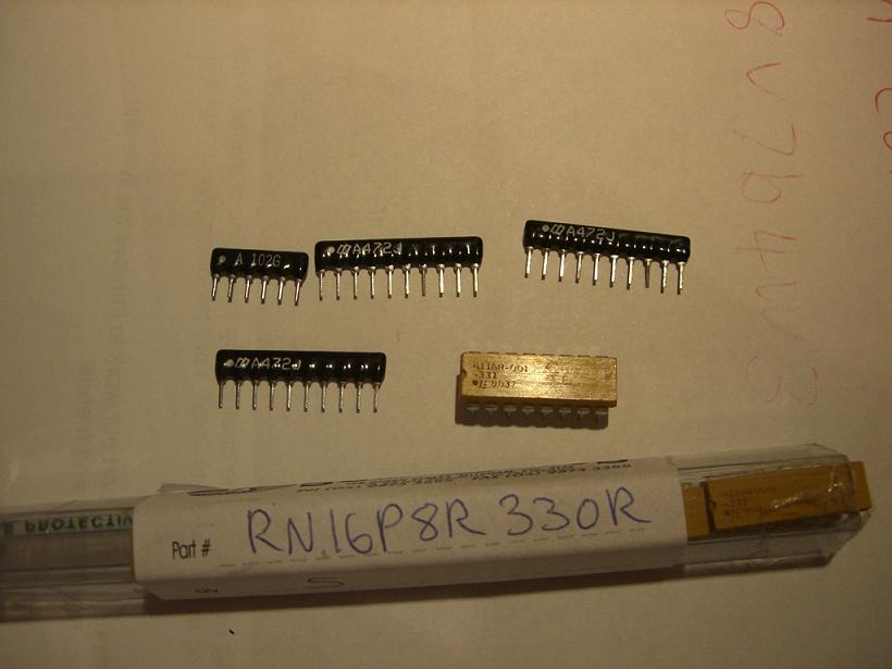

I don't know what your Radio Shack sells, but I can buy resistor networks very cheaply at Semtronics. Semtronics sell electronic parts to industry.
They come in 2 versions, SIL & DIL. The DIL ones look like an IC. This would make it smaller for you.

I really like the idea of the resistor networks. Can you give me a part number for a dual in line type? I will use the regular resistors for now so that I can play with the value to get the brightness I want.

The photo shows some SIL resistor networks that have a common - the dot of the LHS. You can buy others that have individual resistors in them.
The DIL is a 330 Ohm one. You can see the number on the tube that they came in.
The Australian company JayCar have a good range of parts (but not resistor networks) a web site and mail order outlet in the US/Canada. See www.jaycar.com, email techstore@jaycar.com, US phone number 1800 784 0263.
