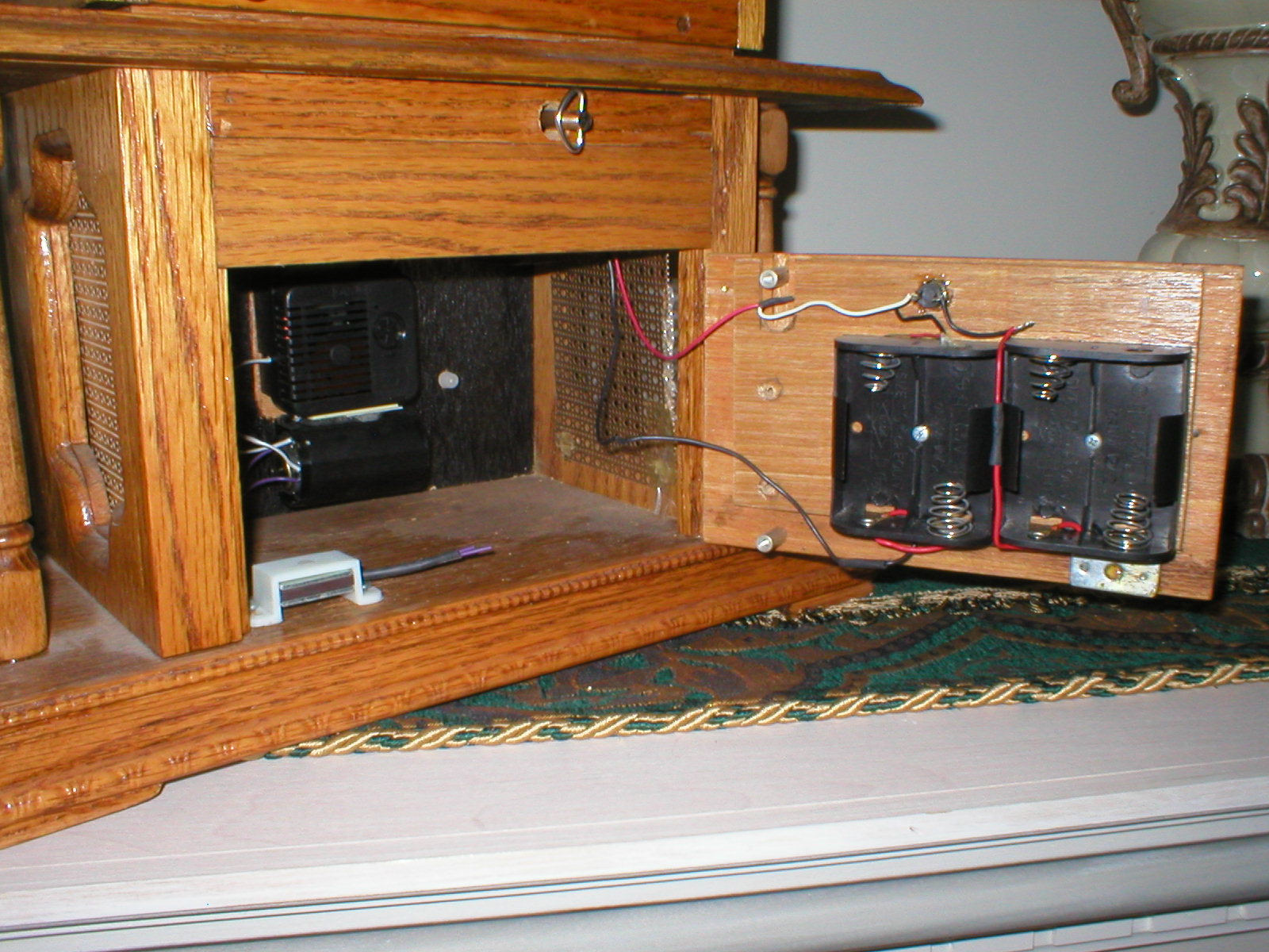

Put a .001µf cap from pin 4 to ground if the retriggering looks like it could be an issue. Are you running long wires to the opto on the clock, or is the music box very close by?

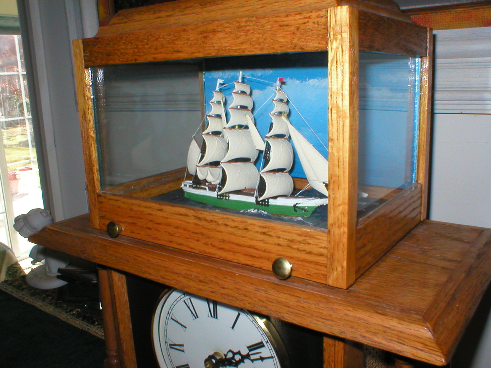

the wires won't be no more than 6" long. i was planning to run from the timer ciruit to the music movement with a 4wire phone jack and plug. (see photo of prototype and back of cabinet)
Im hoping i'll get the opto sensors this week so i can put it all together.

That looks terrific! I'm digging that ship on top. Does the music box play nautical tune?
yes, it plays "over the waves" or "anchors aweigh" but my idea for these clocks is that the scenes can be changed (along with the music) you can have a winter ,summer, ship with lighthouse etc. and they are "animated"
the ship "sails". cool huh?
Yes, very cool! I was HOPING you would say the ship was animated!
