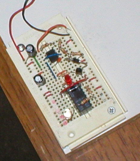

Could use assistance on a timer project
another breadboard view
i have attached another view of the braedboard showing the tranisitor better

Are you using the red wire from the battery for + or -? Should be +, but you have it hooked up like it's -.
sorry, no i'm using two 9v battery clips together so that reverses the color code on one. blk is + and red is -
So what happens when you short the collector to emitter with a wire? Does the relay pull in?
when i jump the col emitter the relay goes on and stays on until i shut it down
could i be using a pnp instaed of an npn markings are bc540a
i changed the 555 to a new cmos one (my last one) no relay. when i jump collector and emitter relay energizes but releases when i remove the jumper
No relay, but the relay energizes?
by "no relay" i mean nothing happens when i turn on the circuit and bring pin to vcc. i'm wondering iof i could run this circuit on 12 volts. nothing would burn up would it?

What is the resistance of the 6V relay coil?
Pins 2 and 6 don't seem to be connected to that cap, check that.
pins 2 and 6 go to the 470k (replaced witha 10k) then a 1k then the diode connected to pin 3. pin 7 is connected to the 1k then 15k then 100uf cap
Take another look at what else the cap is connected to.
