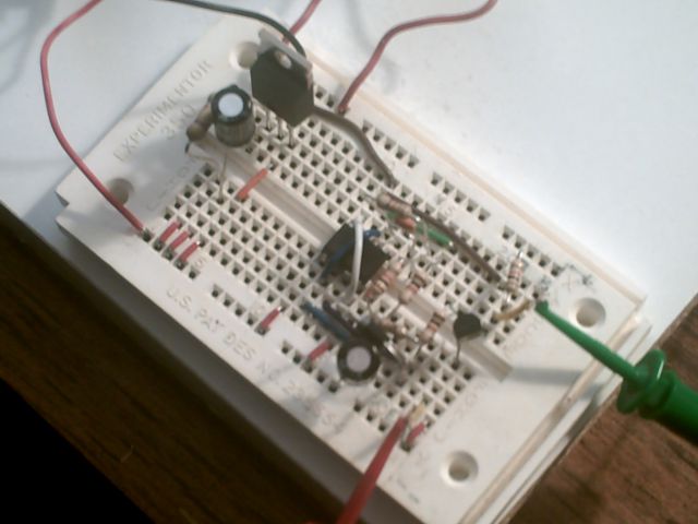

thanks for the reply. i took out the led and put a meter across the 2222 to ground. i get .97 volts to .1 volts (is that a cap discharging? i checked my connections then took a reading from the mosfet discharge to ground. i don't get any reading now. replaced the mosfet.. still no reading. i'm attaching a photo of breadboard.

Your circuit is a mess:
1) The Mosfet's source is not connected so it won't work. It needs 10V on its gate to conduct anyway and your circuit gives its gate only about 5V.
Why did you use an expensive 450V Mosfet?
2) Your 555 and transistor do not have a power supply so they will never work.
3) The 1k resistor that is the collector load of the transistor will not turn on the relay.
You are a steely-eyed rocket man, audioguru. I mentioned the one about the collector resistor, but missed that wretched mess with the MOSFET and blatant lack of a supply for the 555 circuit.
In addition to the floating source (or incorrectly connected drain and missing supply voltage) AND the dismal 20ma of on-state current it could conduct with Vgs = 5V, it will still never work because it's an N-channel device trying to work as a source-follower off a very inadequate voltage. You either need to get a different N-channel mosfet and connect it from ground up, or use a P-channel mosfet there and pull its gate low.

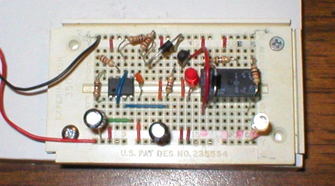

i changed the shematic to correct connection between the transistor and the relay. I breadboarded it and when connecting pin 4 on 555 to vcc nothing happens with the timer.

Need more to go on than that. Measure some voltages.
Those are good for a start - from that, your transistor should be on. It's off. Why?
1. It's burned out
2. You have it hooked up wrong.
Is it getting hot?
3. The relay diode is backwards
4. The relay current is too high
Short out the collector and emitter with a piece of wire. Does the relay snap on?
Looks like you have the drive circuit completely upside-down. The emitter's on Vcc, relay on ground.
The transistor has a base current of 4.3mA so it should be able to drive a 144 ohm relay coil.
Maybe you have the collector and emitter pins of the transistor connected backwards?
Do you have a high current ordinary 555 or a low current Cmos one?
How many ohms or what is the current of the relay's coil?
the relay coil is 115 ohms. i had a cmos 555 but replaced it with an ordinary
(i don't know how to test them) way back when this one was working. the relay works when i put a jumper across collector and emitter. i replaced the 470k pot with a 10k resistor to shorten delay.
