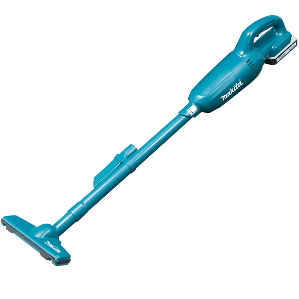

- I saw makita one without battery for 30$, looks good but its 35W !! Another one with battery is 135$ but only about 100W total power with only 25W of suction.

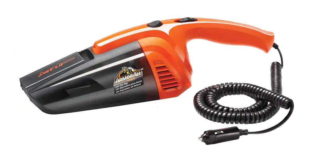

2) Corded vacuum cleaner, probably 12V car one:
- dirt cheap, you can get a 600W model for 10$ second hand
- 600W can be misleading (my water vacuum says 2500W but its actualy using 800W) but still, its a lot more than 35W or 25W.

Yes... 600W would be near 60A after voltage drops. A normal car "cigarette lighter " power outlet is only fused at around 8 - 10A so 100 - 120W is the limit for anything running from them.
It could be 60W with an extra zero "accidentally" added?? - I've seen that scam quite a bit.

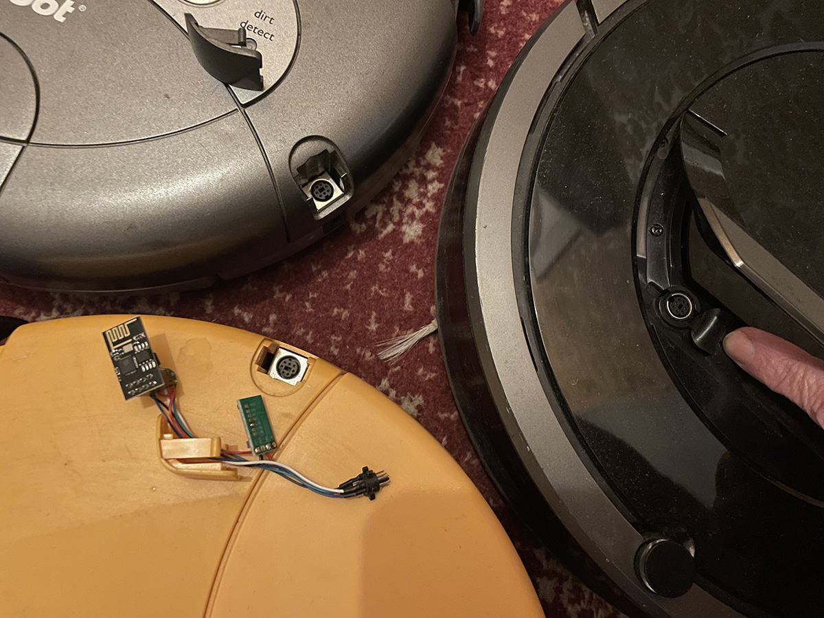

Or, why not search ebay and go full techno-geek on the problem?
I've got all these as non-working over the last ten years or so, and they all had simple faults & now work.
All but the very oldest one also have interfaces that you can connect in to to monitor or remote control them - the ESP-01 dongle is one I'm using to test software extensions, it already works with my home automation system.
Or just press the Clean button..

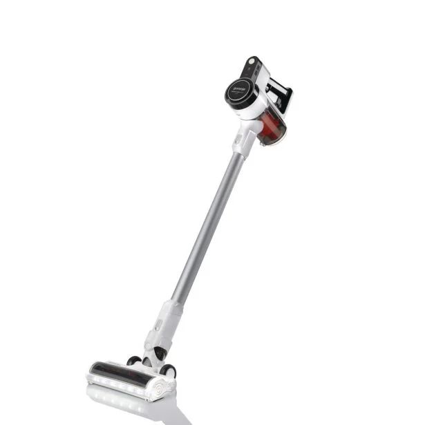

I was thinking of giving this a try. I can get it new for 100$, how bad can it be ? Cant be worse than now when i vacuum once a month. There are some specs on the link from amazon. What do you think ?
Hmm, couldnt see reviews on that link i sent on amazon. And thats the only one i found on amazon, others have similar name but look different. Anyway for that money and with 2 year guarantee, even if it dies after 2 years i dont care. Most things i can repair, except obviously motor. If i can still get it at that price, im gonna give it a try ! At least i will be able to see how it performs and see if there are any serious drawbacks or something, that would prompt me to buy a more expensive one.
I will take a close look to this vacuum though. Because most of the ones i found, even on highest performance setting they work for like 20 minutes, which is 15 more than i need. Meaning i could theoreticaly get much more suction power if i were to drive it at such power that it would run out of batteries in 5 minutes. Obviously i cant do that with this one, i need stronger motor. But i might just inspect this one, see the drawbacks and maybe in the future assembly my own unit perfectly to my liking. Like ultra big HEPA surface for less air resistance and a strong motor.
