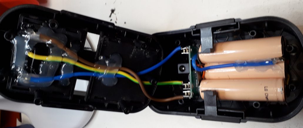

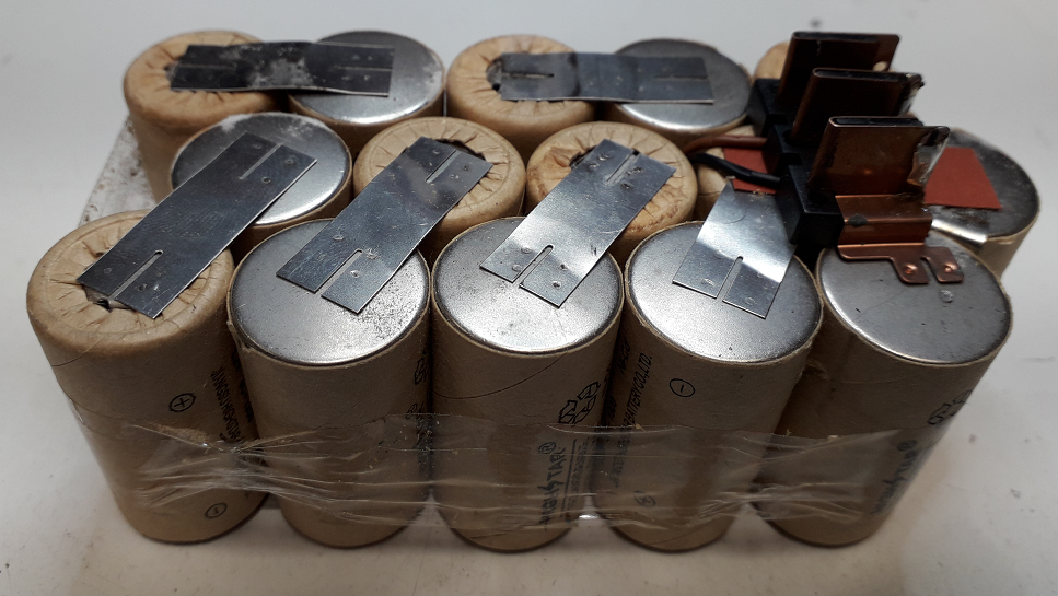

OK, I've got a collection of cordless power tools that use the same batteries - but they are now 11 years old, and the batteries (I have three batteries, and two chargers) are now pretty useless, as you would expect. The tools themselves are perfectly fine.

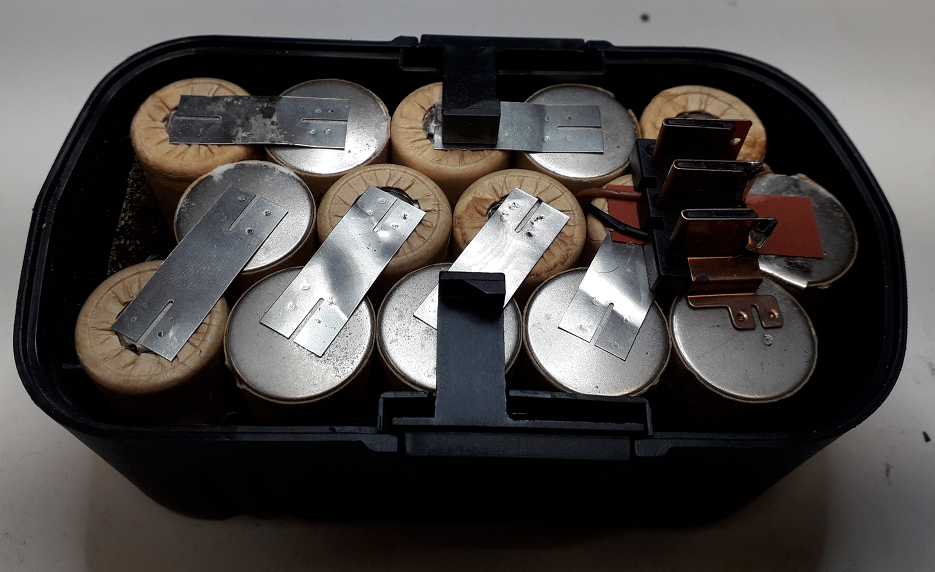

The batteries are 18V 2AH and use NiMh half-C cells, with the input/output connector spot welded to the top of the batteries themselves.
These are the batteries removed from the casing, the thin brown and black wires got to a diode (I presume it's a diode) as a temperature sensor.
I was considering ordering some replacement half_C cells, but 45 of them is a lot of money, and they still aren't very good batteries. So as I've got a pile of 'rescued' 18650 Li-Ion cells I decided to use those (we replace a LOT of batteries at work, both when they are faulty, and as regular service work on request - so I have a decent supply of them - I can't bear to see them thrown away!). For the 18V I needed 5 cells, and I hoped to be able to squeeze 10 in to double the power - but it was a little tight, so I keep with 5 instead (which incidentally is exactly what our new DeWalt drill at work uses).

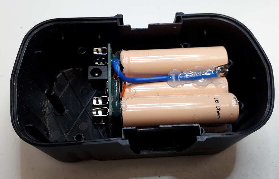

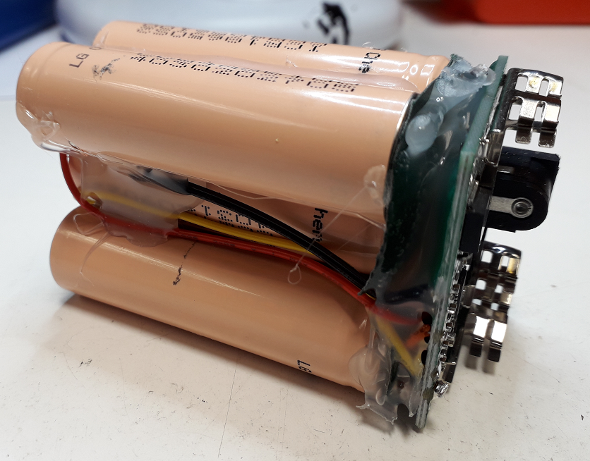

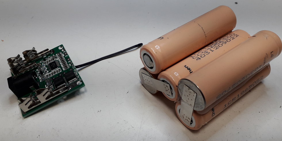

So using our battery spot-welder I built them up in a pack of five cells, and ordered some suitable battery protection boards from China.
This is a completed battery pack, the black wire you can see is the temperature sensor from the protection board, which is glued to the side of the pack. Plenty of hot melt glue holds everything together.

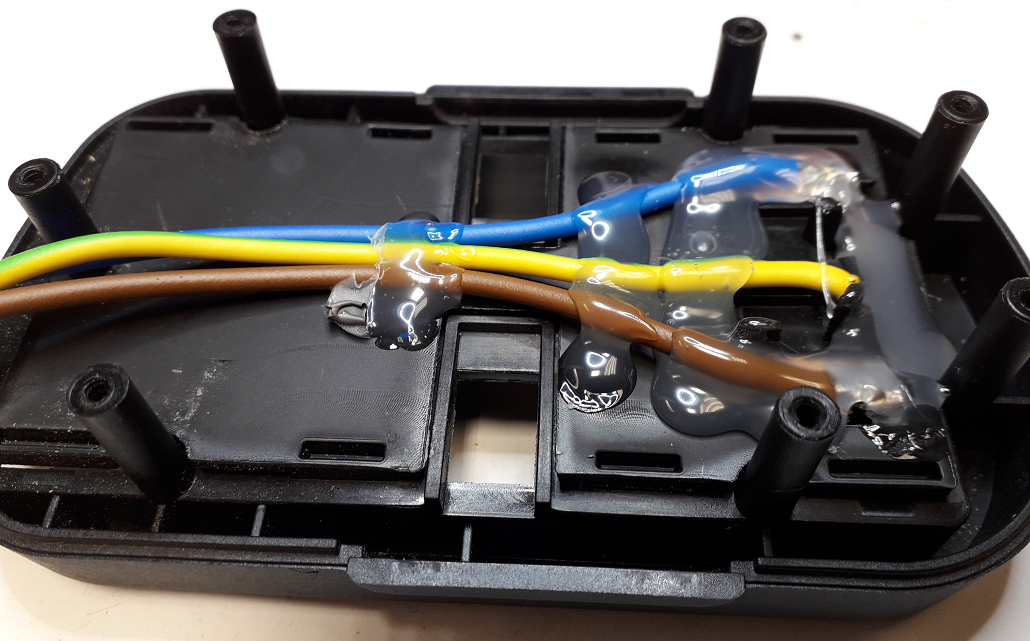

Next was the problem of connections, so I used more hot melt to fasten the original connector in place in the top, and ran thickish wires from that.
The new battery pack was hot melt glued in the old case.
And the wires from the top soldered in place, to the sides of the metal clips you can see above on the protection board.
So that's the batteries done - next job will be to rebuild the chargers - these use a conventional mains transformer, and an LM324 quad opamp for the charge controller - the new pack has separate charge+ and output+ from the protection board, so I connected the middle pin (used for the original temperature sensor) to the charge+ connection.
I've got some small Chinese charger boards, adjustable constant voltage and constant current, so I'm planning using those, and probably a PIC to monitor charge status - I haven't really decided yet, and I've yet to try charging the packs 'manually' to see what the protection board does as regarded charging (I pre-charged all the cells before building the packs).
Incidentally, the old batteries weighed 1056gm, the new ones only weigh 486gm, so less than half the weight.
Nice little upgrade, the batteries were free, and the protection boards under £2 each.

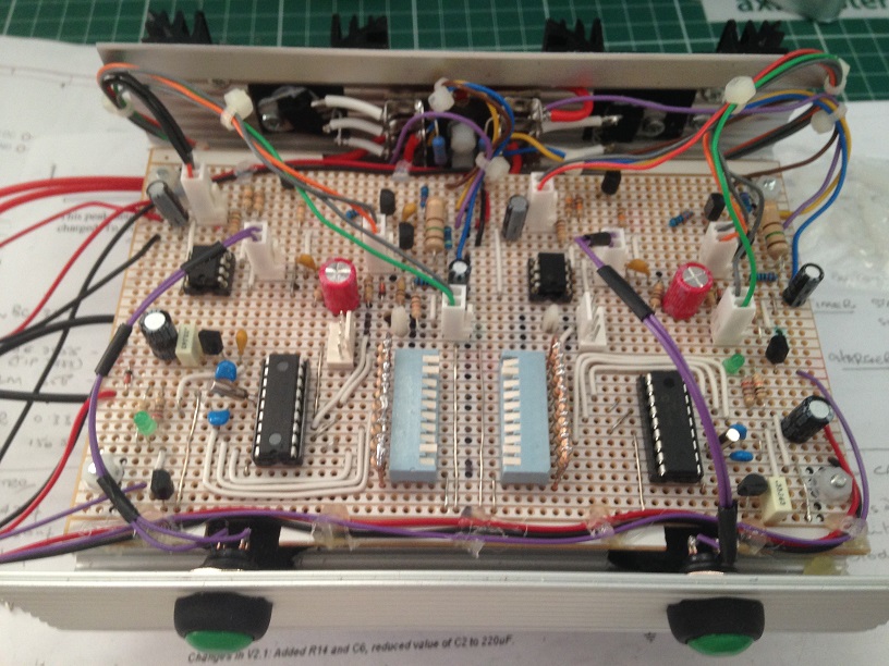

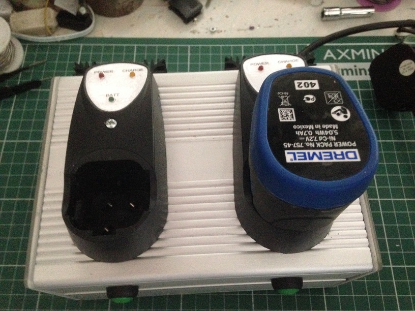

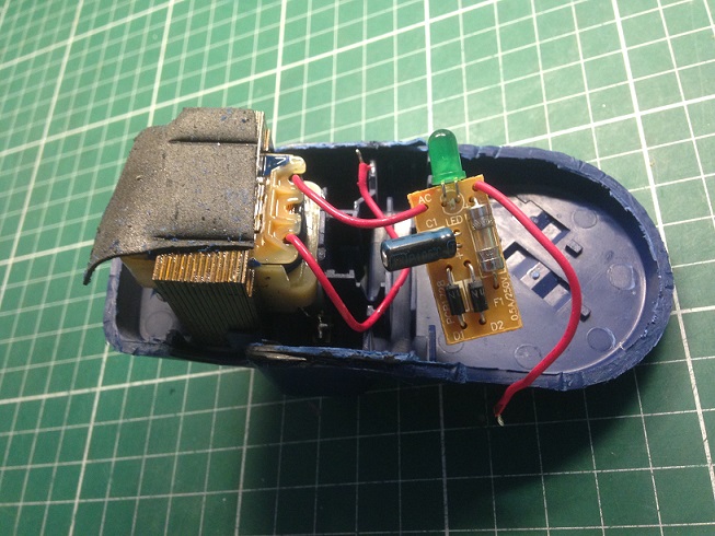

Hi Guys
I've just completed a similar project starting from the opposite direction.
I'm a great fan of the cordless multitool, in particular the Dremel variant - I find them to be excellent for small detail drilling, cutting and sanding. However, they have a significant drawback in the battery charger. The battery block comprises 2 sets of 3 700mAh 1.2v AA NiCD batteries connected in series with spot welded tags, offering either 3.6v or 7.2v depending on the position of the switch.
The charger however, is a problem, taking up to 5 hours to fully charge a unit and no protection if it remains powered after a full charge is achieved. I started out with 3 batteries and 3 chargers but managed to 'cook' first one, then two of the chargers by forgetting the time and leaving them powered. Then a couple of weeks ago, inevitably, I did the third one !
Since I don't have your expertise in designing my own circuit, I search the net and found a scheme to charge NiCD batteries using a CC/CV circuit and a Peak Detect' system that impressed me. Apparently, NiCD batteries once fully charged and subject to a temperature rise lose a little voltage, as as little as 7mV perhaps, but this circuit detects that voltage change and uses it to turn off the charge circuit.
I subsequently built two of these chargers, mounted side by side and just in case the peak detect doesn't work, I added a PIC controlled timer which can be adjusted to cut the power to the charger after a set time between 5 mins and 5 hours.
This is the finished charger unit ..
.. .. .. .. note the old Dremel Charger case, butchered with a hacksaw to provide a suitable battery mount;
.. .. and this is the circuit board .. .. ..
.. .. .. .. the 'spaghetti' seen disappearing off to the left is connected to a pair of timer tripped relays.
I have run this charger several times now and the peak detect protection seems to work very well.
As some of you will recall, I'm very much a novice and the validity of the peak detect idea, apart from working, is over my head but the principle was checked by another expert ETO member and proved to be accurate and correct. I've no idea if a similar principle would apply to NiMh batteries, but it might be worth a look.
I would like to acknowledge the intellectual copyright of the circuit to Mr BH Abbot of New Zealand.

Very nice work, MM :) I wish all my builds were so tidy!
Can you supply a link to the design?

Pretty nice, and quite ambitious.
Yes the "minus delta V" technique is one of the main end-of-charge detection schemes. There are times it can fail though such as when the battery gets old so they always include a back up method like maximum time which i think you covered. There is also teh temperature rise method which measures the temperature rise above ambient and turns off when the rise is too much.
The minus delta V is also less for come batteries than for others so for some it is harder to detect, but the higher the charge current the higher the delta V when it gets fully charged.

Hi Guys
The design for the charger is here **broken link removed** or here http://www.bhabbott.net.nz/
The timer is a standard PIC based timer I've used for several projects from Picprojects.org .. I think he's a member here.
I was very surprised and a bit horrified when I first opened a failed Dremel charger and saw what was contained .. .. .. .
.. .. .. .a bit of a stark contrast !
All new tech to me, but so far very effective in operation.
