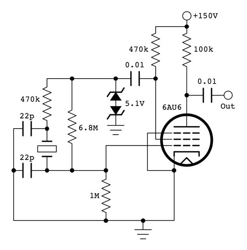

I found an old appnote on using these crystals with a FET. A triode isn't that much different. So I was able to adapt the circuit.
Works like a charm, but I had to add the back to back zeners to limit the voltage in the feedback loop. Without it, the voltage builds up to many tens of volts, and then the crystal pops. I wasn't fast enough disconnecting the HT line one time, and so I blew one crystal.
Further update:
An even better solution uses a pentode instead of a triode, with the feedback taken from the screen grid, and the output taken from the plate.
With the output and feedback isolated from each other this way, the plate load can vary widely with no effect on the feedback level, and the oscillator remains completely stable. Plus, the plate can deliver a much higher output voltage & current this way. These pentodes are an amazing invention. I wouldn't be surprised to see triodes become obsolete. :)

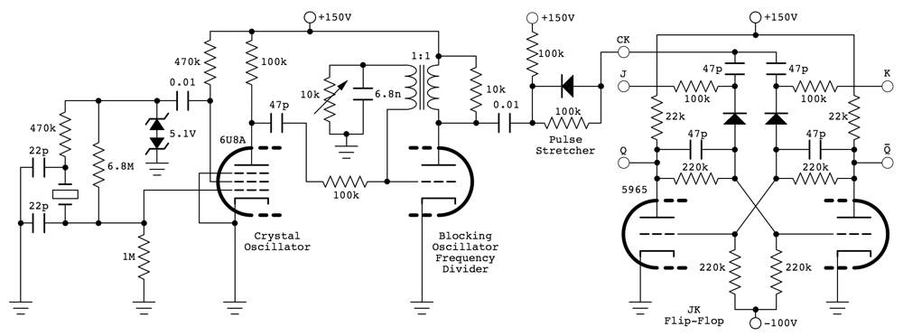

Here's an update of the circuit after tonight's festivities. The diagram now includes the blocking oscillator that's used as a frequency divider, and the JK flip-flop.
I wish everything worked as well as the blocking oscillator. Its pulse width is set by the transformer characteristics, and the repetition rate by the RC network. By adjusting its RC timing network values, it will divide the crystal oscillator by all kinds of different values, including non-integer values. I have it adjusted to divide by 3.5 at the moment, so that it produces 10.857142 kHz from the 38 kHz reference, which is close to the 10 kHz frequency that I'll eventually be working with. The transformer is one that I removed from a dead switching power supply. I don't know much about it except that primary and secondary inductance are both 20 mH, and turns ratio is 1:1.
The flip-flop is now working, but it was a bit tricky:
- The -100V grid bias is fairly critical. I found that if it varies by more than ±5V, it stops working.
- The blocking oscillator puts out a very good negative going pulse with very fast leading edge which is ideal, but I found that the pulse duration was too short to trigger the flip-flop. So I added the pulse stretcher. This still gives the fast leading edge, but lengthens the pulse enough that the flip-flop switches reliably.
The J & K inputs appear to work, but more testing will be necessary. I'm concerned that their setup time may be too slow. The flip-flop will be used to sample and hold the output of the VCO (yet to be designed), and so the J & K inputs will have to react quickly.

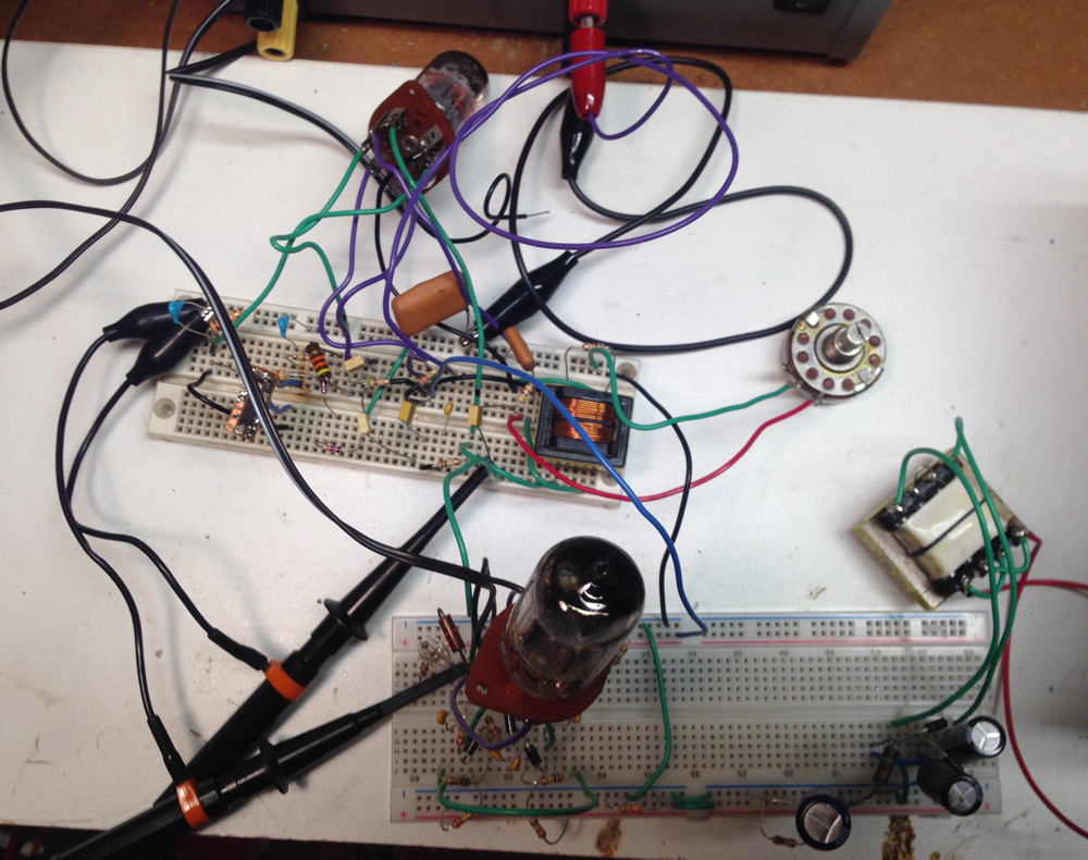

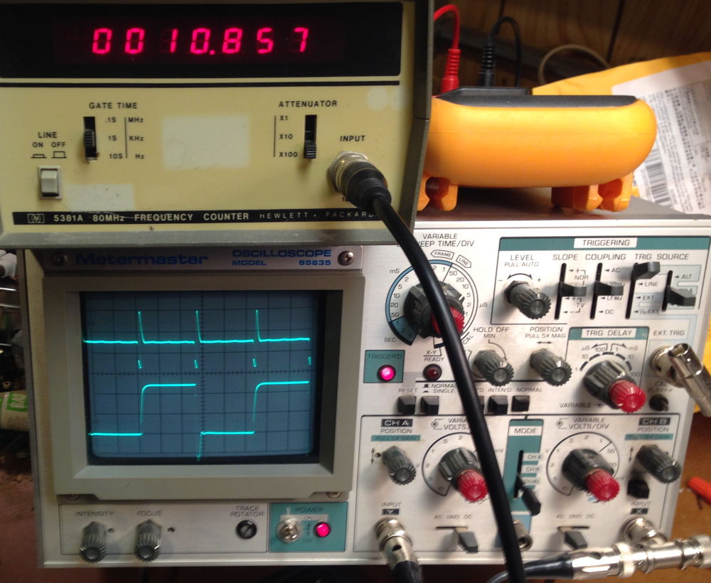

Pictures are attached. A couple of scope traces are included. In the first one, the scope shows the 38 kHz crystal oscillator waveform in the lower trace, and the 10.857 (divide by 3.5) blocking oscillator output waveform. Note that dividing by a non-integer number is not recommended, because it requires very fine and critical adjustment of the RC network. Integer division is fairly non-critical.

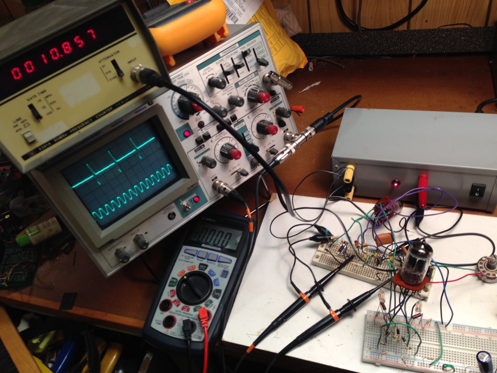

In the next photo, the scope shows the blocking oscillator trace again (upper), and this time the lower trace is the output of the JK flip-flop, which is triggered from the blocking oscillator output, and is running at half the blocking oscillator frequency. If the J and K inputs are tied to logic 1, or left unconnected as they are in this case, then the output alternates state on each trigger pulse.

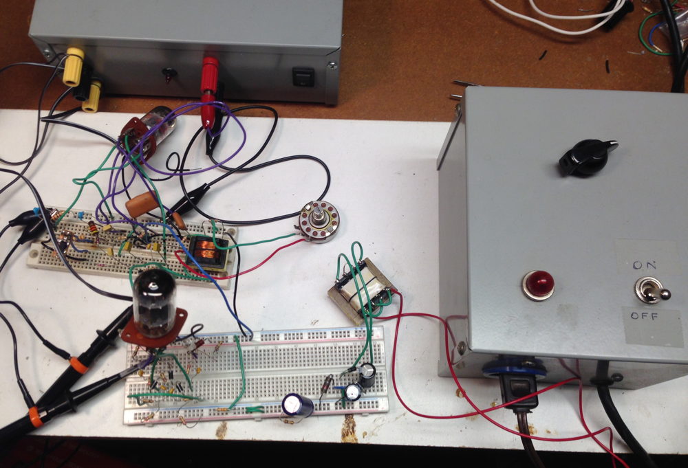

Below are closeups of the breadboarded circuit. The upper breadboard is the crystal oscillator (left side) and blocking oscillator (right side). The 6U8 tube is lying on its side above the breadboard. The lower breadboard is the JK flip-flop, and the rectifier/filter for the -100V bias supply. The bias supply transformer is powered from a variac (grey box on the right) so that I can adjust the bias voltage accurately. The main power supply is the grey box in the upper part of the photo. It supplies both +150V and 6.3VAC for the filaments.
