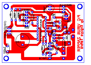

At this point, I think the problem is more likely in the circuit as built. Ergoye should post the schematic and board design (if available) for what he thinks he has and an actual picture as assembled.
this is my PCB...
it looks fine but still i couldnt find where the problem is.......hopefully the hex file! because the out put must be 2.5kHz NOT 1.6kHz. IN MY CASE THERE IS NO OUT PUT AT ALL ...the out put voltage also must be half of the battery voltage it is reading in my case 0.79V. it makes me creazy manoman.:mad:
