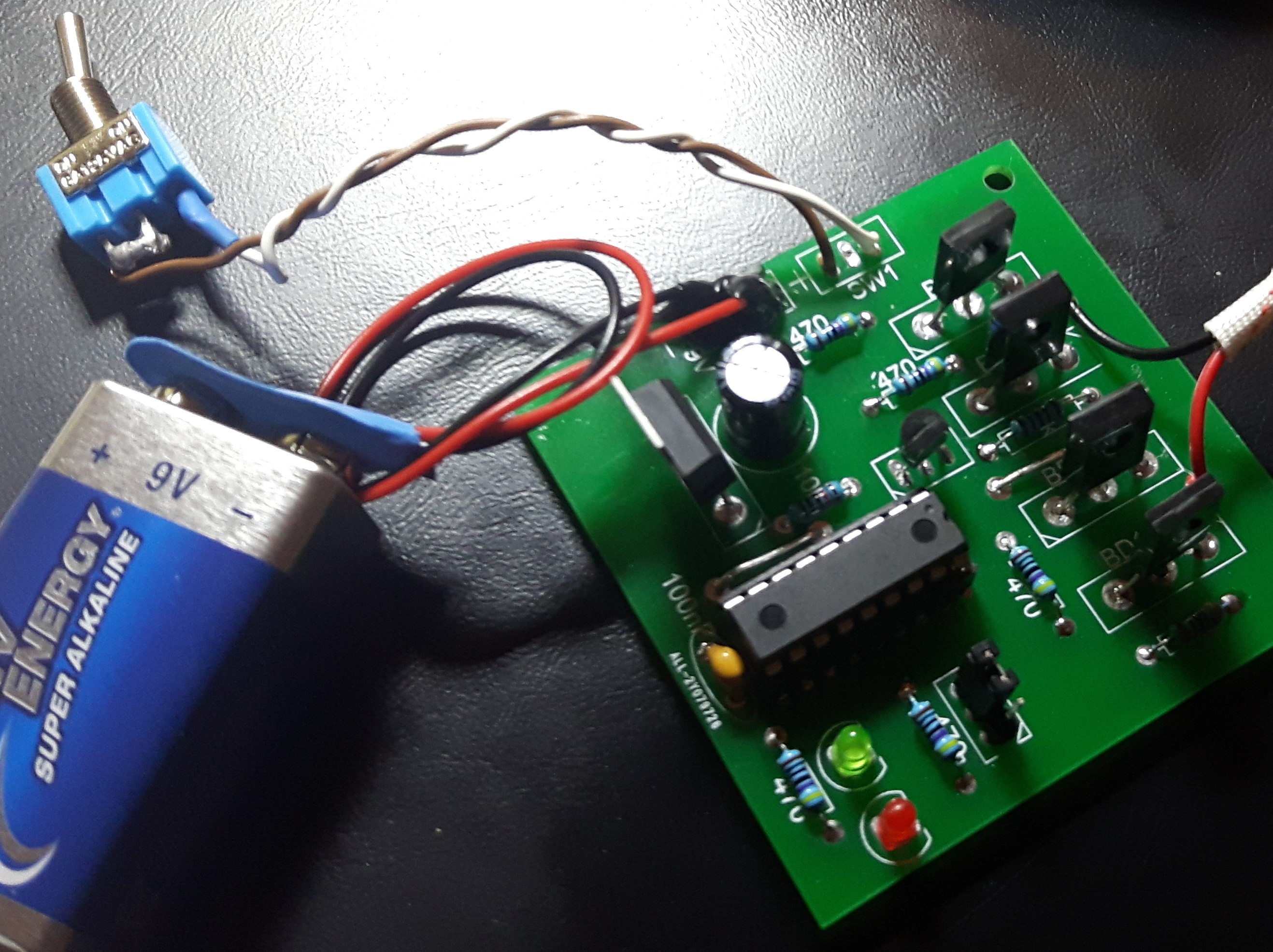

Oh...dear Friends....is there a difference b/n PIC16F627...and ...PIC16F627A ..??? because the instruction says that use PIC16F627....But i am using PIC16F627A. may be this is the problem????:facepalm:
here is what i am building.
That looks already built to me. What do you want us to do for you?
Do you have an Assembly program for the chip you want to program? If you will post the code for the 16F627 in ASSEMBLY, I will convert it to code for the 16F627A for you. No big deal. Your posts are, as a whole very confusing.
