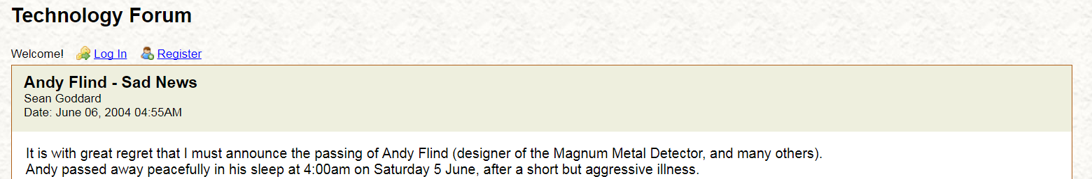

Dead Battery?
Andrew James C. Flind was born in 1944 and died in Devon, Somerset, England at age 60. That is quite young by today's standards. Maybe his device had a dead battery.

His unexpected death so shortly after making and presumably using the device(s) wouldn't encourage me to try doing the same thing. His untimely death from a rapidly progressing illness despite easy access to the device may the experiment that was needed to debunk it. Unless, the battery died or maybe one of the LED's was in backwards.
Moreover, the "theory" of operation -- disrupting otherwise undetectable intestinal flukes that "most people" have -- provides an excellent basis to predict far more harm than good.
I would be very interested in reading the "cause of death" on his death certificate. It is on file at the government offices, but I am not so interested as to pay the fee for its retrieval that a foreigner must pay.
