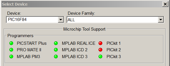

I found it easier to load the hex file into the PICKIT2 software and look at the file in that display. I have forgotten the exact structure for hex file and was too lazy to find documentation on their structure.
Les.
Easier with a PK2? Not familiar enough with the PK2 to know whether it operates identically to the PK3. They are certainly different.
I used a PICStart Plus last time I programmed a 16F84/84A.
As for messing with .hex files, I found this crutch particularly easy to use: https://www.fischl.de/hex_checksum_calculator/
There are certainly others out there. That one was just quick and simple. Enter an incorrect checksum and it will give you the correct one.
