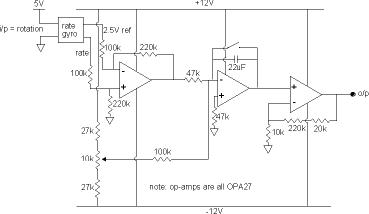

Hi - I'm involved with a project to design and devlop a fully autonomous hovering platform as part of a 4th year engineering group project.
I am dealing with the sensors, more specifically rate gyros. I am feeding the output from these gyros into a differential amp which outputs a +ve or -ve dc voltage dependant on +ve or -ve rotation. this signal then goes into an integrator which integrates the rate to give a angle of rotation. This signal is then fed through a non-inverting amplifier to bump up the signal to give +-5V for +-20 degrees rotation of the platform. The problem I have is that the output signal is drifting too much and I can't control it well enough. The strange thing is that I have managed to get the the output from the integrator to have negligible drift over minutes and also, the amplifier only has a gain of 24 (not massive eh...). I know it is pretty difficult to see without a circuit diag but has anyone got any ideas??.....I am not the best at electronic design as my degree is in Engineering and Management......thanks in advance.

Can you determine in which direction the drift is going? i.e is it positive in relation to the input or in opposition to the input ?
With a gain of 24* any change on the input is going to appear quite large, so what is the magnitude of the drift from the integrator?

I have managed to reduce the drift on the integrator to a matter of approximately 5-10mV over a period of a minute or so. This should be sufficient for now as we are only really planning to have the platform controlled over a minute or so due to problems of yaw and precesion.....
The drifting output of the amp follows the slight drift of the integrator output although it kind of oscillates up and down too....
I will try to attach a circuit drawing on another reply which may be more useful....

attached is a jpeg of the circuit diagram at the moment. The 22uF cap is a massive non-leaky polyester one.....apparently more accurate for an integrator and all the op-amps are OPA277 manufactured by Texas instruments....their datasheet is located at: **broken link removed**.....
I hope that this is more use and thanks again for your help...much appreciated....give me your details and I will reference you in my report...

I think you need a chopper-stabilised op amp such as the ICL7650 in your first stage. You'll get the details from google.
This type of amp is constantly checking its own drift and correcting for it.

however, the op-amps which I have been using where selected precisely for the reason that they had ridiculously low drift.....They in fact seem to have the same specs as the ICL7650 however, they don't autocorrect themselves I don't think as they are not actually chopper stabalised.
Do you think that I should try to use the same opamp on for the non-inverting amp on the output of the integrator??

Yes, I would put them in the first two stages. They are very effective. I was once experimenting with making a miniature water flow meter. The type where you pass water through an alternating magnetic field and measure the induced current with two probes.
I couldn't get the magnetic field powerful enough, but the probes and amp worked a treat. With that amp I could actually measure the galvanic difference of different grades of stainless steel in the probes!
op-amp drift
I've now come across my old circuit notes. I see tha amp I originally used was the LTC1051, a dual type with no external switching capacitors. Its stated typical input offset is 0.5uV, and its typical drift with temperature is zero. So it has a better spec than the other one I mentioned. But the max supply voltage is 16.5V, whereas you are using 24v - though you should be able to get around that.
There is a quad version LTC1053.
BTW, I just realised you have gain in the output stage, so on second thoughts it may be better to use these chopper types for all stages.

Could this be a thermal drift problem ?
You say the output amp and integrator drift in the same direction...
You can disprove this by pointing a hairdrier at the circuit - if it makes no difference then I'm wrong, if it does upset the circuit then at least we know the cause of the problem.

but the idea about the hairdrier is a good mechie - I'll try it.....but I dunno if it is a drift problem as the op-amps I am using are pretty reliable I think in terms of drift - specs below.....some of the lowest I could find....also - was originally looking for amps which could take +-12V due to some platform constraints....but could be got around if needs be....

thanks again - I was also given advice by a friend that I should perhaps put decoupling capacitors of 100nF across the power pin pairs of each device (pin 7 to pin 4) but I'm not sure why or how it would help??

I think that I am going to to try to reduce the time constant of the integrator by using a lower value resistor - this will mean that hopefully I won't need so much gain on the output.....
