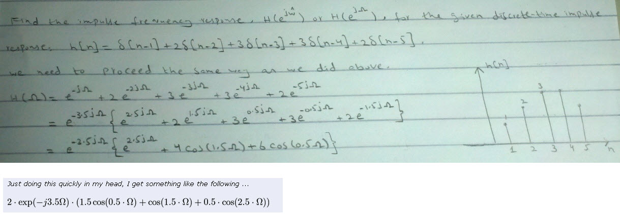

OK, so for the first issue, you have shown two problems which differ by a negative sign. Isn't a negative sign the equivalent of a 180 degree phase shift? So, if you say the first one is a phase of zero, then the second one should be a phase of 180 degrees. This was the very first point I was trying to make. Just because something is real, does not mean the phase is zero. It can be zero for positive numbers and 180 degrees (or -180 degrees) for negative numbers.
Please have a look here. Thanks.
To simplify the answer to trig functions, I would recommend the following on that problem. First, you will want to pair up terms with equal amplitudes, so that they can be combined. Then with each pair you need to factor something out, e.g. factor exp(-j 3.5 Omega).
Just doing this quickly in my head, I get something like the following ...
[LATEX]2 \cdot \exp (-j 3.5 \Omega)\cdot (1.5 \cos(0.5 \cdot \Omega)+\cos(1.5 \cdot \Omega)+0.5 \cdot \cos(2.5\cdot \Omega))[/LATEX]
I could have made a mistake, but you will get the point, I think.
I was trying to do it myself while you posted it and my answer is somewhat different. Please give it a look and let me know where I'm going wrong. I'm still not able to find some general method to align the exponential terms in proper order. Thanks.
Regards
PG

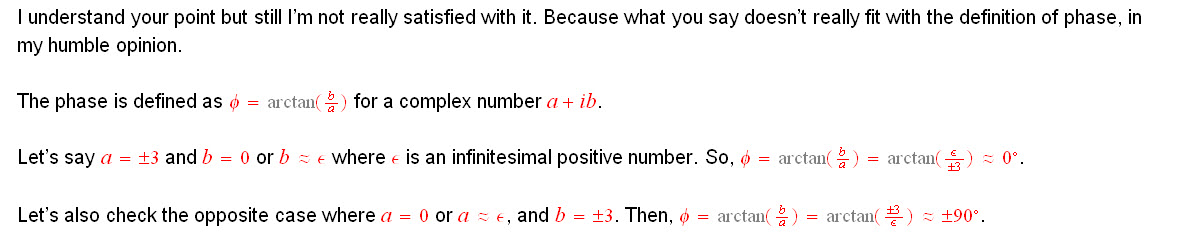

For the angle issue, you are relying too much on a calculator and not enough on your brain. The atan function has been defined to be a true "function" so that it only has one value on the y-axis for every value on the x-axis. However, atan(0)=0, pi, 2pi, 3pi ... or even -pi -2pi etc. This is the whole issue of needing the atan2 function that I believe I've mentioned before. This will give answers in the correct quadrant of the unit circle. So retry your calculations in Matlab with atan2, or just think about it.
You do have a point and I can see it now. Yes, we have discussed atan2 in the past. I think I get it now. For a minus real number, we can say that phase is 180 degrees.

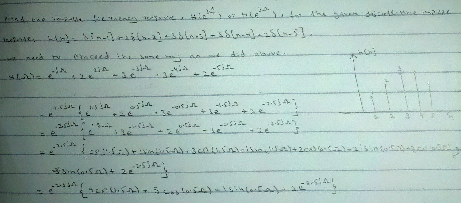

I guess I was doing a different problem. Sorry, I should have shown the starting point, to make it clear.
Thanks.
Please have a look here. It also contain the problem which I suspect you had in mind. Thank you.

So, what help do you want with it? If you want to check it, i'd say it looks correct. If you want to put it in a better form, I can't say that I see one off hand. Perhaps you might want to write it as 1+exp(j ...)(...), which would indicate an all pass system in parallel with another system in polar form.
This answer is not as nice at the others that you were able to show in a nice simple polar form. This is what I meant before when I said not all systems will simplify nicely. You can find other systems that look less nice than even this one. In those cases, perhaps rectangular form would look neater.

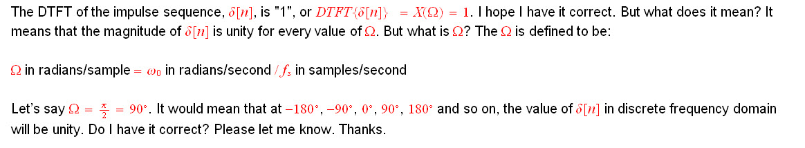

I would say you basically have this correct. The omega is a kind of normalized frequency and becomes an angle that spans a range of 2pi. Again, this relates back to the Nyquist sampling theorem which says that discrete time sampling at a particular sample rate, has an implied upper limit on frequency. The maximum frequency is half the sample rate. So the transform of the delta function is unity, which is a function that equals 1 over the domain of omega which spans a range of 2pi. Remember that, for continuous time signals, the Dirac delta function transforms to a value of unity over the domain -infinity to +infinity. So, you can think of discrete time as a kind of mapping. The infinite range of frequencies in continuous time gets transformed to plus and minus Fmax, where Fmax is the maximum cyclic frequency allowed by the Nyquist theorem.

I'm not sure I understand what the question is. I think I understand your point of view on these interpretations, and I don't see any problem with them.
In the first interpretation, applying an impulse function implies providing all frequencies at once with equal amplitudes and phases, and the frequency domain response shows the response of each and all frequencies. The second interpretation is like applying each sinusoid individually, or one at a time, and then the frequency response at that particular frequency is evident in the transform.
