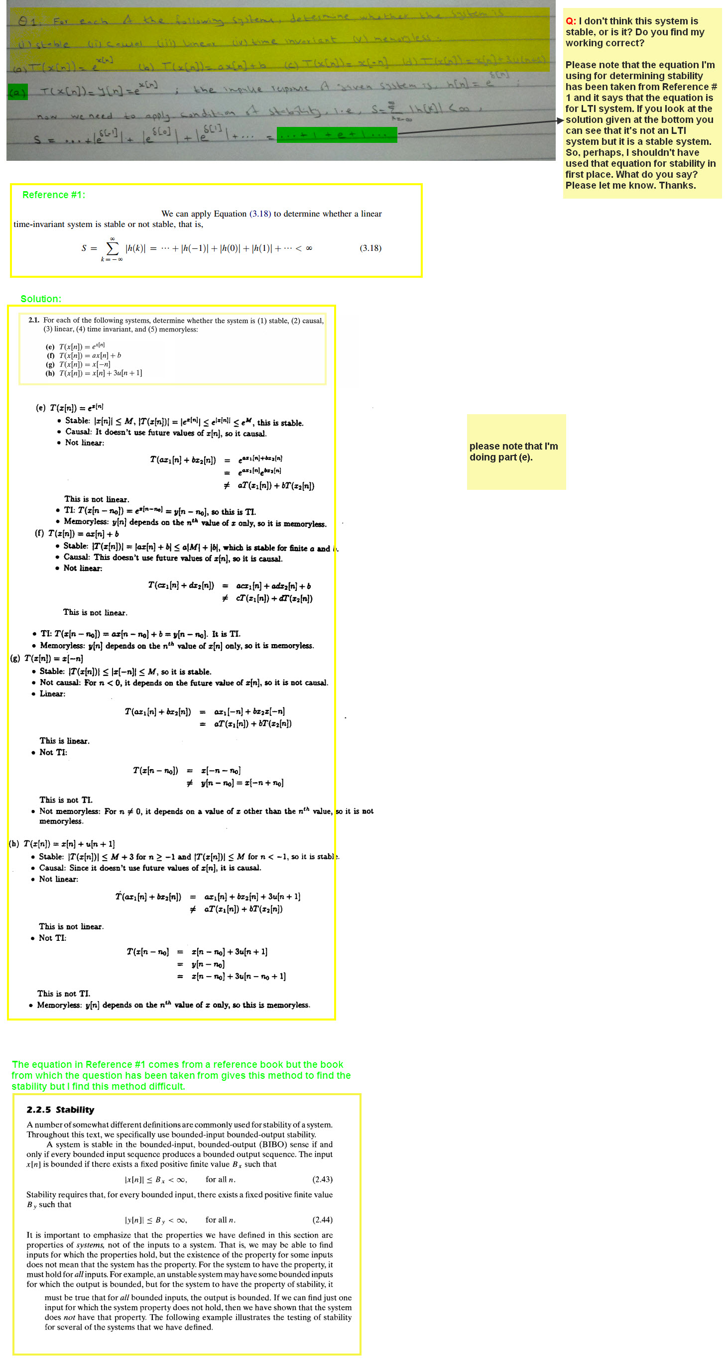

I don't think this system is stable, or is it? Do you find my working correct?
Please note that the equation I'm using for determining stability has been taken from Reference #1 and it says that the equation is for LTI system. If you look at the solution given at the bottom you can see that it's not an LTI system but still it's a stable system. So, perhaps, I shouldn't have used that equation for stability in first place. What do you say? Please let me know. Thanks.

PG,
This is a good question. I'm answering this quickly (2 mins of reading and responding), but this is a problem that requires careful thought and more time than I put in. So, I could be making a mistake, but lets talk it out and see if what I say makes sense to you.
First, you are correct to question the use of a rule for LTI system, when the system in nonlinear. So, throw the rule away in this case because it tells you nothing.

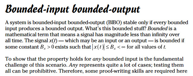

So, what rule do we use. The BIBO principle is a sound one I believe, so if you can find any bounded input that creates an unbounded output, then you would have proved that the system is unstable. So, try a simple example of a bounded input, for example, the step function u[n]. Will the output be bounded then?
I'm in a hospital waiting room while my wife gets an outpatient procedure. So, I'm bored and thought I'd continue on here. I'm assuming you are busy and didn't get to this, or perhaps you solved it no problem. But, just to finish the line of thinking, I'll continue.
So, above I posed the question of whether the output is bounded if the input is a bounded signal u[n]. There are two possible answers, so without answering it myself, let's explore the thought paths for each answer.
If you answer no, then you have discovered an example of a bounded input with unbounded output, and the system is unstable in the BIBO sense. Case closed - problem complete!
However, if you answer yes, you have not proven that the system is stable. This might be a good indicator that the system is stable, but it is not proof. So, if you are forced down this path, how do you prove it? Well, in general this might not be easy. You could keep searching for bounded input signals that result in unbounded output signals, if you suspect that the system is unstable, but if you suspect the system is stable, then you need a formal proof because failure to find an example bounded input that causes an unbounded output is not proof that it is stable in the BIBO sense.
Formal proofs may be easy for some systems and maybe less easy for other systems. But, we won't go down those paths unless needed.

I hope your wife is feeling better now. I wasn't busy yesterday. It's just that these days I feel some much sleepy. Like yesterday, I slept around 8:00 PM and woke next morning (or, before noon) around 11:00 AM.
You can say that I have solved it. I didn't think about it much. I followed what you said in the previous post and was able to get across though I understand what you are saying now. It was the same problem with Fermat's last theorem because for some many years no one was able to prove or disprove it. Thank you.

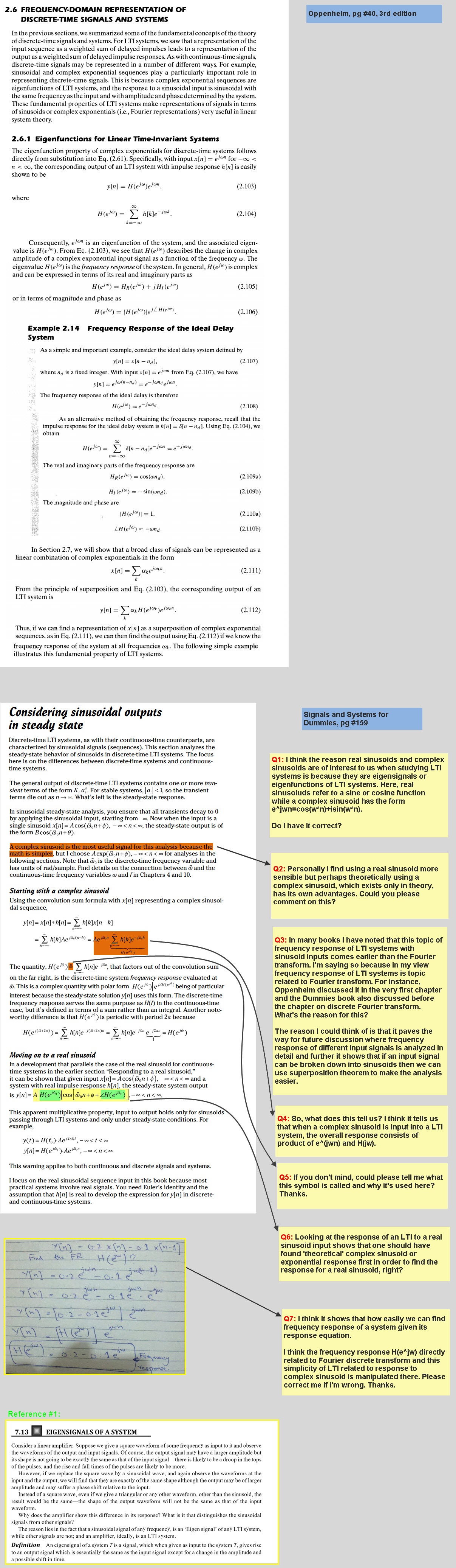

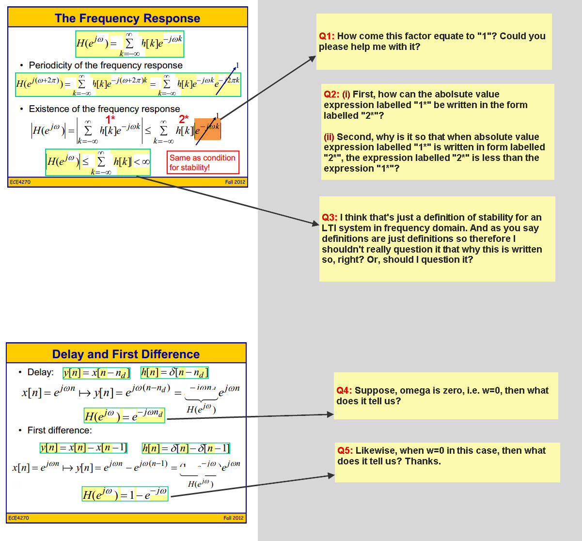

Could you please help me with these queries? It might look like so many queries for a single post but many of the queries are very simple as you will see. Thanks a lot for your help.
Regards
PG

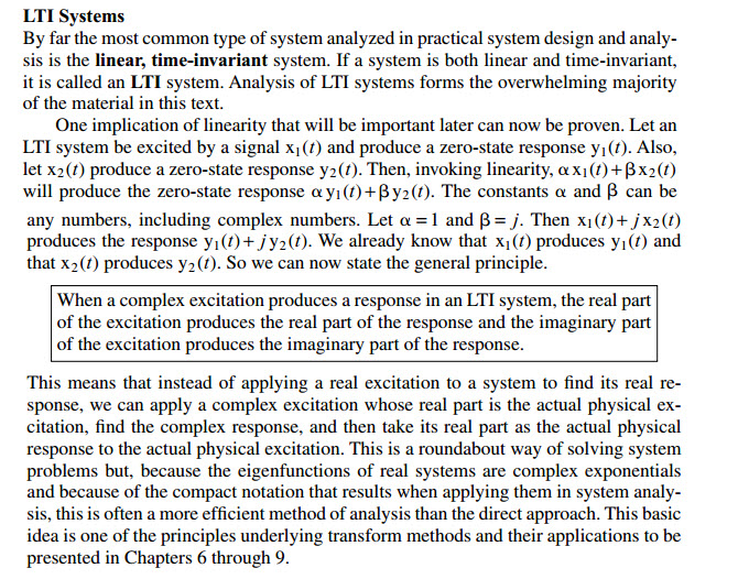

PS: This text might be useful for Q2.
Q1: Yes, correct.
Q2: I think when you first start, real sinusoids are more straightforward and less confusing conceptually. However, once you gain experience, the simplifications of using complex exponential functions is very desirable and makes that approach seem much more natural. But, this is a matter of perception.
Q3: Sounds good.
Q4: Yes, basically that's it. The output is the input modified by a amplitude change and phase shift.
Q5: Actually, I don't know that symbol and never use it myself. If I've seen it before, I guess I didn't pay any attention to it. My best guess is that it is similar to the equal sign with 3 dashes, which means equal to by definition.
Q6: I guess so from that representation. But, you could derive the result without every considering complex exponential functions, if you wanted to.
Q7: Yes, if I understand you, you are correct. Maybe you are starting to see just how simple this stuff can be once you get familiar and comfortable with it. The math can look very complex, but it is really saying very simple and basic things and the simplicity comes mostly from linearity (via superposition principle) and some from time invariance as well.

Hmmm, somehow I did miss it, but I'm not sure why. Strange because the alert feature didn't notify me. How did you know I missed it?
In answering here, I should point out that I'm wondering if the highlighting is blocking some of the equations, or maybe there is a typo there.
Q1: In general, the magnitude of exp(jx) is always one, which results from the well known trig identity sin^2+cos^2=1
Q2: Here is where I'm wondering if there is a typo because I would have expected the h[n] to have an absolute value around it in the right hand side of that equation. In that case the inequality you asked about in the previous post would be the basis to say that is correct. As written, it does not look correct to me.
Q3: That looks to me like a condition for convergence. There are many different definitions for stability, and that one is the BIBO condition, provided that the absolute value is put around the h[k]. So, again I think there is a typo there.
Q4 and Q5: First, let's be careful here as to what w=0 means in each case. In the Q4 case, w=0 implies that x[n]=1 and in the Q5 case, w=0 implied x[n]=0. So, in the first case, delaying a constant value does not change the function at all, so the transform should not change. In the second case, the transform of 0 is 0. The two answers shown are consistent with what we expect. I'm not sure what else to say about these cases.
Now, if you allow w to be other than zero, we can say a lot more about what the transform relations mean.
There is some issue with the slides. Some of the entries are missing. If you look closely, you can notice that there is a single vertical bar around h[n] on the right but the bar on the left is missing. Thank you.

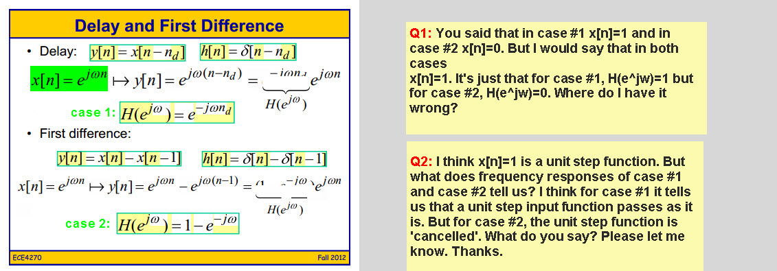

Please have a look on these follow-on queries. Thanks.
Regards
PG
First, x[n]=1 is not a unit step function. It is simply a constant value for all time.
Case #1 is x[n]=1, but case 2 is the first difference which is basically a derivative of a constant function. The derivative of a constant is zero.
