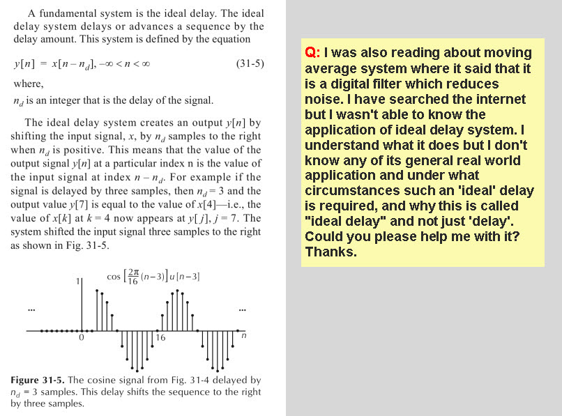

Convergence just means that when you do an integration or a summation, you get a finite answer. So, my interpretation of what they wrote was that they are looking at the "existence" of the frequency response which is really just making sure that the answer converges. The result is interesting because a condition for convergence is related to the condition for stability.
Q1 I am having trouble reading, and your question (which I can read) is not clear to me also.
Q2: An ideal delay is defined (by that book) to be a perfect delay by an integer number of time steps. Ideal means that is is a perfect delay that does not alter the signal in any way and the delay is an integer number and does not have any fractional delays.
The application of delays is basically a memory storage. Since we are dealing with digital systems, either program based or circuit based, we can store old values of any signal and use them for various purposes, such as making filters (as you mentioned).

Q1: Yes, of course the +/- pi range is because of periodicity of [LATEX]\exp(j \Omega)[/LATEX]
This can also be related to the Nyquist sampling theorem. If you sample at a particular rate, then the max frequency of the signals is only half that. The math needs to reflect this fact by limiting the maximum meaningful frequency in a Fourier transform.

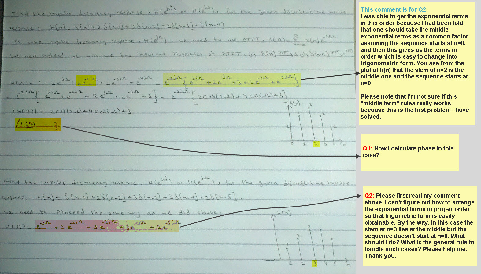

For the original Q2, I'm confused why you say a real number must have a phase of zero. Why can't the phase be 180 degrees (pi)? Or, -180 degrees (-pi) ... etc. ?
For the new Q1, I dont' know why you are having trouble finding the phase of a complex number. I know you learned how to do this years ago.
For the new Q2, wouldn't the Euler relation exp(jx)=cos(x) + j sin(x) allow you to get trigonometric functions?

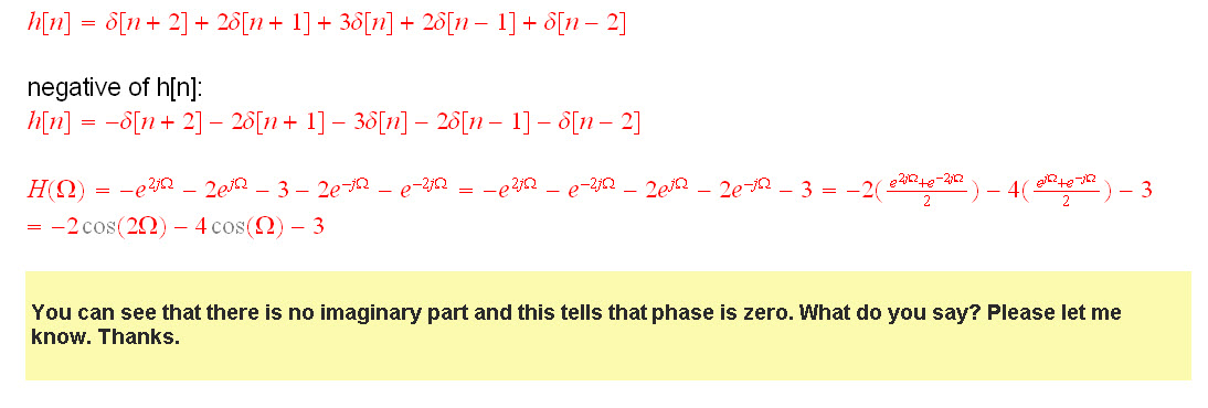

Original Q2: But my point was that if a signal is symmetric around n=0 axis or if a signal is even then according to DTFT it's phase will be zero. Do you agree with this? I'm sorry if I'm missing your point.

Q1: Yes, I did learn how to find phase of a complex number more than a year ago. But now my knowledge is very much rusty. I understand that the phase is arctan(b/a) for a+ib. Please see my attempt here.

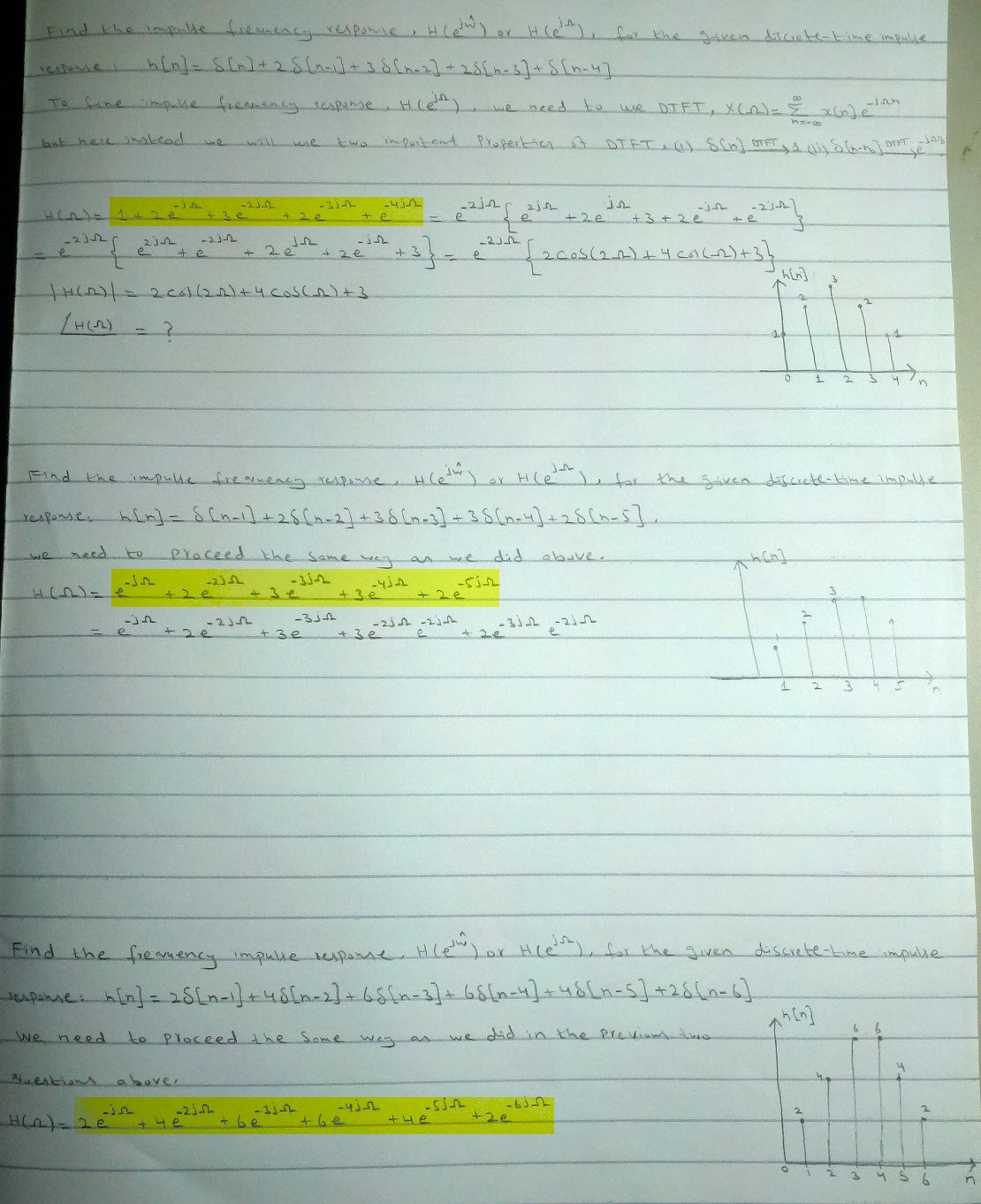

Q2: Yes, one needs to use Euler formula here but the problem is to first get the exponential terms in proper arrangement and this is where I'm having trouble. EDIT: I have tried to solve another similar problem (at the bottom) but I'm stuck again. I'm sure there should be some general way of arranging the exponential terms in a sequence or order which makes the application of Euler formula straightforward. I hope you can see my trouble. Thanks.
Well, let's check it out. What is the phase if we change h[n] to the following?
[LATEX]h[n]=-\delta (n+2-)-2\delta (n+1)-3\delta (n)-2\delta (n-1)-\delta (n-2)[/LATEX]
In other words, make it negative to what it was before.
OK, rusty or not, you do know how to do it. It looks good to me. I didn't check every detail, but the approach is correct, which is most important.
I'm really confused about why you are having trouble. You are trying to find a way to make the application of the Euler formula straightforward. But, what can be more straightforward than taking every A exp(jb) and converting it to A cos(b) + j sin(b). You do realize that the answer is allowed to be complex, ... right? Also, there is no requirement to use sine and cosine forms, and the answer you provided already is correct.
Is there some particular form that you expect to achieve that I'm missing?
[LATEX]h[n]=-\delta (n+2)-2\delta (n+1)-3\delta (n)-2\delta (n-1)-\delta (n-2)[/LATEX]
Okay. Please have a look here.
I think that you are still missing the point, or perhaps it's just me. Please have a look here and see if you can see where I'm having trouble. Thanks.

OK, so for the first issue, you have shown two problems which differ by a negative sign. Isn't a negative sign the equivalent of a 180 degree phase shift? So, if you say the first one is a phase of zero, then the second one should be a phase of 180 degrees. This was the very first point I was trying to make. Just because something is real, does not mean the phase is zero. It can be zero for positive numbers and 180 degrees (or -180 degrees) for negative numbers.
OK, for the second issue, it seems that you are trying to get a "preferred form" for the final answer. It's always good to simplify expressions when you can. However, is there any rule that says that all cases will lead to nice simplifications? I would tend to say no. But, I'll go back and look at your original problem to see if I can find any simplifications there.
To simplify the answer to trig functions, I would recommend the following on that problem. First, you will want to pair up terms with equal amplitudes, so that they can be combined. Then with each pair you need to factor something out, e.g. factor exp(-j 3.5 Omega).
Just doing this quickly in my head, I get something like the following ...
[LATEX]2 \cdot \exp (-j 3.5 \Omega)\cdot (1.5 \cos(0.5 \cdot \Omega)+\cos(1.5 \cdot \Omega)+0.5 \cdot \cos(2.5\cdot \Omega))[/LATEX]
I could have made a mistake, but you will get the point, I think.
