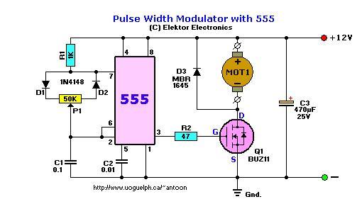

Hello everyone! I have a problem with this circuit. The problem is that motor speed is not consistant, and it is same thing if motor spins faster or slower depending on the potentiometer. It seems like the ne555 is not outputing consistant signal to the gate of the mosfet for some reason. It is especialy noticable at lower speeds. Im using HRF3205 instead of BUZZ11 in this circuit, and I am also using 2 diodes in parallel instad of one here because I didnt have MBR 1656. I'm using 2 diodes schotky in one TO-220 package from a pc PSU. Here is the circuit.

Hi Remzy,
nice circuit and well laid out.
Just some observations.
(1) The 555 is not decoupled locally and it is driving a relatively heavy load. A 22uF ceramic capacitor physically across the supply pins 1 & 8 would be a good idea.
(2) You are using an unspecified diode which cold have a reverse breakdown of less than 24V, most likely in fact.
(3) I do not know what the 12V power supply is or what your circuit layout is. But a two star point arrangement (12 and 0V) is recommended with wires as short as possible
(4) The HRF3205 is a handsome beast of a NMOSFET, but consequently it has a massive effective gate capacitance. I would be inclined to fit a 22 Ohm base resistor.
But at the end of the day, I don't think that a 555 output will have enough output current to drive a high power NMOSFET. I suspect that you need a gate driver chip between the 555 output and the NMOSFET gate. A suitable gate driver is shown in the PDF file below.

Is the load on the motor changing? That circuit is not a motor speed controller where there is feedback based on motor speed.

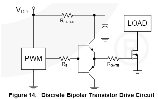

I've found this circuit on one PDF. What is your opinion on could I use is, or if I was to use another mosfet with lower gate capacitance, because right now this one is a overkill for a wiper motor. I would probbably need a mosfet that can support at it's max around 20A, just to be safe. I was powering this circuit form a lab bench power supply I've made and it already has ceramic filter capacitor on the output. The diodes reverse breakdown voltage is 45V, it says it in the datasheet. Also I probbably need a LC filter on the input of the psu because the amp and voltage meter on the psu can't get correct readings when I connect this circuit to it. The psu is linear
What are you using as a power supply?
Right now its a linear bench power supply, but when I finish the circuit I'll have to power it with a car battery because the project I'm making is quiet far form a closest electrical outlet.
What happens to the motor speed if you connect the motor directly to the power supply?

That circuit is has more drive current so would be a help, providing you use high conductivity bipolar transistors like BC337/BC327. Small signal transistors like BC546/BC547 would not do the job.
I would suggest that you try your present circuit driving the wiper motor with a 12V battery (car battery?). Power supplies can do some strange things when loaded with a high pulsed current.
And/or, if you have a large capacitor, say 10,000 uF or larger, connect the capacitor across the 12V power line in parallel with the present 470uF (C3).
spec
