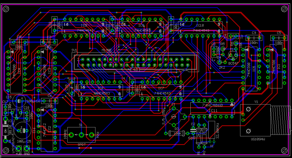

I have designed a PCB layout for the counter using the original schematic.
I added a low dropout voltage regulator (LM2931AZ-5) for supply voltages from 5.5 to 15V.
Main board dimensions are 5.24X2.76". The display board is purely single sided and measures 3.0X2.3".
Eagle files are available free. PM your email address if interested.
