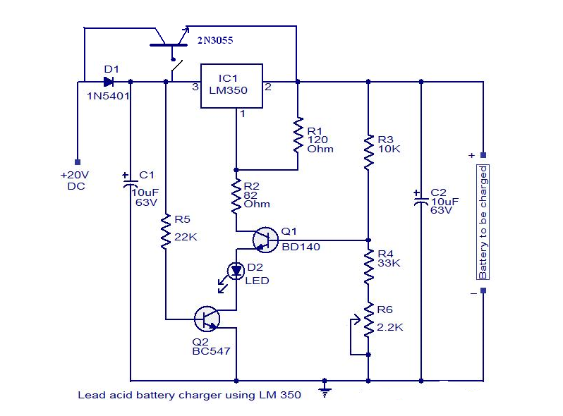

I have got 2 maintenance free lead acid batteries. 12V 40AH each.. they are connected in series to UPS. problem is, the UPS's charger doesn't charge the batteries quickly enough..
can someone give me schematic to a 24V @ 6~10A smart charger circuit for the batteries (one with full brute charge and then float charge, so that when the battery is fully charged only a trickle current is applied )..

if i built my own circuit, i'd put a voltage regulator like lm350, with a transistor for increased current, and another transistor to detect float charger being applied.. for which i might just use a comparator.. and then the protection diodes would mean i'd have to increase my charging and float charging voltages by an equal amount of all the diodes drop in series with the batteries. Ahhh..

Basically, you need a regulated power supply capable of putting out two preset voltages, Vcharge and Vfloat. The supply should have current-limiting built in; both to protect itself and to keep the max charging current within the range specified by the battery maker.
If you want automatic recharging, then you will need a controller which will switch the supply from Vc to Vf when the charging current tapers to the appropriate level. I have several circuits do to this.
If you are willing to recharge with manual intervention, then you have to watch the charging current and then switch from Vc to Vf by flipping a switch or turning a knob. :)
what would this circuit do.
the website where i took it from said, it will supply 13.8 volts with full current rating of lm350 i.e 3A until the battery is charged, after which the output voltage will drop by Vref and provide a very low current of milliamps. As soon as the battery discharges, the Vout will once switch to 13.8 volts to charge the battery.
