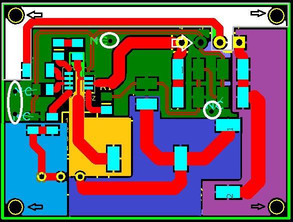

Ive updated the design with mounting posts and replaced the via shielding array with a few placed vias that are meant to evenly connect the top copper GND layer with the bottom GND layer. That is how i understand its purpose. Ive increased the tracks as wide as possible with the exception of the GND track as the pour will widen them. I am extremely grateful for everyone in this group. Learned so much about so many new features and components.
An alternative to wide tracks is multiple pours bound to nets
Ive highlighted each net in a different color. Shown encapsulating their associated tracks in red.
It does not encapsulate every track but my point is you can do this instead of beefy tracks. Of course where it cannot be done due to constraints the tracks close to the IC have beefed up tracks.
The ground pour is in green and it is continuous. It reaches every pad where ground is needed. The through hole header pin (in green with arrow) is linked to the bottom layer which joins them together. I added 4 ground vias (circled) that are intended to make a better (more even) connection with the bottom ground plane.
The four corner mounting holes are not linked to anything (isolated) so i dont know if these serve or can serve any additional purpose other than to mount the board. If connecting these to a net or ground will improve anything please let me know.
My understanding of pours, tracks, and overall balance is still very weak. I rely heavily on your opinions to help me understand this.
Thank you.
Thank you.
I like this approach better than the previous layouts.
However, I'm not clear on the colors other than green. What is the relationship between the wide red trace and the purple pour, for example?
Don't forget to widen the thermal spokes.
It is just so you can see the red track and the pour at the same time. Perhaps if I did this it would be better understood. Now this shows that after production the tracks will be one with the pour. Yes the spokes are 2.5 times larger this shows 10 in size. the new spoke width is 25.

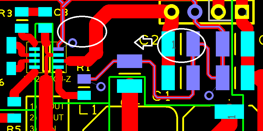

On that buck converter, the current in the supply (pin 2), ground (pin 4) and the capacitors between those pins are where the varying current flow.
It's a good idea to keep that path as short as possible. I suggest you move the capacitors closer to the IC, or put a small ceramic capacitor very close to the IC between pins 2 and 4.
OK. So if possible move C2 closer or add an additional cap
