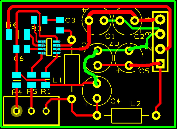

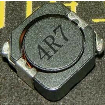

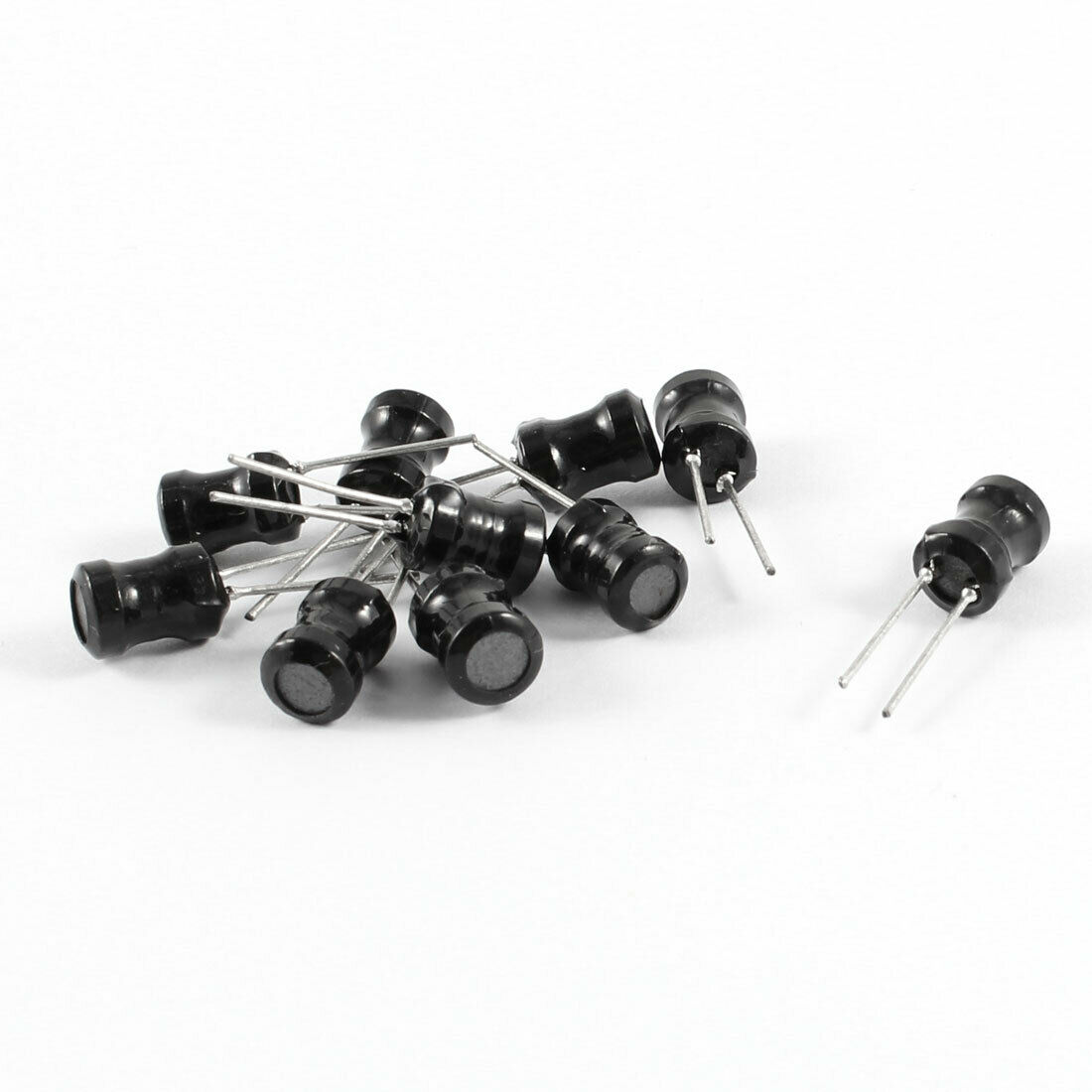

Those inductors look more like RF style, I'd not consider them suitable for a 3A switching power supply. Remember that the main inductor is acting as an energy storage device...

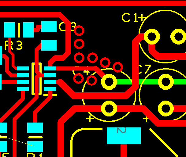

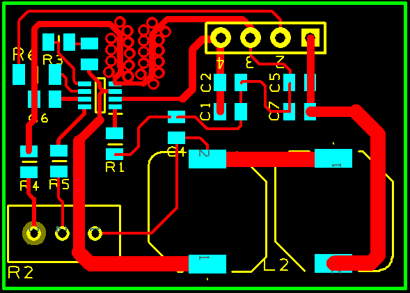

ps. On the circuit board - if you rotated C5 & C7 180', you could eliminate the need for traces on the opposite side.
That would allow a solid ground plane - and then use an array of vias around the ground pin on the IC, to ensure good continuity from there to the rest of the components.
And beef up all the current-carrying tracks!
I would add some ceramic capacitors in parallel with C1 and C2 on the input to the switch. The ESR and inductance of C1 and C2 will lead to voltage spikes as the switching happens, and that can be reduced with some low-ESR capacitors will less inductance.
The same applies to the output capacitors.
The original design seems to use larger value ceramic capacitors. I don't think that you should change to electrolytic capacitors without considering their high-frequency performance.
This is really the point that ThomsCircuit was saying about the ESR of all the big capacitors.
You should be aware that adding a ceramic capacitor across the output electrolytic can cause instability (which is why the datasheets generally don't show it). I stuck one across a project of mine, and it completely screwed the power supply up, removing it made it work perfectly.
I agree with rjenkinsb about the inductor, the RF choke he posted the picture of is completely unsuitable.

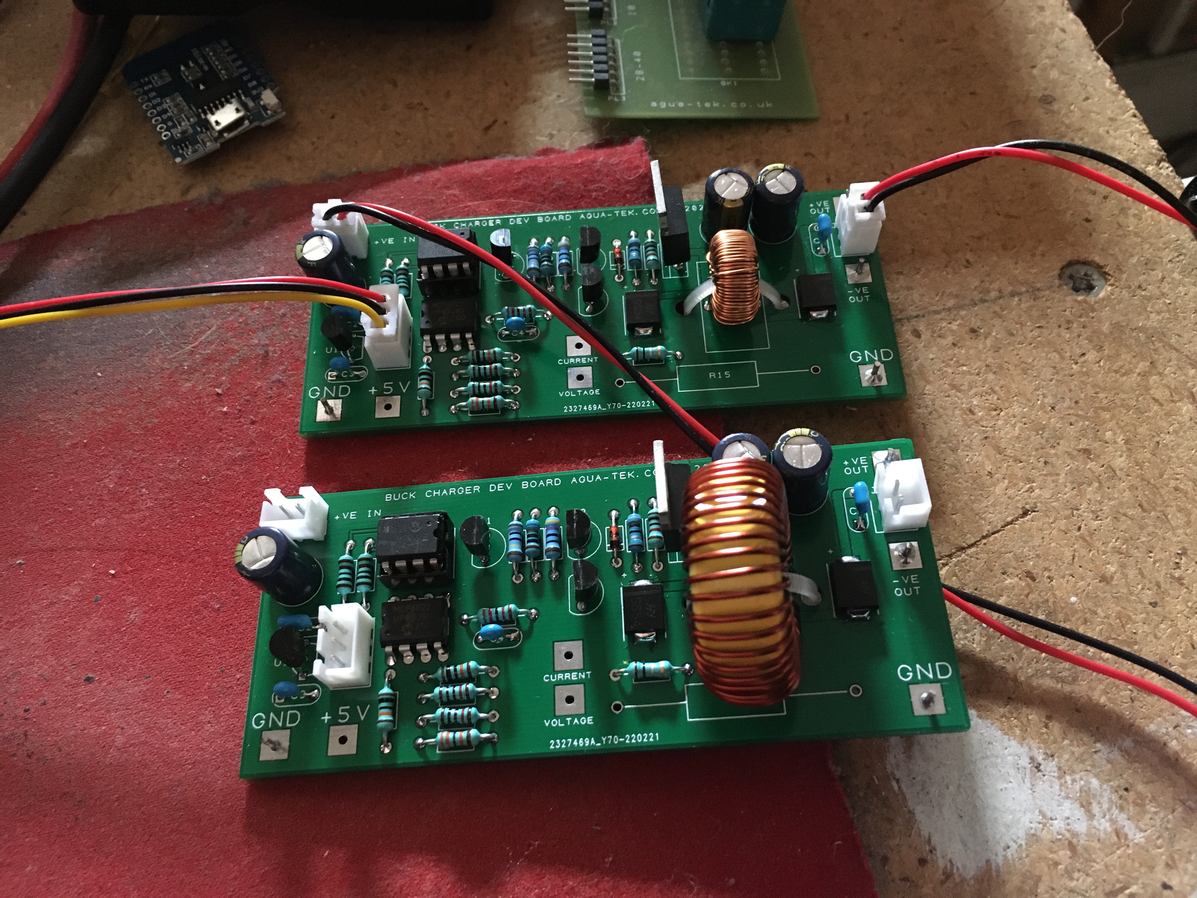

Here are some I'm playing with at the moment, it's for charging Li-Ion batteries from 12V, the socketed IC is a PIC12F1840 (that does everything), the soldered-in IC is a dual rail-to-rail opamp used to monitor the current and voltage - the test points in the middle are for measuring the outputs of the opamp. The three pin lead feeds an FT232 and connects to a terminal program to display what's going on, and also allows you to make any changes to the charging settings.
The two boards are identical, other than the size of the inductor, evaluating the two coils is the object of the operation, as well as proving the software concept.
So use this type instead.
Can these be soldered with an iron? I do not have a heat gun.
On this design? I posted two PCB's The first one I posted was suggested that it was poorly laid out. If you wouldn't mind showing me what you mean so i don't get it wrong.
On this board power rails are 25 and signals 15. there will be ground pours on both sides.

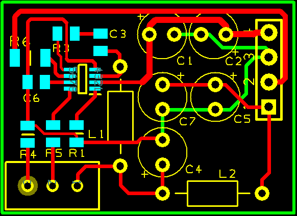

Something like this - the green tracks can then be moved to the other side.

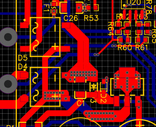

Arrays of VIAs for high current, low impedance or heat transfer though connections; this board has internal ground and power planes which are not selected.
Another example, a small RF board from google images - lines of VIAs to bond the top and bottom layers for low impedance ground around the striplines:
Like these. Nice, a bit pricey. Ill get the SMD version, pre solder a slightly modified oversized PCB footprint pad, then apply heat to flow.
No, those aren't toroidal - those in my pictures above are toroidal.
However, those in your picture work fine, and I've been using then for a while in a number of products we manufacture. The toroids though can handle more power, which is why I'm playing (sorry 'working' :D) with them.

Link both inductors directly to C4, and L2 also to C5 (or better, C7), rather than the long track or indirect connections.
The capacitor pins are the "lowest noise" points so you need to minimise track lengths to those, and where possible have in and out connections all to the caps.
Also link all the ground VIAs to the IC ground pin, to be sure they are all seen as the same net.

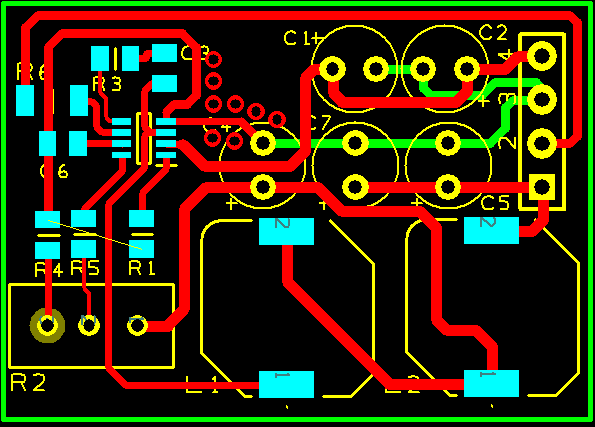

OK I Updated the PCB as directed. Changes to ceramic caps. added vias and connected them to pin4 of IC which is GND.
I made each "VIA" touch each other and the track. LMK if that is how it should be. I DO get design error. "No Spokes" on some of them. Dont know if that's a problem. Seems impossible when there so close to one another. Advise if I need to address this.

I thank you for the formula and the info. It is evident that ceramic is what is needed here. ive updated the project to 0805 style SMDs
