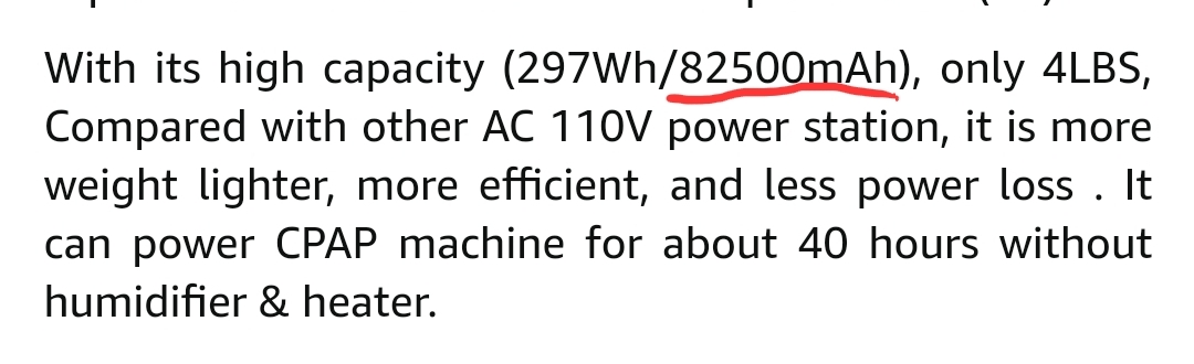

Here's one example of a CPAP battery pack – it's rated at 80AHr. Four times your large battery option with about four times the operating time. Imagine that.
The energy density of LiIon batteries is much, much greater than that of SLA batteries.
Looks like most of the CPAP battery specs show run times for lower-current-draw portable/travel CPAPs. Also note – if you use a humidifier, that cuts down battery life considerably.
curious where did you get 80AHr?
the unit says 297WHr
amp hours= watt hours / volts
WH = amp hours * volts
maybe I missed something?
They do make it tough to figure out.....
297Wh/82.5Ah = 3.6 volts, the battery voltage of a lithium cell.
My sleepy brain says my last post was incorrect. Sorry about that. So this battery supplies (nominally) 300 WHr, and your CPAP draws 3.5A @ 24V = 84WHr. That provides 3.6 hours of run time.
