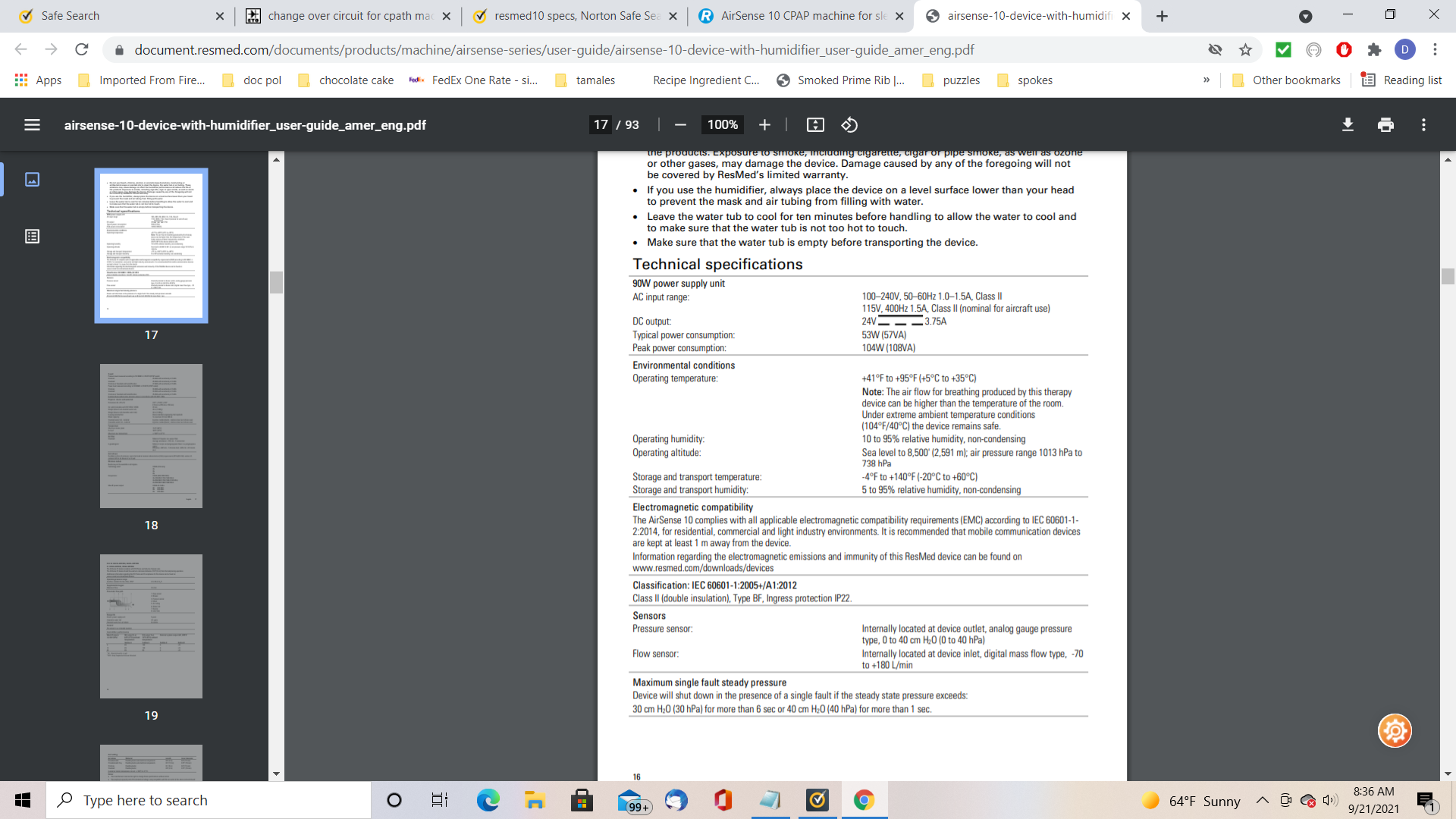

I am looking at maximum output of the power pack of the machine.
I looked at the output of the Resmed10 unit and it showed average is 53W maximum is 104w
just comparing what the average high and average output.
here is the data I am referring to.

Max power draw = 104 watts -->
Max current = 104w/24v = 4.33 amps.
If battery rating = 15AHr, 15AHr/4.33A = 3.46 hours
If battery rating = 20AHr, 20AHr/4.33A = 4.62 hours
This is worst case, but you can't assume "average" values, as current draw depends on CPAP pressure.
