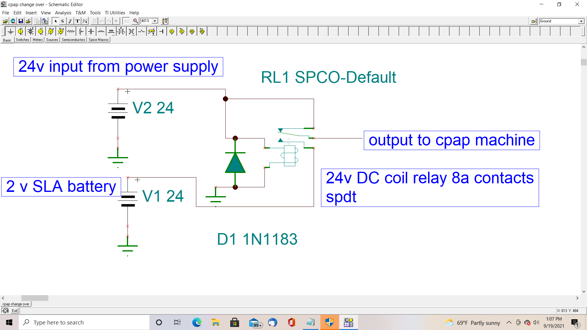

I think this is what Jon was referring to using a relay
24v dc from power supply and a SLA battery (2-12volt in series)
needs refining but can just solder to a bread board.
the relay has 24v coil 8A contacts

You have the relay contacts connected backwards. The line power supply output should go to the NO contact. The battery output should go to the NC contact.
When the relay is energized, the power supply should be connected to the load.
My mistake thanks
