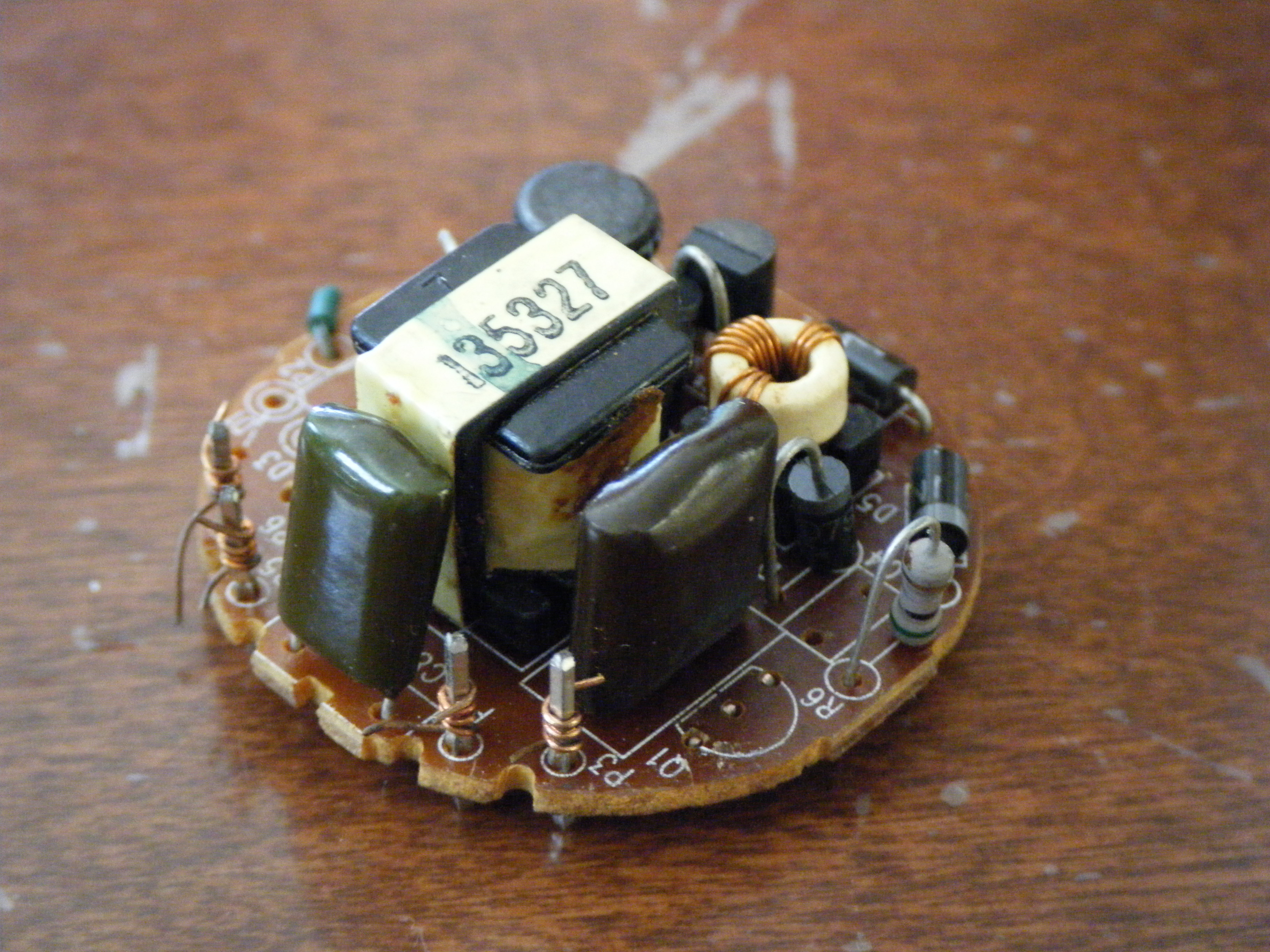

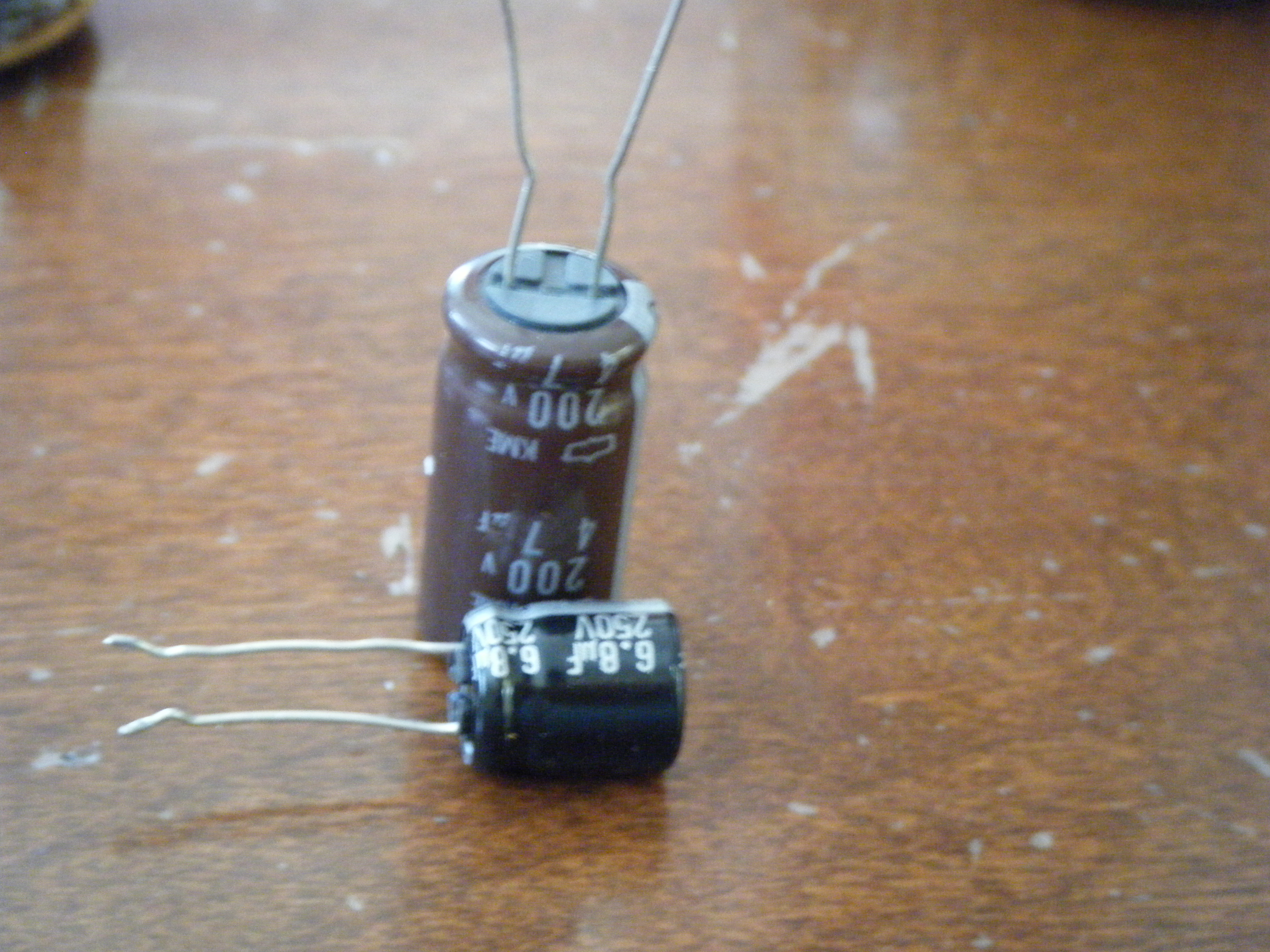

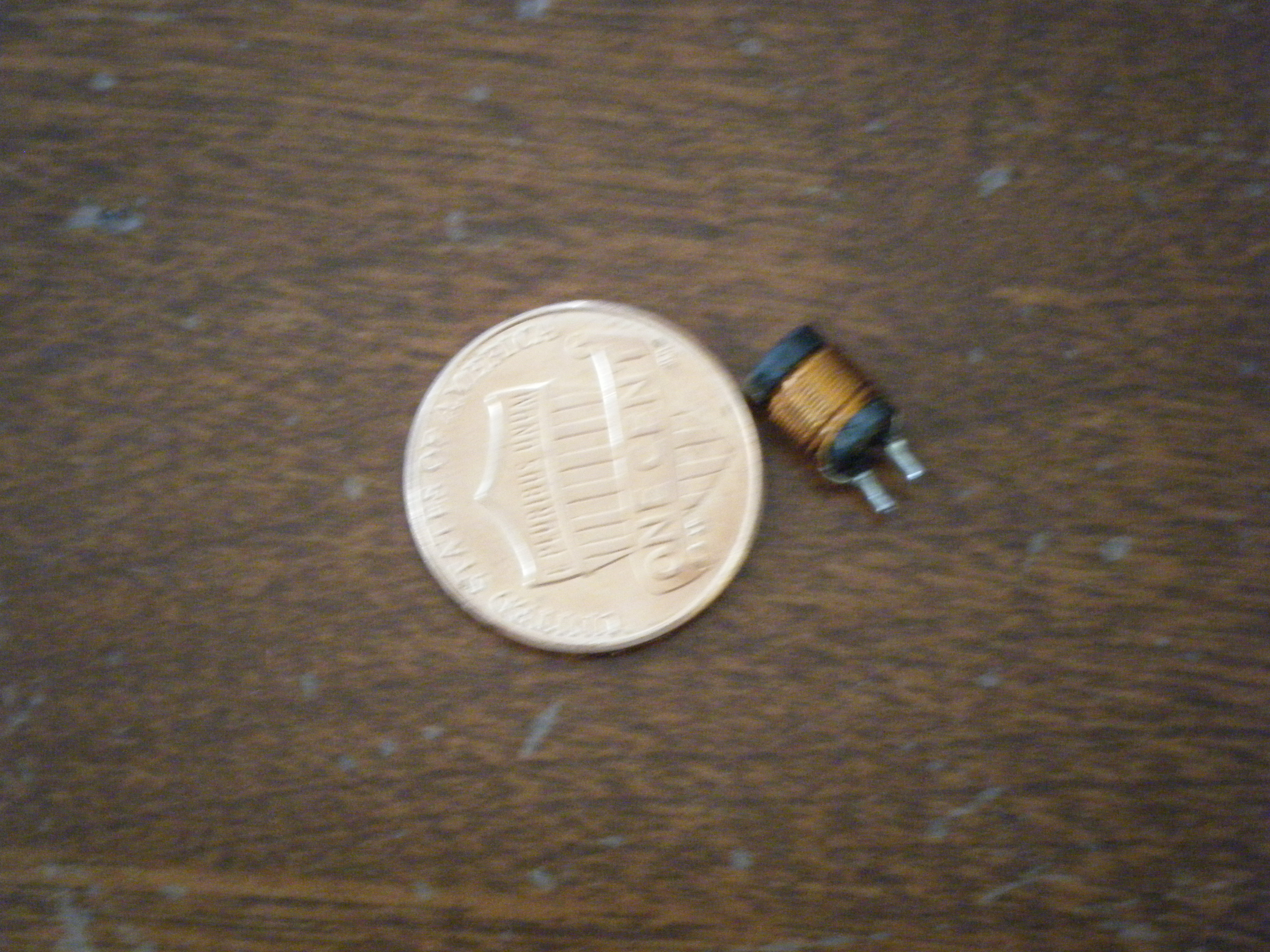

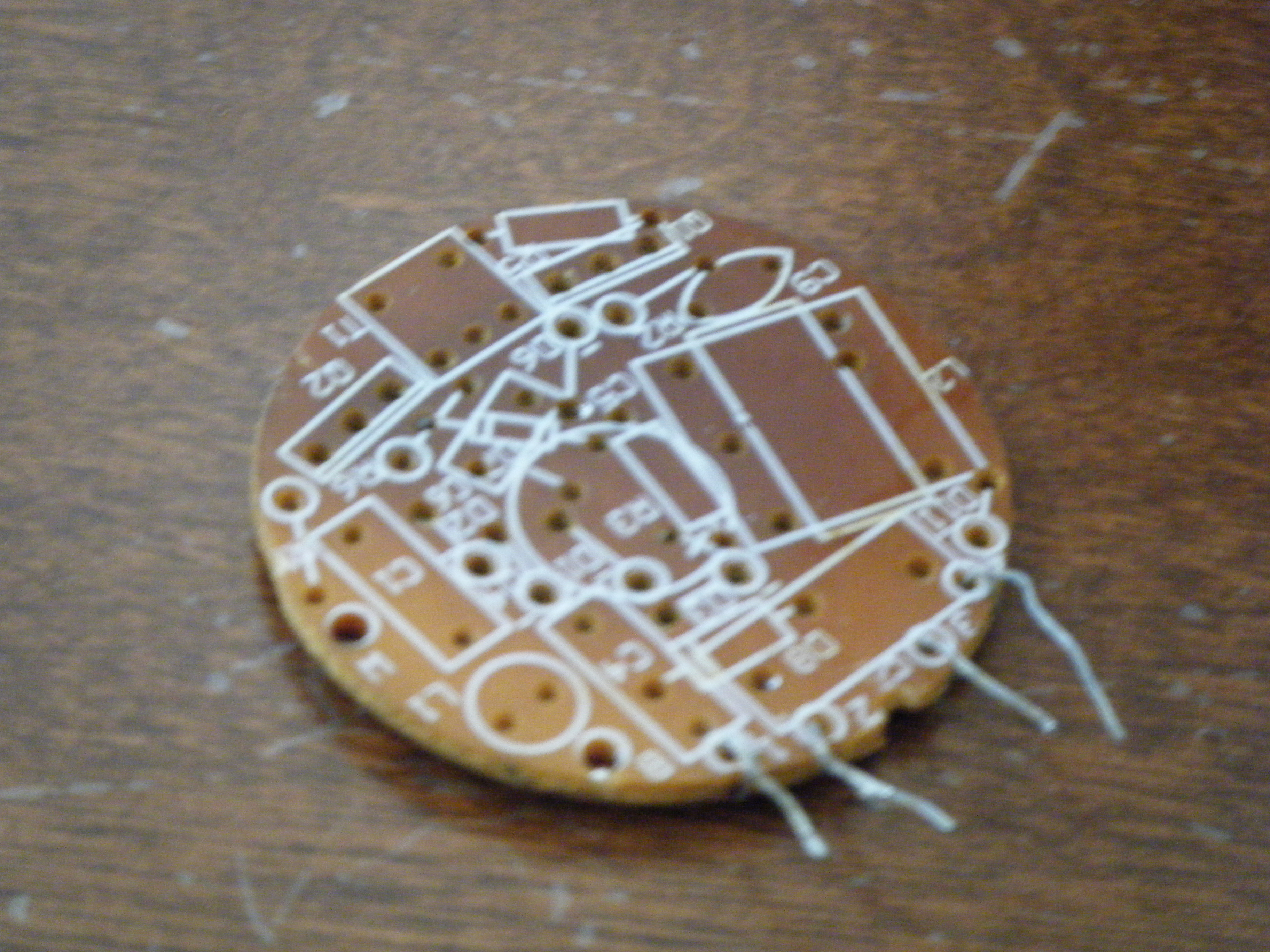

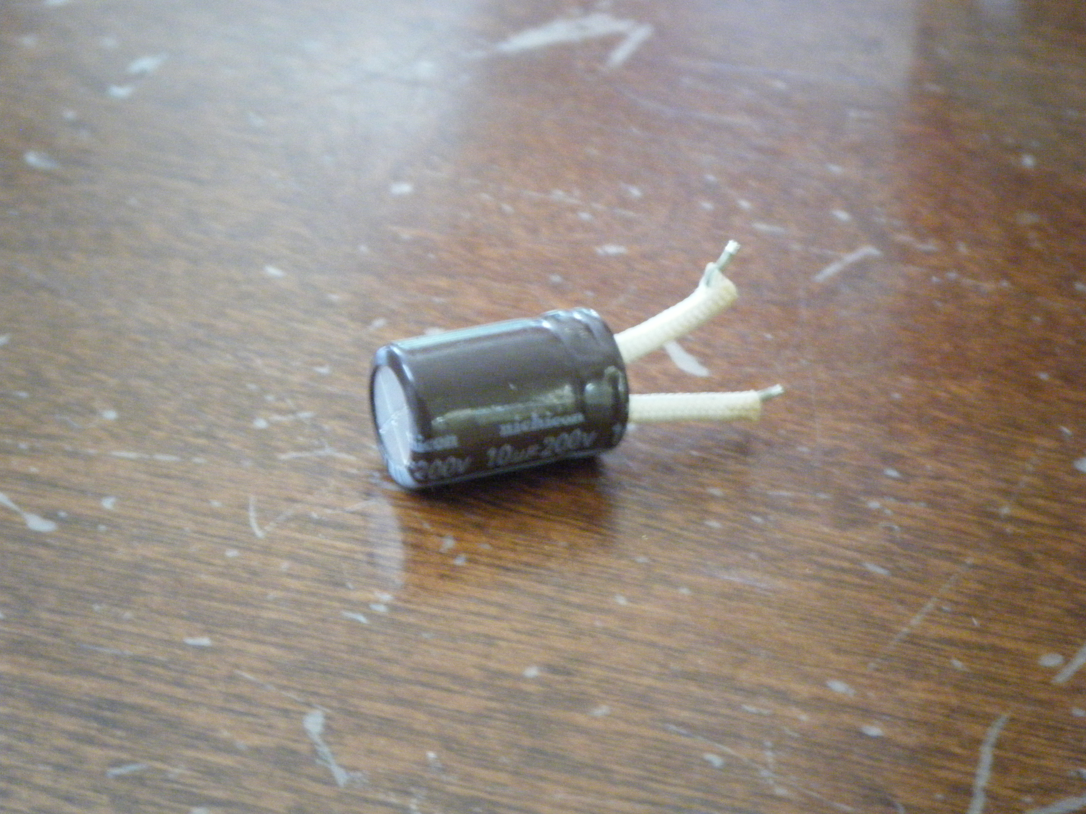

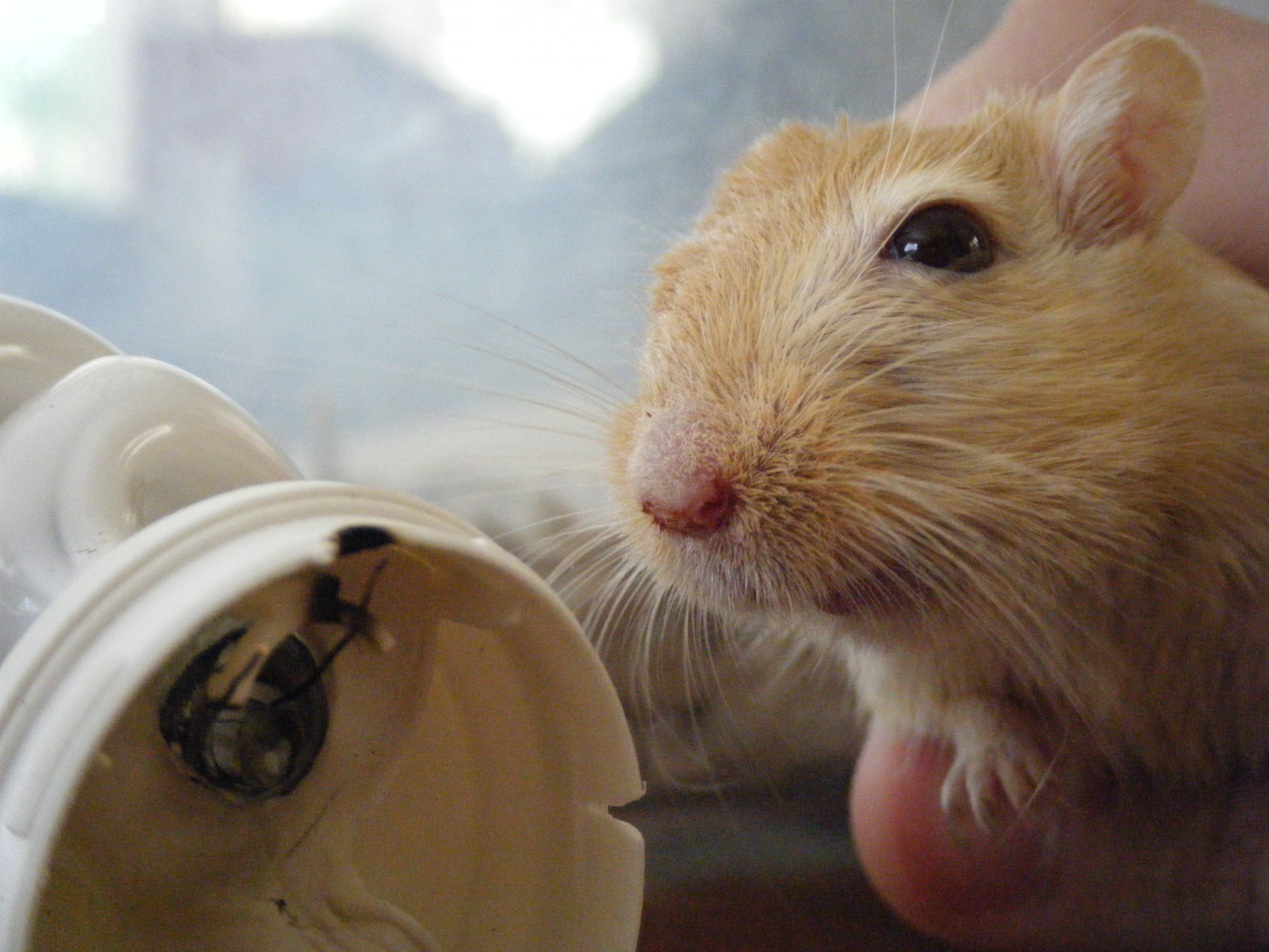

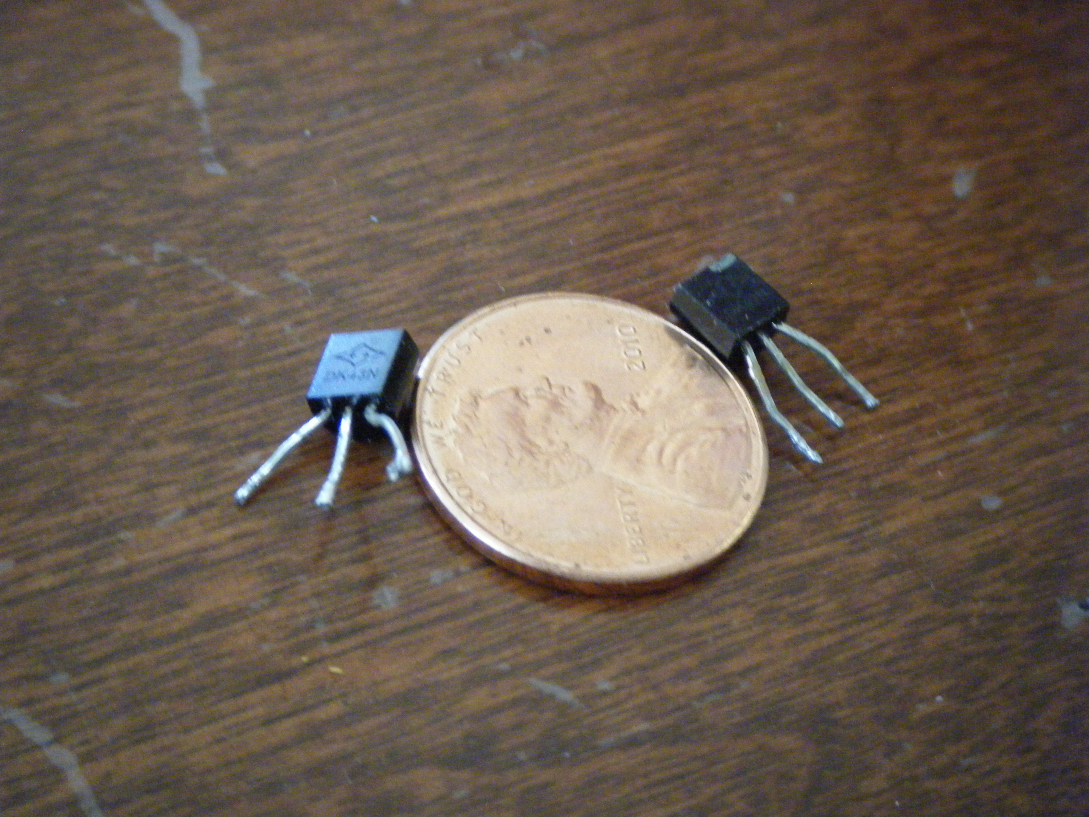

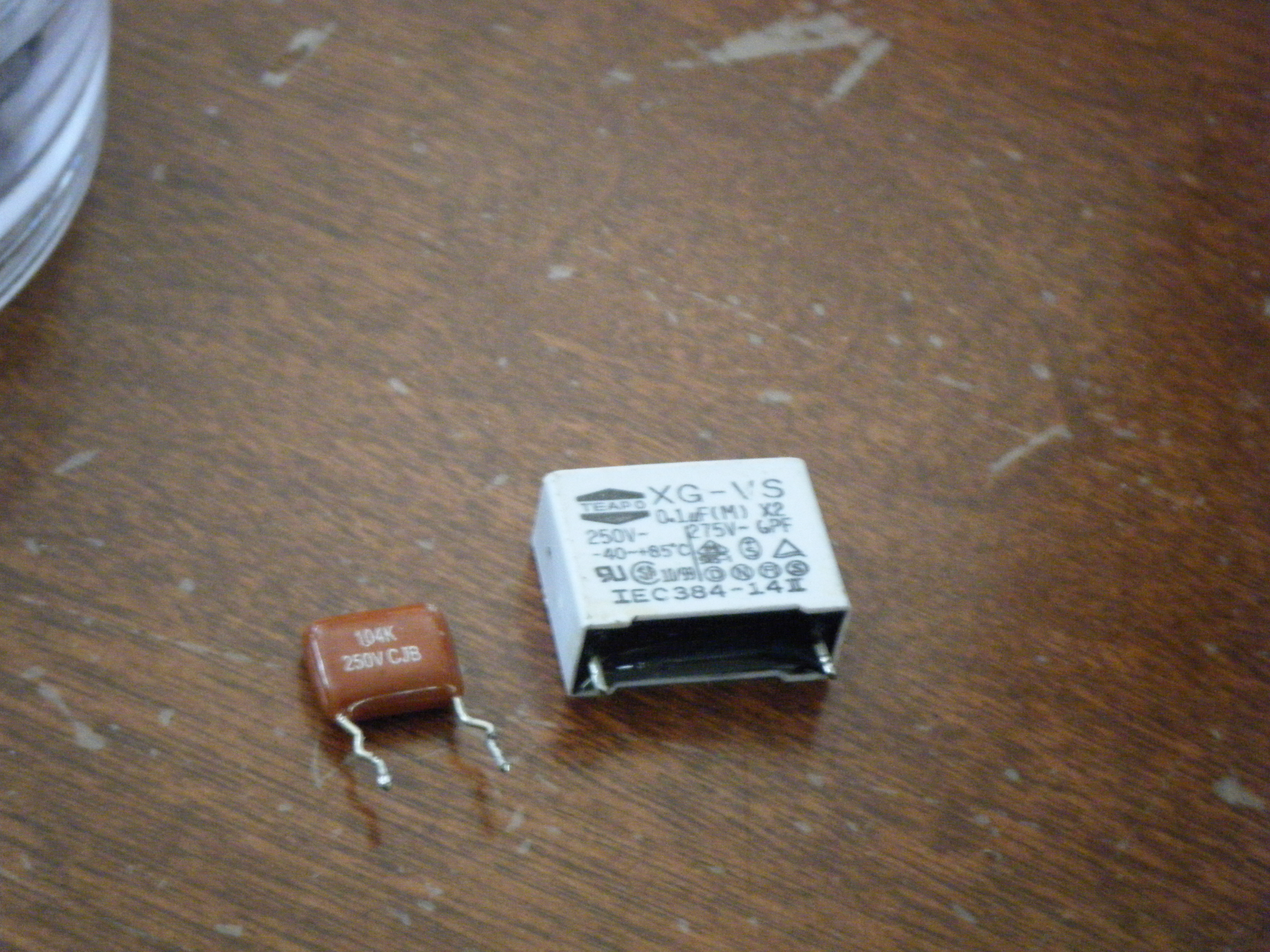

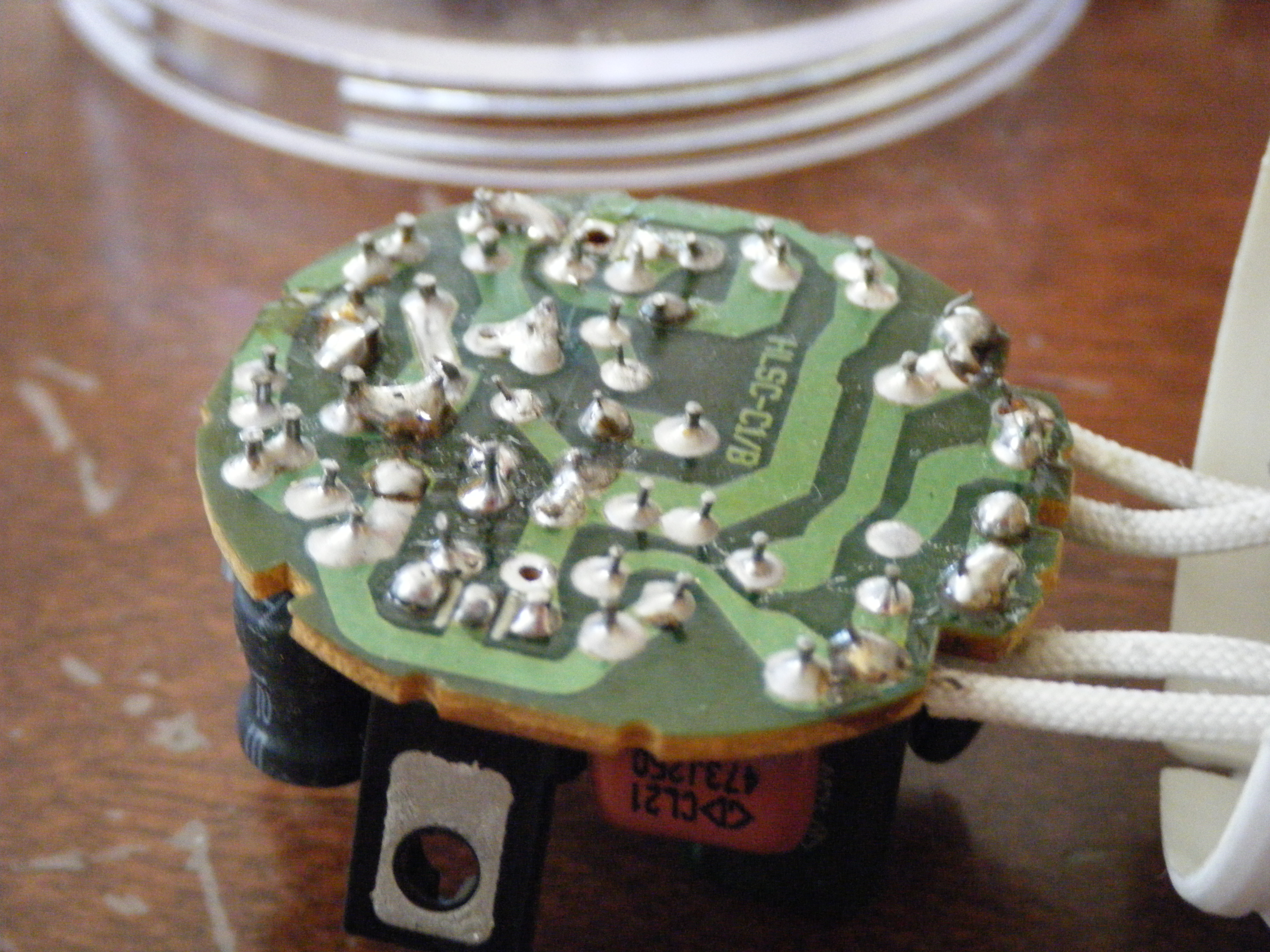

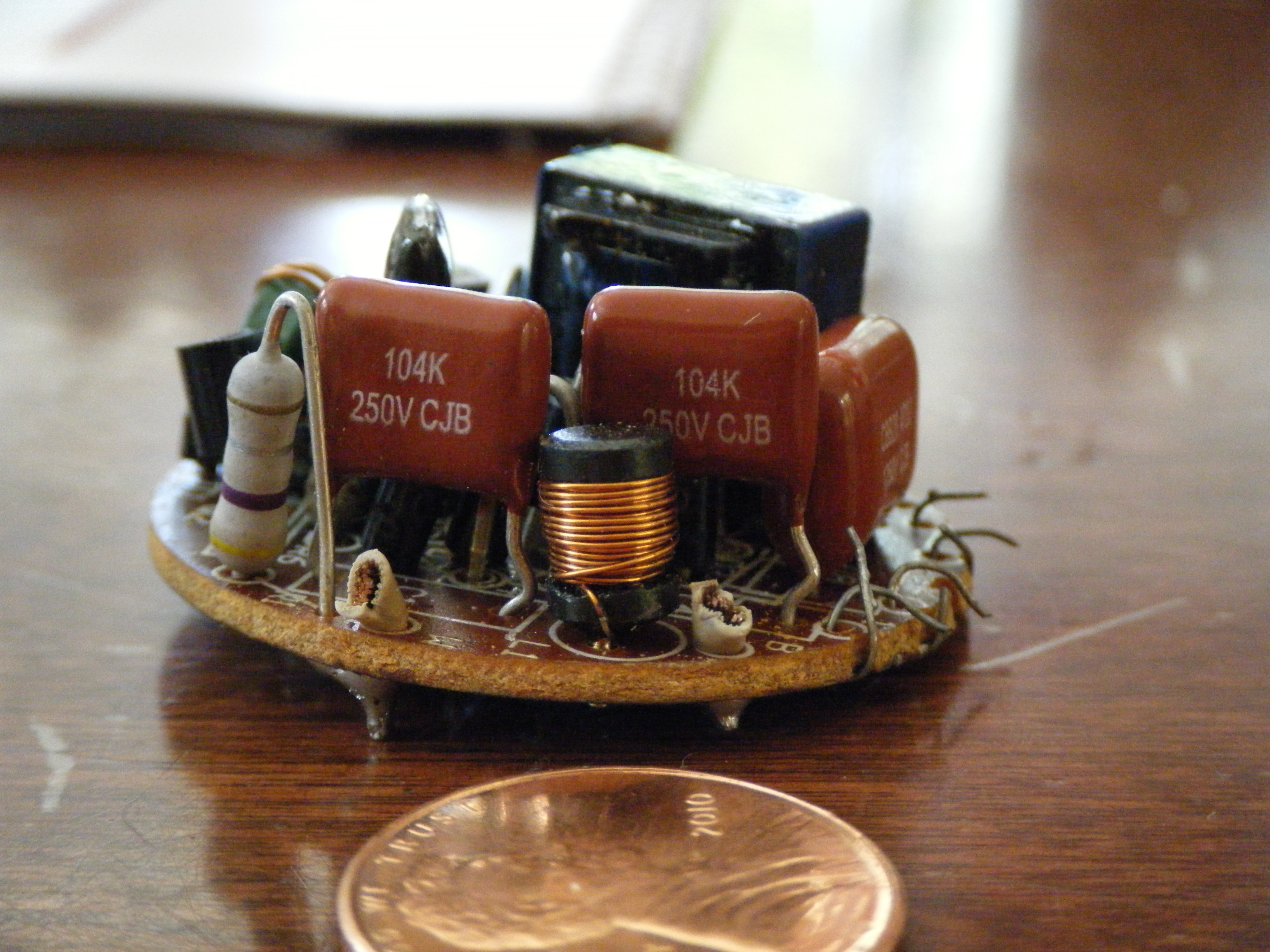

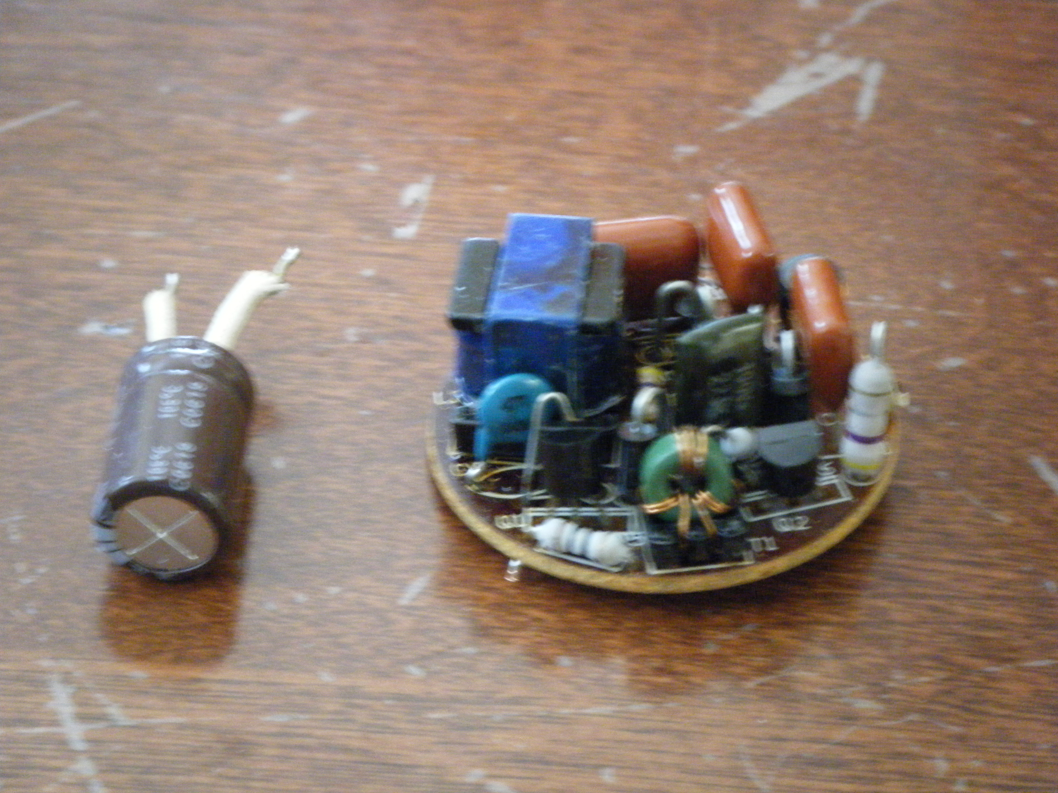

I always wonder what makes things break. So, I very carefully took apart some CFL's that had failed after a year:( or two. They are sooooooo cheap inside!!! 2mm air gap between some of the traces and parts-NOT THAT GOOD!!!!! A 105C capacitor cooked :eek:. I even was playing around with my flyback transformer and a burned out cfl bulb, and I found that the plastic will burn! There are 250volt fim caps connected to live 120 volts, not a big safety margin!!! I even found some arcing marks on the bottom of a cfl circuit board. That same circuit board also had a burned out 10-ohm resistor. Black "green caps". WOW, yeah, I'd call CFL's dangerous!!! It is amazing how china gets away with selling this crap to the US:mad:! Fortunately, none of these cfl's have put up a nice show for us so far:). I read on the internet about people having their's pop, smoke, and sparkle. Check out the pixs! I always would like to hear anybody else's stories of Cfl's going up in smoke! Oh, and all those bad headaches, skin and eye damage they give you!

I think you're being a "fear-monger" here. While it is true that yes, they are cheap inside, and yes, they are made in China (hint: just about everything cheap and electronic is); I'm not seeing anything that would indicate saying "OMG YOUR HOUSE WILL BURNZ!". All such production go through extensive UL testing (here in the USA) to make sure that when they fail, they fail in a safe manner. Spacing of the components doesn't seem that bad to me; we're not talking about extremely high-voltage that can arc-over a 2mm gap. I've seen CFLs fail; yes, they buzz, arc, and eventually "bzzt" and quit. Normal consumers can't get at the PCB, so your fears on that regard are misfounded. Do I think they should be made more robust? Yes, I do. Lasting for only a year seems wrong; you should get much longer run times from such a bulb. I have several in my house that have lasted 5+ years, but then again I didn't go for the cheapest brand, either; you get what you pay for. One of my bulbs has been running "open" in a socket outside, where it gets rained on, for about 4 years now; it's lasted longer than the incandescent floodlight it replaced (its under an eave, but otherwise exposed - simple curled CFL like you have - not a "floodlight" CFL). Then again, we have a bare incandescent clear light bulb in our closet that's been there since we moved in 8+ years ago, and it has yet to burn out (after being switched on and off probably thousands of times)...

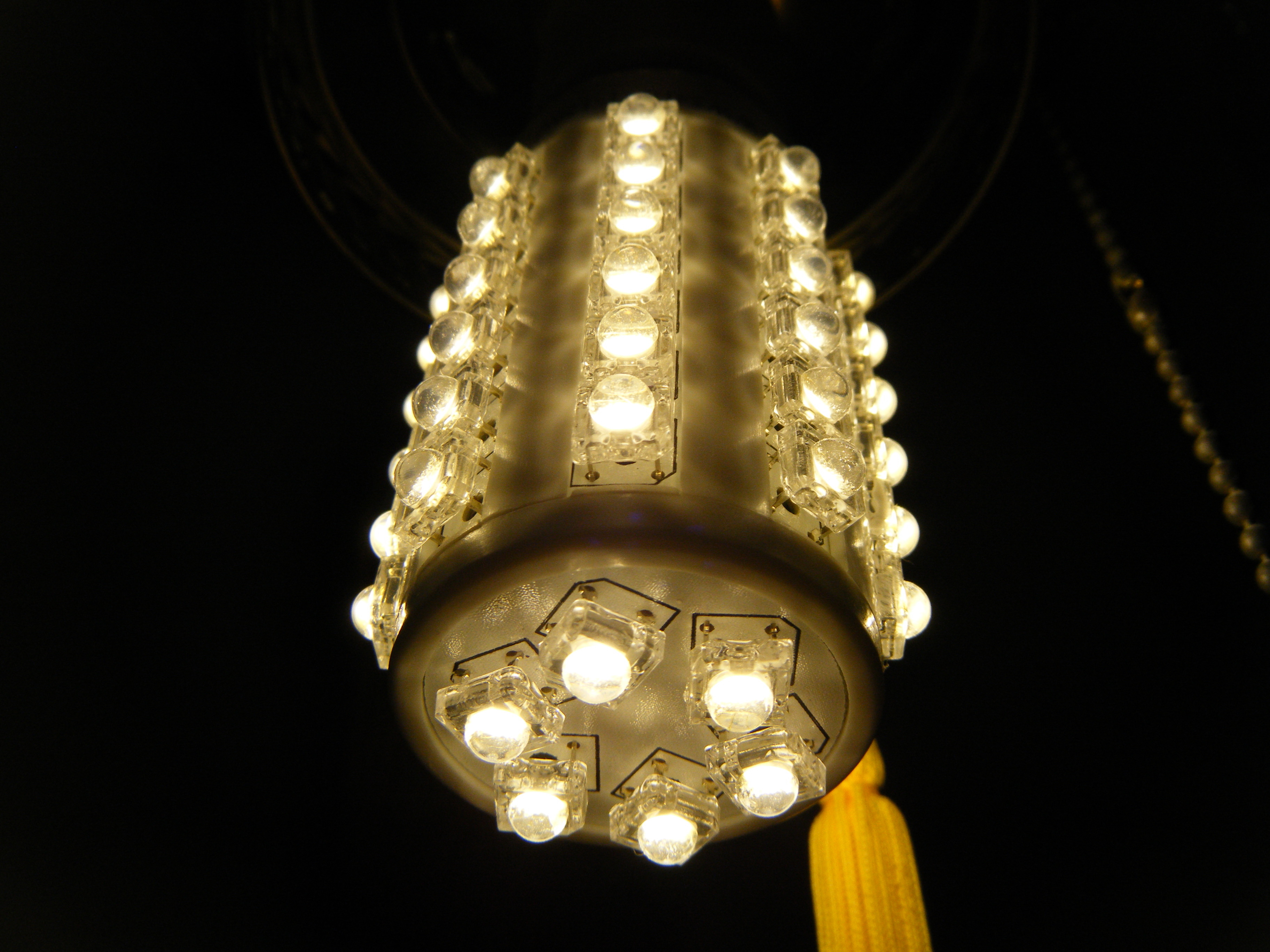

I actaully am working on a led light project that uses an old cfl base. We have some running upside down, some burn out fast and some are still working!!!!

In my limited experience, they're more reliable than filiment bulbs. When they DO 'pop', given the parts used, and of course the 'FR-2' board, I seriously doubt it would pose a danger. Cracking the tube itself would be more dangerous, sharp glass, mercury vapour (which disapates quickly) and nasty phosphorous.
As for 'electrical' safety. Remember, almost all domestic electrical systems are fitted with breakers, in most countries by law. Even the old ones use fuses, which will happily cut supply if a CFL energy saver starts eating current to feed its arcs. Any arcs that do occur, will no doubt be high voltage, low current.
Ben: You're right. The supply filtering isn't great in those cheap things, plus their power factor is frankly, dreadful. Far lower than even cheap SMPS plug-in PSU's. So, the consumer is charged for the power they are rated for, but the energy companies foots the bill for extra loses their high-crrent spikes incur. So for all you folks who use these to 'save the planet', you're not :( You're just paying a lower electricity bill.
