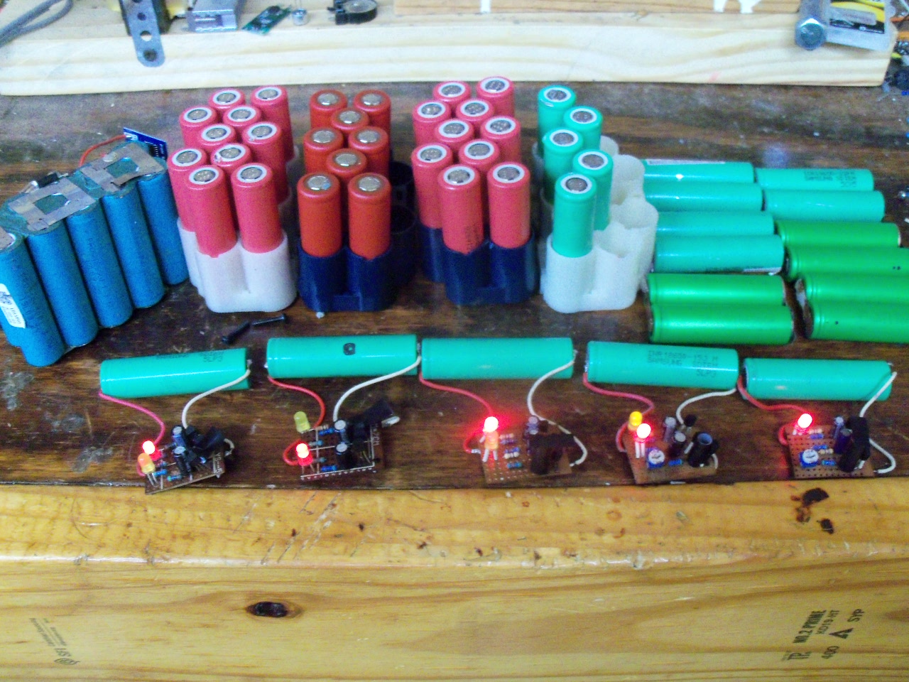

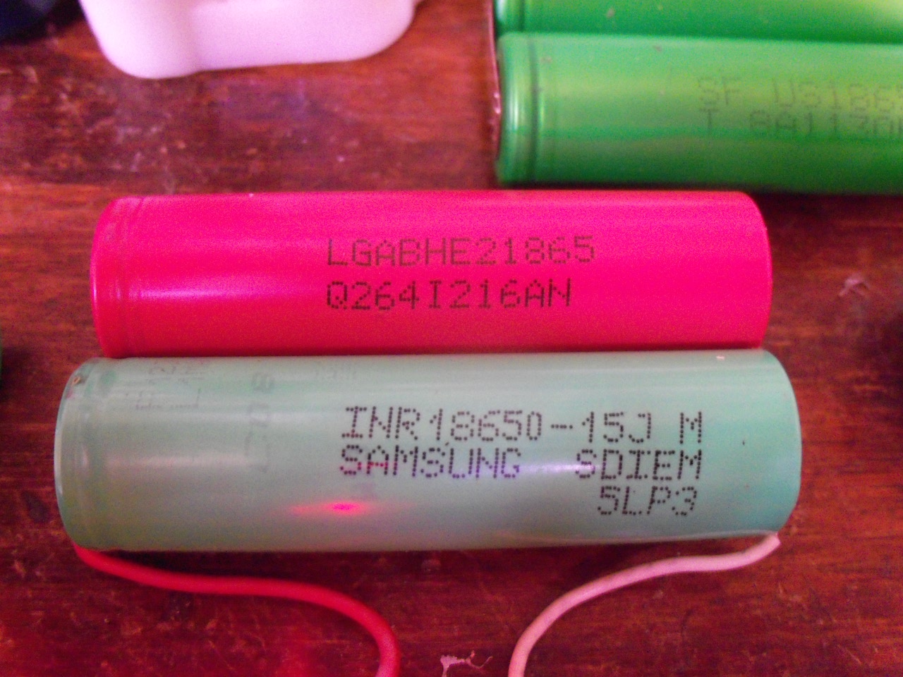

I have 60 free lithium ion batteries. They all test, 3.8v, 3.9v, 4.0v, 4.1v. I ordered 2 chargers that will charge 1 battery each. I ordered another charger that will charge 2 batteries at a time. Digital read out that shows the original battery voltage, it also shows voltage as battery charges. 1 battery is all my LED security lights need to operate. I also ordered a battery tester to learn how good the battery is under load.

Don't overcharge them & don't over-discharge them (voltage or current, in either case).
Don't physically damage them.
Get rid of any that read very low, zero or less than a couple of volts.
Any that are less than 3V, try charging at a very low current - like using a 1K resistor from 5V so only a couple of milliamps, for a few hours or even a day or two, and see if they come back up to 3V or at least are showing a steady voltage increase.
Discard them if not.
Do not, ever, use them for things that don't have a reliable low voltage cutoff somewhere around 3.3V - so no simple LED flashers!!!!

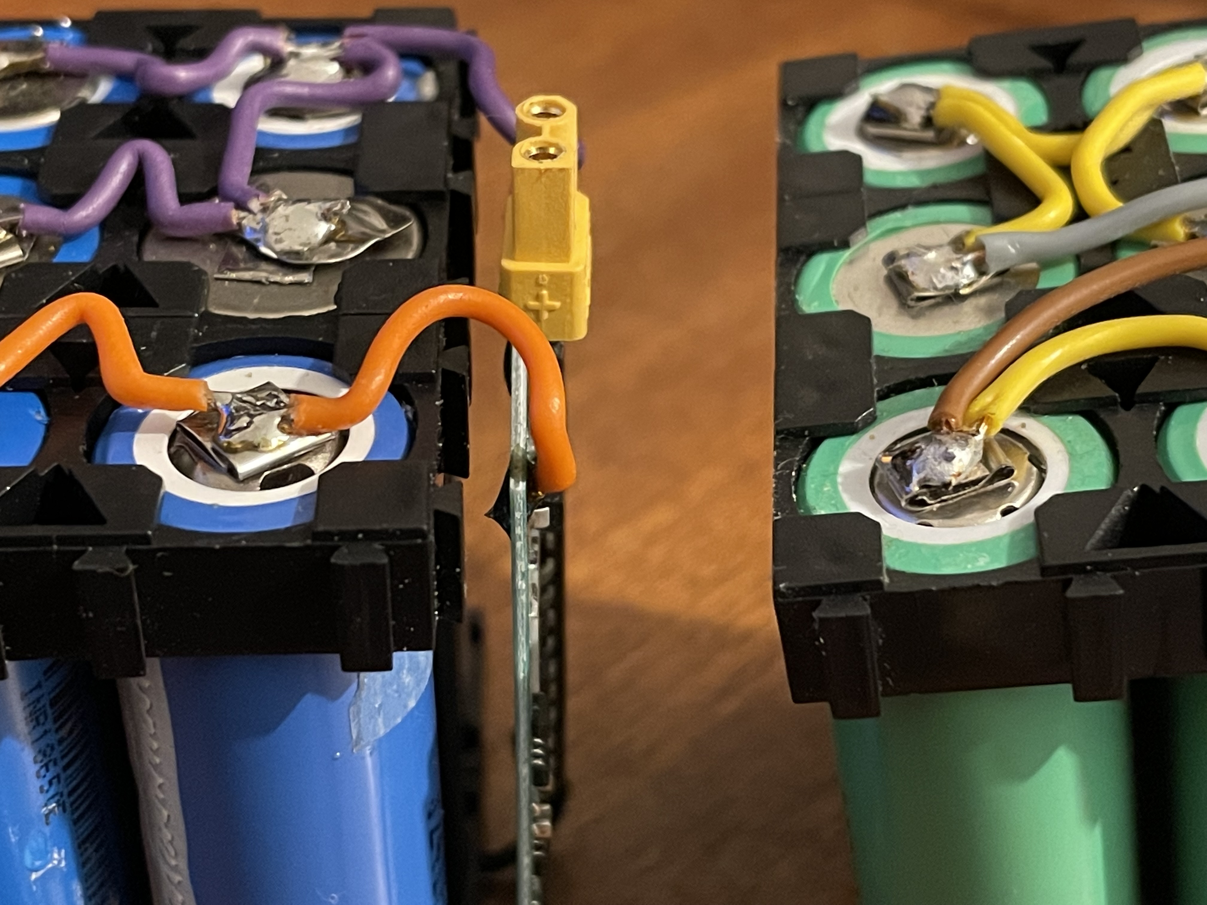

Batteries all have pre connected tabs I can solder to.
The upright ones definitely appear to have had the welded tags removed - the positive ends look like bare cell positives terminals. The remains of the spot welds are clearly visible.
When separating cells from pre-built packs, cut any welded link strips in the middle and fold the ends back to over the centre of the cell end (especially the positive, try and keep it within the visible "button" of the cell itself).
