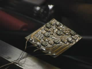

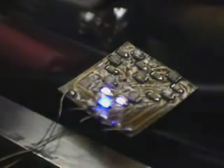

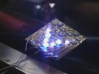

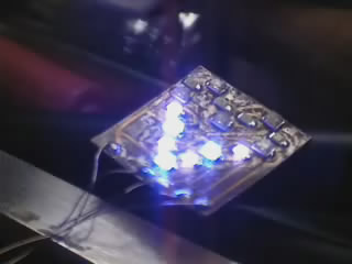

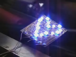

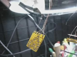

OK here r the pictures of what I'm trying to do look at them on order please from 1-7.
I should done this from the beginning I got those picture from a video, all the leds of the heart would blink 3 times and then turn on the leds in the sequence as show in the pictures.
However how did he manage to turn on the leds in that sequence with only 5 wires connected to the circuit?
I I were to do that I would use something like a counter and connect each Q output to a row of the heart so if u count the number or rows that will light up in that sequence it would around 9 rows.
So I'm mostly curious is how did he manage to do that with only 5 wires connected to the circuit.
Note: There doesn't seem to be any resistors. transistors, gates in between the leds.
Also is that a pcb board? it looks a bit soft kinda a like sheet of paper no?
He has atleast 14 LEDs positioned in a pettern as we could see the 5th photo from the top. when all of them are ON.
That is how the heart is turning on, so if u look at the rows of the same color, each is a stage so if u count them excluding the first on because it is alway on u have another 8 stages turning on one after the other and when they reach the (light blue dot) they start turning off on one after the other until they reach the first one (red dot) and then they turn on again, this is done 3 times and then all the leds blink 3 times and then they turn on in they way I just described and so on.
so how can he turn on the other 8 stages with only 4 wires left?
Nigel Goodwin: Don't forget, he's only switching four LED's, not five, the 5th is permanently wired
There is a total of 16 leds (9 stages being turned on in total) the first one (red dot) is always on, so there is 15 leds left being turned on 2 at a time expect the last one (light blue dot) which is 1, so there is 8 stages left turning on.

Right, so we're not discussing your 5 LED design anymore then? - you can feed more LED's with less wires by multiplexing or charlieplexing the connections.

There are plenty of PIC's that will work off 3.6V, and it's VERY likely that a PIC (or other micro-controller) is used to drive the LED's.
BTW, the PIC application note is an example of charlieplexing.

You do it so fast you can't tell they are flashing, it's a VERY standard technique.
