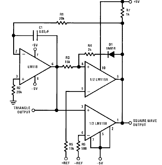

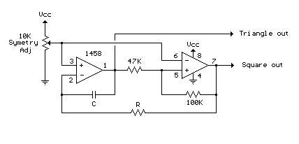

Looking at your 1st posting LED pattern, I would agree with Gordz, a LM3914 set for bar mode. Drive the input of the LM3914 with a ramp voltage.
If your LED's require more current than the LM can supply, use the LM to drive 4/5 transistors, which drive the LED's.
ericgibbs, you seem to be on the right track, a triangle ramp voltage with the
LM3914. Can the triangle wave be clipped on top to allow the full heart to stay on for a shot period of time?
I would try using 'two' LM outputs at the 'top' to drive the same LED set.
That would give the appearance of a longer on time.:)
