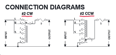

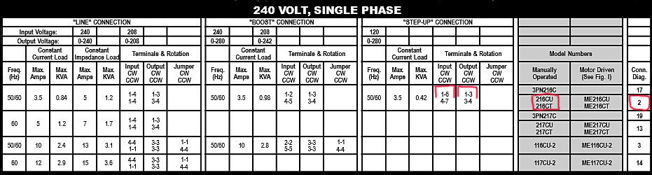

I was rather hoping that you would follow the fault finding procedure that I started, so that we could establish the nature of the problem and hopefully repair your Variac.
The way that the Variac was originally wired (terminal 1, 0V in and out, terminal 6, 120V input and terminal 3, wiper output) was correct for the step up mode, which is the most useful because, as I stated, it gives an output range of 0V to 280V, a standard range for a 240V Variac like the one I have. By having this range you will be able to operate UK devices. The way the Variac is connected now only gives an output range of 0V to around 140V
The diagrams for this connection are shown on the data sheet.
Data Sheet (including model 13PN216C)
http://www.danaherspecialtyproducts.com/uploadedFiles/Siteroot/Superior_Electric/Products_and_Solutions/POWERSTAT®_Variable_Transformers/INSTR_116C-217C(213709-063C).pdf

Just to clarify the information in my post 63 about the Variac connections is correct as is clearly stated on the Variac data sheet and the extracted images which were posted to make it even clearer- there is so much flak on ETO from certain parties, it is unbelievable and probably untenable for me!
As a bit of fundamental stuff: a Variac is just a transformer- most are auto transformers- and like all transformers you can connect them any way you like with one caveat, you must not exceed the maganatising force. In practical terms this means you must have sufficient turns per volt to ensure that you do not saturate the core. Before anyone pops up and contradicts what I say, remember I am talking in general terms. There are many specialist transformers where other factors must be taken into account.
