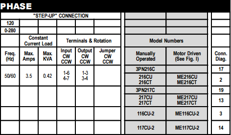

I am a novice at electronics and am wondering if someone here can help me.
I have a Powerstat Variac mode l3PN216C. It is rated for a 240v input. I would like to use it on a standard 110v electrical outlet. It has a 110v cord and plug on it but the outlet is different, the two pins are in the opposite direction. Can I simply shange the outlet for a 110v one and use it or do I need to change something inside? There are 7 Terminals inside and I have ound a link to the diagram here
https://www.danaherspecialtyproducts.com/uploadedFiles/Siteroot/Superior_Electric/Products_and_Solutions/POWERSTAT%C2%AE_Variable_Transformers/INSTR_116C-217C%28213709-063C%29.pdf
Maybe I cant use it and need to get a 110v one but I hoped to get some expert advice before giving up on it.

Yes. Check this link: http://www.danaherspecialtyproducts.com/uploadedFiles/Siteroot/Superior_Electric/Products_and_Solutions/POWERSTAT®_Variable_Transformers/INSTR_116C-217C(213709-063C).pdf
It appears that you can even run it in "step up" mode .

Looking at that chart though, if I am reading it correctly, which I am probably not, it looks like the model I have only has info for running on 240v?
In order to connect my 110v device where would I connect the wires for a 110v outlet? Do I simply take the wires off the outlet that is on it and put them on a 110v outlet? The outlet on the variac has the two pins horizontal instead of vertical.
It is like any power transformer. So long as the voltage is no greater than its specification, and the frequency is likewise within limits, just plug it in. It is not isolated, as others have mentioned. I would still connect the high side of the coil to L1 (black/colored and not green, not white) wire and the bottom (common) to the white or grounded wire, if you are in the USA.
