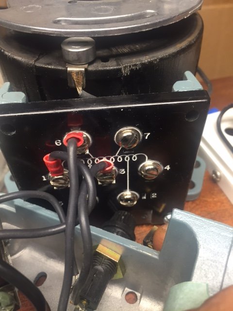

Can I use a 240v input variac on 110vinput?

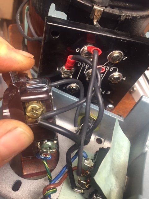

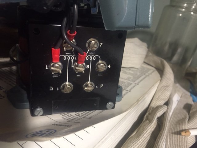

That wiring does not look correct. The mains input should go to connection 2 & 5. I can't quite see from your pic though
CORRECTED To connection 2&5 not 2&6
I'm not sure but I think that the wiring you have is for a 120V input and 240V output. the reason why you had the sparks is because you were feeding 240V into an effective inductor designed for 120V.
I will have a closer examinination of your pics and the manual and get back
No mains is 110v 50/60hz
Sorry to keep on, but before you said, 'oops, sorry I will fill that in, I am in USA and I believe it is 240v 60hz.'
As your mains voltage is crucial to the investigation can you definately say that your supply is 110V
I think I can see what is going on now. Can you say where the wiper was when you plugged in? I'll bet it was at minimum or 0V.
