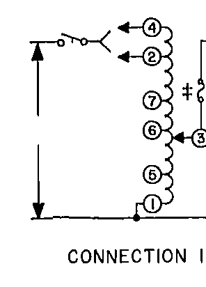

Your input pins should be 1 & 4 with AC Mains Neutral to 1 and AC mains hot to 4. Your output should be 1 & 3 with 1 being neutral (same AC in neutral) and 3 being AC hot and 3 is the wiper. The wiper as mentioned should be fused. John already covered the socket you have with the straight blades that look peculiar. Yes, you can run the 220V Variac on 120 Volts. So 1 & 4 are AC mains in with AC neutral on 1 and 1 & 3 are Output with Output neutral on 1. Just remember that pin 1 is the common neutral.
This is what you have. Connections and ratings page take a look at CONNECTION 1 on the right side of the page. It looks like in your pictures they were using 1 & 6 for input which would be for 120 V input CW Clock Wise (again see connections and ratings section). So as it is it should have worked. Again, here is a link to the PDF, I could not get your link in post 1 to work.

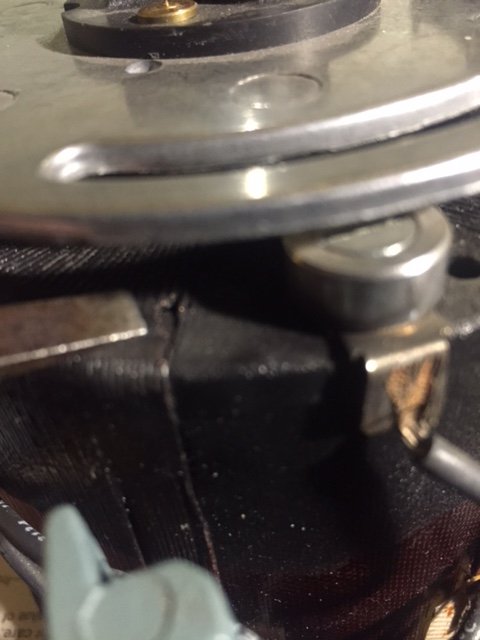

I wired it up as Ron above suggested and I got sparks again from the point right next to the screwdriver tip, it is at the zero point which is where the negative is connected I believe. I don't know if this was here when I bought it or not? I most probably caused it somehow though.
Is there anyway of salvaging this? Can I move the zero point where the negative connects to a copper strand further up?

It would be best if you could repair the terminal 1 connection to the transformer and if it is like the Variacs that I have examined there should be a fairly simple connection to the transformer coil. The mains connection for 110V is terminal 1 (neutral) and terminal 6 (live). This will give a range of 0V to around 285V on the wiper. Thus you will have a usefull device that will operate 220V to 240V equipments if ever required.
When you do the repair to the terminal 1 connection make sure nothing is shorting out in that area. You can connect slightly further up the transformer if necessary, but try and keep the loss of turns to a minimum.
If you could post a pic of the connection as it is now that would be useful. It may just be that the connection clamp to the transformer coil has been loose from new.
If push comes to shove, and the terminal 1 connection cannot be repaired, you could make terminal 4 neutral and terminal 7 live (110V). The Variac would work exactly the same except the dial would work in the opposite direction. (max output on the dial would be minimum output and vice versa)
In your photos it looks like they used terminals 1 & 6 as the inputs. That application does show up in the manual for a 120 Volt input. Looks in your recent pictures like the winding is charred (black) where you are getting sparks. Here is something you can try. Use terminals 4 and 7 as the inputs with terminal 4 being the common neutral terminal. Your outputs will be 4 and 3 terminals. What this will do is change the rotation. Normally rotating the knob clockwise (CW) will increase the output, Now zero out will be in the full CCW and rotating CCW will increase the output. Since you are seeing sparks something is cooked or wrong with the unit.
You can also try using 4 and 5. The idea is to get around the burned part or problem part. The above is what you have. I have a 120 VAC version laying here and somewhere I have a large 240 VAC 20 Amp version laying around.

I have it connected right now with negative at terminal 5 and positive at terminal 4 and it is working well with a test light. I was just a little concerned that something might still be happening at the points before terminal 5 connects and cause sparks or a fire. I think I understand how this works a lot better now but I am cautious to leave it unattended until I understand it and can be sure its safe.
If I don't turn it CCW to a point before where terminal 5 connects I should be safe is that right? I don't need to run it at 0v, the lowest I would need is probably 25v.

That should work as long as you are past or beyond the toasted part. :)
Also, yes, you can repair a variac / autotransformer just make sure you bridge the break using an adequate wire gauge also in the interest of safety use enameled wire or once done place some corona (insulating) dope over the job.
