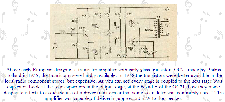

Here is a transistor circuit that is 41 years old. They have it drawn wrong with a positive supply instead of a negative supply.
Yes, drawn it wrong - and even the resistors look strange :D
But OC71's were fine transistors, general purpose PNP audio, bit small for an output transistor though? - later on the OC72 became available, and was capable of more power.
