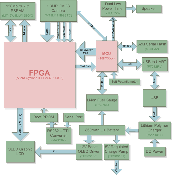

Hey there,
I am designing a handheld device and I was hoping that I could get some comments/critiques on the structure of it from those of you who are more experienced than I am (Which is probably everyone because I am 16 lol). I do not really want to disclose exactly what I will be making, but I think I will be able to give you enough info that you can see how it will be organized.
Here are the major things that will be performed:
1. Every once in a while the FPGA will "take a picture", which consists of receiving all of the image data from the camera and dumping it directly to the psram. When that is done, an edge detection algo will be run on the image, and other relatively easy byte by byte processing will occur.
2. The FPGA will display a simple color gui on a graphic lcd. (Most likely I will just take a different bitmap from ram an put it on the lcd and then just write text and a scroll bar on top of it)
3. When plugged into the computer, the device will either show up as a mass storage device or as serial port for my application to do stuff with it. I am not quite sure what I am going to do with this usb feature, but I want to have it because I know there will be a use for it later.
Do you think I will be overstressing the FPGA too much?
I attached a diagram I made that will hopefully clarify things a bit. I know there are still a lot of unknowns (like clock speed, etc...) but I kind of thought I would try to keep the initial description to a minimum :). Let me know what questions you have ;)
Thanks!
ps: I am not quite sure on the density of ram I am going to use, but I am thinking 4-16megabytes or PSRAM(aka cellularram)from Micron.
Sidestepping the whole "would probably be easier to do this on a PDA" issue -
The last time I stuck a x16 SRAM on a 144 pin FPGA, it ended up using up a very large chunk of the IO lines - 16 data + 21address + 4-5 control lines, that by itself is ~50% of the IO.
The PSRAM parts are BGA only which is an interesting exercise in solder reflow.
SRAM based FPGAs have very large quiescent currents. They'll eat up ~100mW or so just sitting there.
UI's are much, much easier to do in a large, well-padded microcontroller. You'll need a decent amount of space to store any text/graphics.
James

freeskier89 said:
Yeah it would be a lot easier to do on a PDA, but for what I am doing, it would look a lot better if I designed the thing from scratch, and not to mention, I learn a lot more by designing it :).
Fair enough.
freeskier89 said:
About the SRAM/ I/O issue, I am going to be extremely tight on I/O. I have 65 to work with, and at the moment it looks like I will be using 65 :S. Potentially, I could hook up the data or address lines to a PISO Shift Register, but I that would make things more complicated, and would decrease performance considerably. Any thoughts? At the moment it looks like I will be fine on I/O, but as I come closer to actually drawing the schematics I am sure I will need more :(.I might have to hook up my status leds and such to the I2C bus lol, wouldnt that be fun. Here is the breakdown for what is using the I/O at the moment:
Well, I'd recommend that you switch to a 8 bit bus for the PSRAM - unless you really think you need the bandwidth. Or add some address latches on the high order memory bits(i.e. the ones you don't need to change often). Alternatively use a DRAM chip and just deal with the added memory controller complexity, but with only half the address lines.
freeskier89 said:
I too was concerned about the BGA soldering. Luckily with a bit of research, it looks like it isn't too daunting of a task using a hot plate and a professionally made pcb. I doubt it will be painless though. I think soldering the iCSP44 package for the camera will be a bit more difficult yet because I believe they have much tighter temperature tolerances.
Well, there are CMOS sensors which have LCC style edge pinouts instead of BGA's. Those are easier to solder by hand.
freeskier89 said:
I was planning on loading the font for the graphic LCD from the SD card to the RAM upon start up. The FPGA could then grab each character from the RAM when it needs it. I will probably use a simple, non-antialiased, 5x7 bit font to keep it simple. The graphics will be stored and used similarly.
The whole GUI is going to be very minimalistic and will be nowhere near the complexity of a cell phone. Pretty much it will probably incorporate a startup screen, and a page showing the preview from the camera(not mandatory), along with a few dynamic textfields. Thats about it.
I would like to stay away from a MCU other than a PIC if at all possible, mainly because I do not really want to spend more money on a new programmer and the like. What exactly makes UIs easier to do on MCUs?
Well, having a font 'bootloader' makes things that much more complex, plus trying to hit the RAM (which might be in the middle of an image operation) to update the display means having a pretty complex state machine setup along with the required addressing/oddball multipart DMA setup... Have you tried coding the HDL that would do this yet, because it'll be an insane PITA. (BTW, it would probably be a better idea to hardcode the font into the FPGA's SRAM blocks, but it would still be pretty painful, and I can imagine the logic to do this taking a good 30% of the FPGA to implement).
Generally one has a uC in the system to handle all the stuff that happens at "user" speed - UI controls (getting a FPGA which is running at MHz speeds to deal with sub Hz user interactions means a lot of large delays/counters), display updates (having 10's of lines of C code or 100's of lines of assembly is much less painful than trying to debug a FPGA). As well as things that a FPGA is just bad at - "allocating" space in the SRAM for image buffers, initialization command sequences for the flash/sensor, or just doing more complex actions - storing multiple images in multiple buffers at different resolutions at different times, clipping subregions, formatting the images on the SD card with the correct image headers, etc.

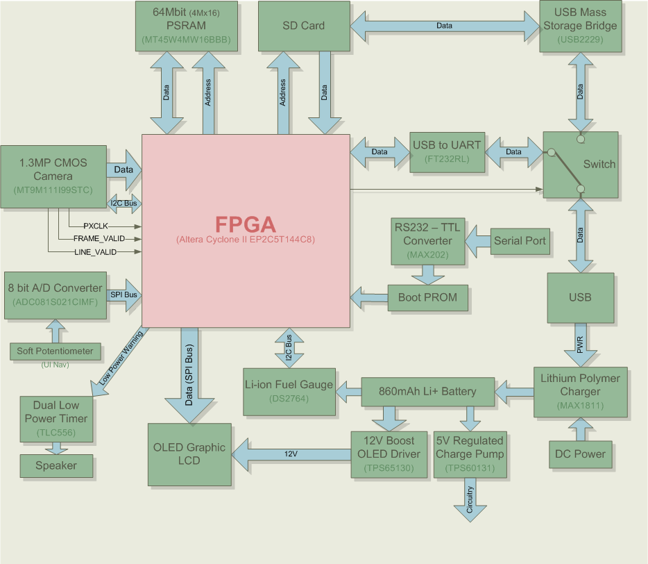

The LCD I will be using actually does have the option of becoming a parallel display, but I wanted to use SPI to save I/O. This is the structure I was thinking of using for displaying stuff on the LCD:
When the system starts up, the FPGA would request to get the background image from the flash memory connected to the PIC. The PIC would then stream the data back to the FPGA, which would then put the image in RAM (or in the FPGAs internal memory if possible).
Every so often, the FPGA will send a string of characters serially to a PIC (or parallel if I have space on the pic/fpga). The PIC would then generate an overlay monochrome bitmap with the text and data from the fuel gauge using a simple pixel font on the PIC. When done generating the overlay bitmap, it would send it back to the FPGA to be displayed.
20 or so times each second, the FPGA would pull the background out of ram (or the fpga if possible) and it would take the preview data stream from the camera and put that on top of the background. Then it would put the overlay bitmap from the RAM(put there by the PIC) on top of it.
Does this sound a bit better?
I attached a new diagram with the MCU implemented.
Thanks!
Brandon
The display description looks doable.
BTW, you have 5V supply scribbled down there - I'm assuming that you've got the other power supplies budgeted out as well? Nearly all parts require 3V power, and Lithium batteries have an annoying habit of droping below 3V when they're ~70% discharged - thus needing a buck-boost converter - or alternatively set make the main logic power supply run below the Lithium cutoff voltage.
So have you figured out how you're going to build this thing? A 4 layer PCB is the utter minimum required, and laying out a board like this would take me a week and some (and toss in a couple days to get the full schematic built up).
James

7) When I design the actual board, wouldn't it be best to have one inner layer dedicated to ground, and the other 3 layers be used for traces?
8) I intentionally do not have VCC connected on the FPGA... I need to check into the requirements for that first.
Have a great thanksgiving!
-Brandon
  • Schematic.pdf
From the block diagram of the system you are using two buses I2C for the camera and the Fuel gauge and the SPI bus for the ADC and the LCD. I suggest using ADC and LCD with I2C bus instead of the SPI bus. This will minimize the number of pins and the software of the FPGA
