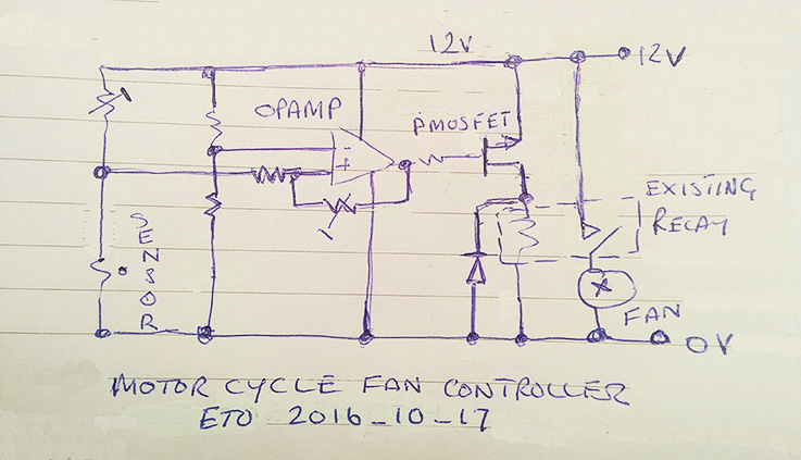

To give you an idea of what the circuit involves, below is a sketch (not the final circuit). Would you be able to build a circuit like this?
spec
I can do it if I get the values
Excellent that you can make the circuit. I will post a proper schematic for the fan controller, with all the component values
Thanks for the information about the temperature setting for the fan to operate. The circuit will have two variable resistors. One variable resistor will set the fan on temperature (top left on the sketch) and one variable resistor will set the off temperature. So you can set the two temperatures how you like. I will design the circuit to use a new relay

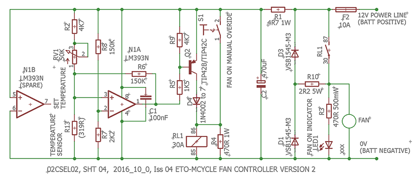

Hi pradoartz,
Below is a schematic of the proposed motorcycle fan controller (MFC).
ERRATA
(1) Please note the following changes:
(1.1) Relay coil snubbing (thanks Diver300)
(1.2) Relay contacts snubbing (thanks Diver300)
(1.3) 470 Ohm, 1 Watt minimum resistor added to circuit
(1.4) 2.2 Ohm, 5 Watt minimum, resistor added to circuit
(2) Change '1N4002 thru 1N4007' to '1N4007'
(3) Change 'TIP42B or TIP42C' to 'TIP42C'
(4) Change LM393 to LM2903 (better temperature range)
NOTES
(1) The LM2903 dual comparator is available in a DIL8 plastic package, so construction will be easier than for a surface-mount package
(2) Special care must be taken to ensure that the MFC is not heated by the motorcycle engine. The surface temperature of the MFC should not be over 80 Deg C
(3) Special care must be taken to ensure that the MFC does not get wet. Even dampness and condensation will adversely affect the MFC operation
(4) The LM2903 comprises two comparators in one case. Only one comparator is used, but the other comparator must be connected as shown on the schematic.
(5) RV1 sets the fan turn-on temperature.
(6) R6 defines the hysteresis of the Schmidt trigger (N1A). With the value shown the hysteresis will be 5 Deg C. Thus, if the fan turn-on temperature were set to 80 deg C, the fan would turn on at 80 Deg C and would not turn off until the water temperature had dropped to 75 Deg C.
(7) When the relay is not energized (and the fan is off) the circuit only consumes around 1.7 mA, so the MFC can be left connected to the battery when the motorcycle alternator is not charging. Note that it is better for your motorcycle for the fan to be operational when the engine stops and the motorcycle is stationary because the water or oil still need to be cooled. Once the liquid is 5 Deg C delow the fan-on temperature the MCFC will turn the fan off.
(8) Wire must be high temperature automotive grade.

You are a GENIUS bro.

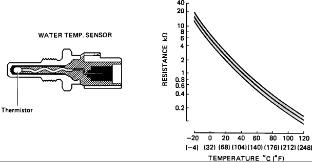

R13 is the variable resistor right? I mean R13 is the coolant temperature sensor ?
If so, Resistance from the r13 varies from 1.3K ohm(engine is cool ~ 25°C) to 0.1k ohm(engine is too hot ~ 110°C). So the schematic you designed will kick the relay exactly by 80°C (~0.3k ohm) right?
For your reference.
Thanks for the schematic bro
No probs- I hope the circuit works OK
... R13 is the coolant temperature sensor ?
Yes that is exactly right: R13 is the temperature sensor.
You can set the fan turn-on-point to whatever temperature you like, including 80 Deg C, by adjusting the potentiometer (RV1). Note that at 80 Deg C the nominal value of the temperature sensor is 319 Ohms, as indicated in brackets on the post #26 schematic.
Don't worry, I based the design, of the circuit in post #26, on the characteristics of the temperature sensor that were in your original post.

Thank you bro, now i am collecting the required component one by one. Here in Chennai i am not able to get all the components. so i ordered online for a few components. Will definitely post you an update after i done assembling the circuit.
Hi pradoartz,
No sweat.:)
The circuit is pretty straight-forward and uses freely available low-cost components and well-established design techniques.
Hopefully, it should be fairly robust too.
Yes, do let us know how the circuit turns out. Also a picture of the circuit and your bike would be interesting.:cool:
spec
Hi pradoartz,
No sweat.:)
The circuit is pretty straight forward and uses freely available low-cost components and well-established design techniques.
spec
Have you tested this circuit in any schematic simulator software?
How you guys have so much brain, like you are developing a professional schematic in no time. You are awesome bro.
What do you do? Are you an electrical & electronic engineer ?
and
About the pictures they are coming as soon as i assembled
No- I do not use simulators except for complex logic circuits. I analyzed the circuit and made the necessary calculations.
Thanks- I am blushing. Once you know the techniques, designing a circuit like that is reasonably simple. Things always seem clever for people in fields you are not conversant with. To me a plasterer is awesome, or a painter, or a musician.
Yes- electronics design engineer for years but, apart from consultancy, retired.
Look forward to seeing the pictures. Some of us on ETO are motorcycle nuts.:)
